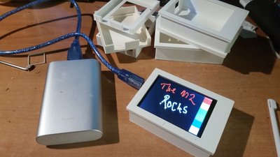

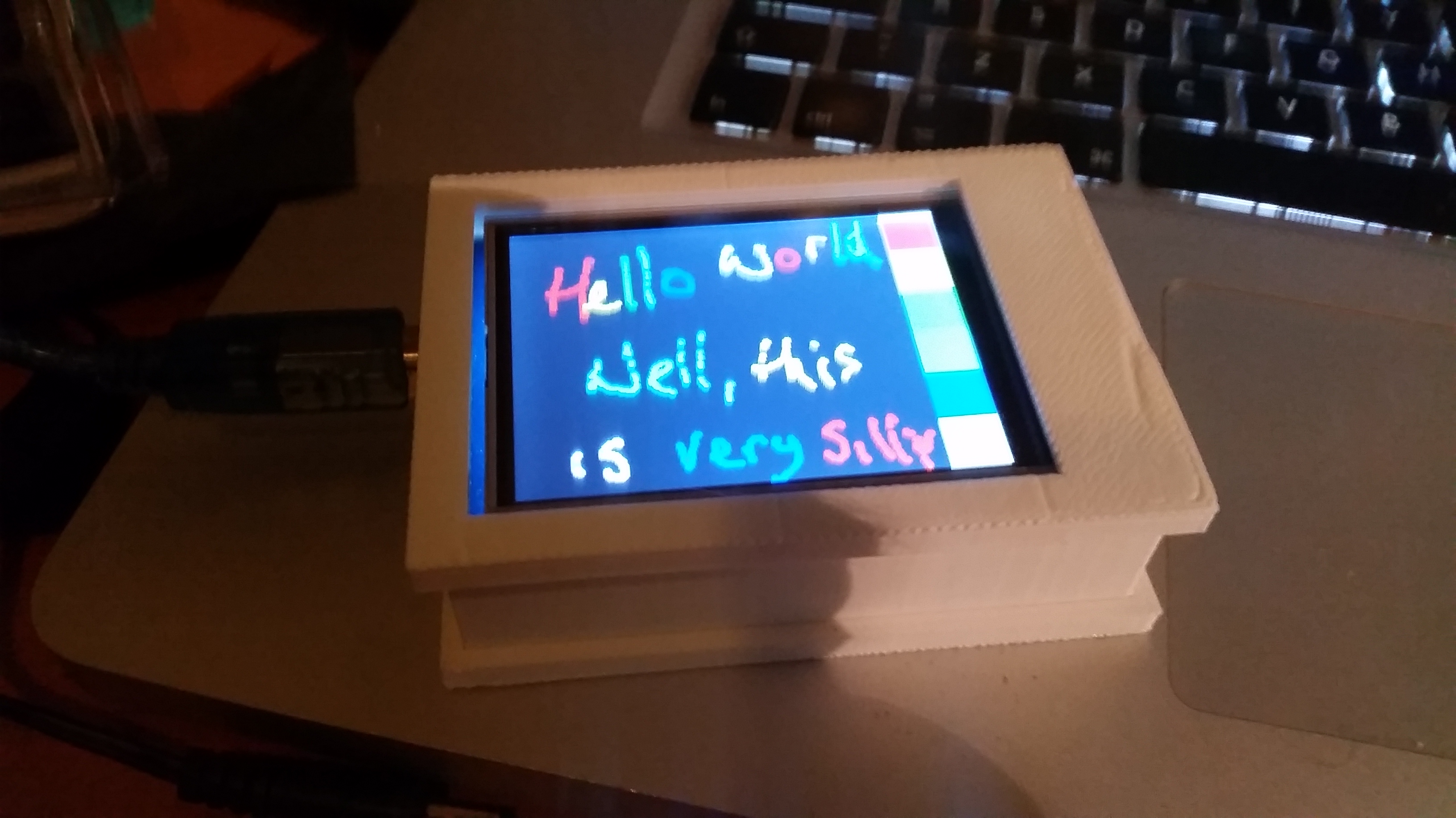

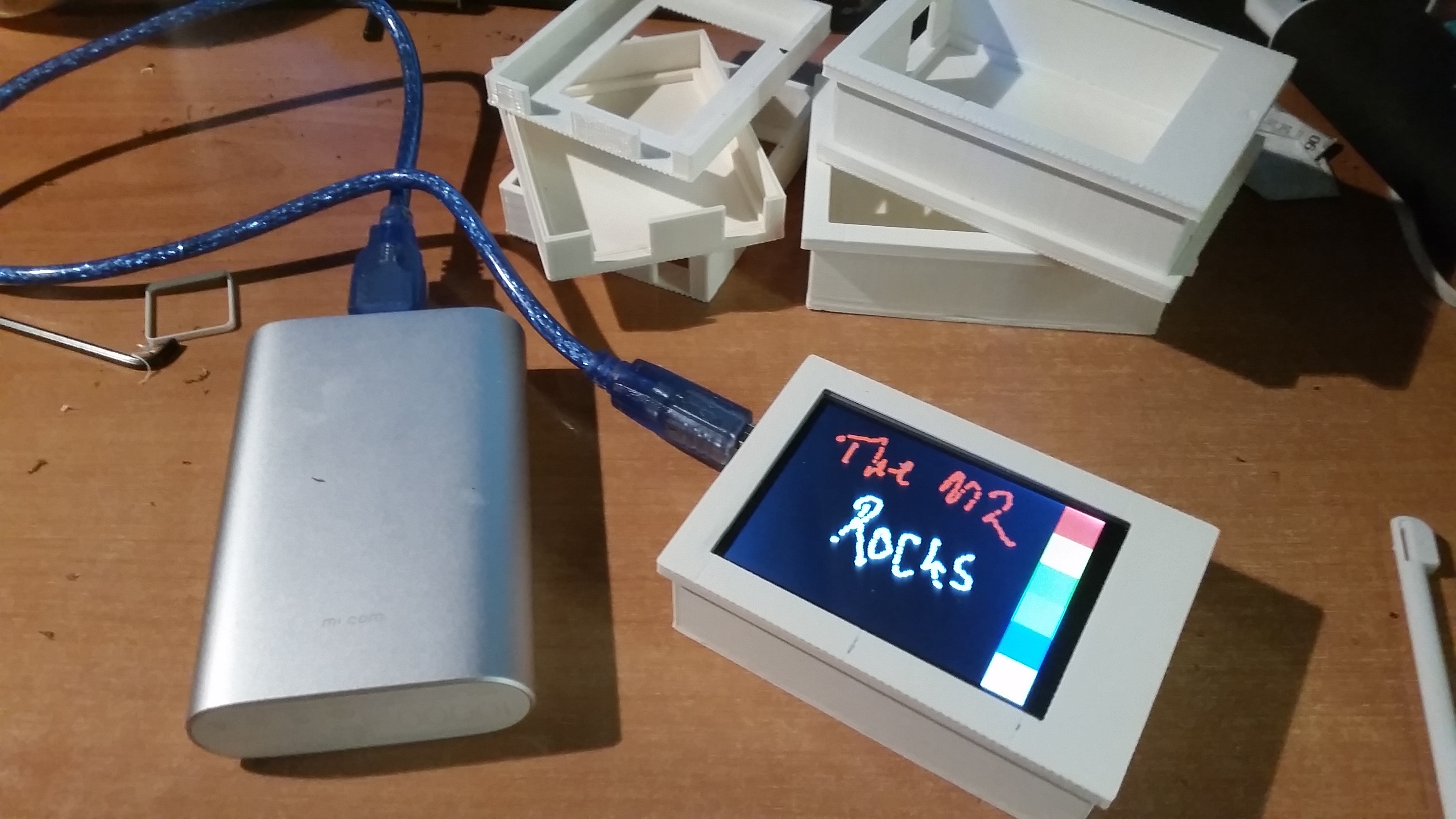

For anyone interested, an untuned prototype of the customisation tool is available here:
http://openjscad.org/#http://www.gemini ... uino.jscad
I think it's a tad more interesting than trying to deal with my monkey at the controls approach to printing :), but I will return to tuning properly when I have more time.
This was a very, very early prototype. Things have got a lot slicker since then :).
Will open another thread to discuss it in more detail, as it's kinda fun... and may even be useful. Currently more like:
