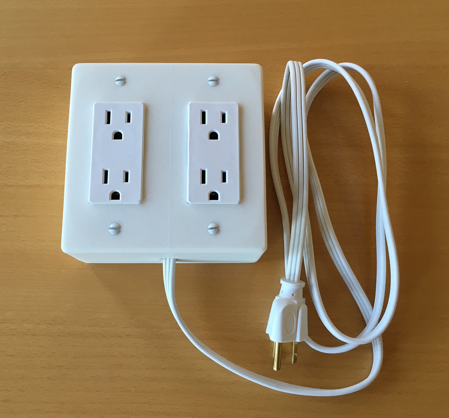

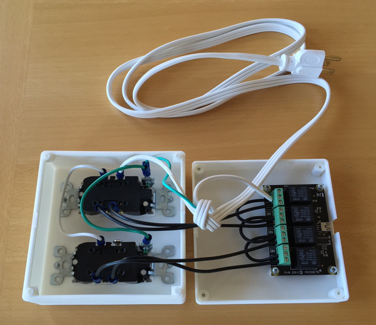

I used MakerBot True White PLA for this print with the same S3D settings I use for the MakerGear black PLA. Even though I'm not particularly concerned about aesthetics on this print, the box looks really nice. Each outlet is powered through an independent 250V/10A relay, controlled via USB.

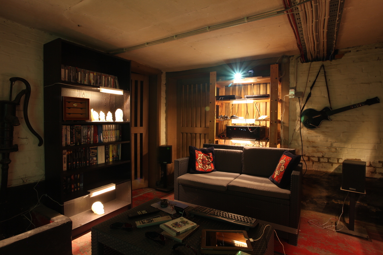

The room in question kinda looks like this:
and it's the lights (Ikea Dioders) which are obscured by the white paper which I would like to have more control over.
Also need to replace the white paper with some 3D printed thing
- they're there to keep the light from the shelves bleeding on to the projector screen, but don't do a great job.

For this application I needed something different though. My house in Southern California is subject to occasional power and/or internet disruptions. Most of the time my router and modem reboot properly and reconnect to the internet, but sometimes one or the other needs to be manually power cycled. Easy enough to do when I'm physically present, not easy to do when I'm away (which is fairly frequently). So what I needed was a number of normally closed relays that could be accessed remotely to power cycle the router, modem, WiFi node (which sometimes crashes and needs to be power cycled too).
I'm a big fan of the Raspberry Pi, and I have a number of them performing multiple duties... I decided not to mount the Pi inside the outlet box so it would be accessible to perform other duties. The relay is a Phidgets 1014_2. I also use a Pi as an answering machine... through the answering machine, I can dial in remotely and enter a code that will power cycle any of the four outlets for a specified number of seconds. I'm also working on a program for the Pi that will check internet connectivity on a regular basis, and if it is down for more than a certain period of time will power cycle the router and modem automatically.

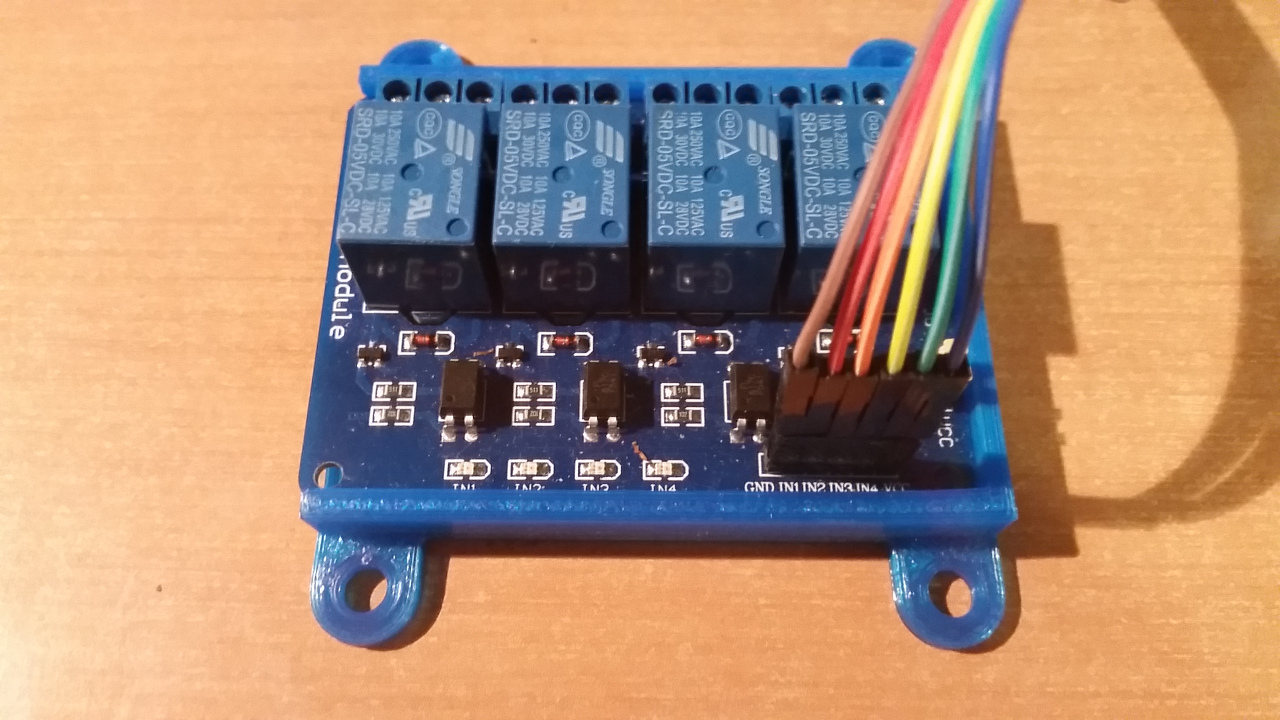

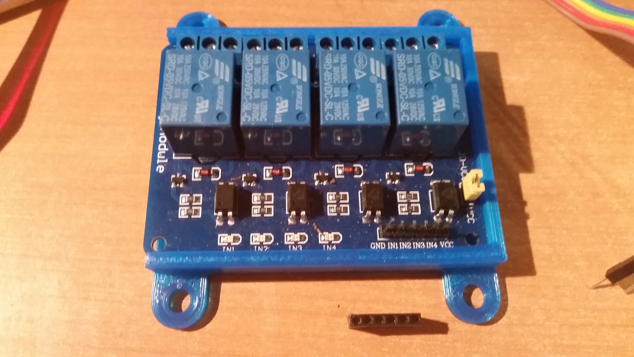

Looks to me like this should work quite well. I created a small connector for the pins like:
Wired up, it provides a surprisingly robust connection - I can comfortably pick it up by the wires without them falling out or losing connection with the pins:
Model attached in case anyone is interested.
