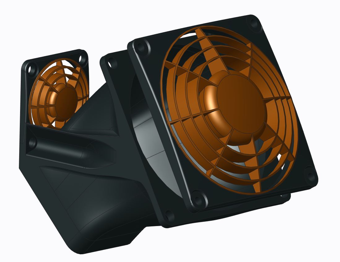

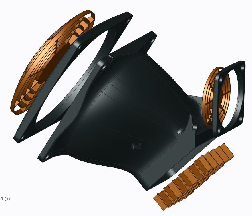

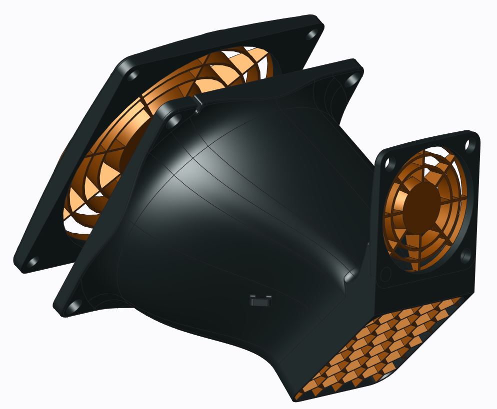

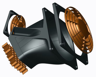

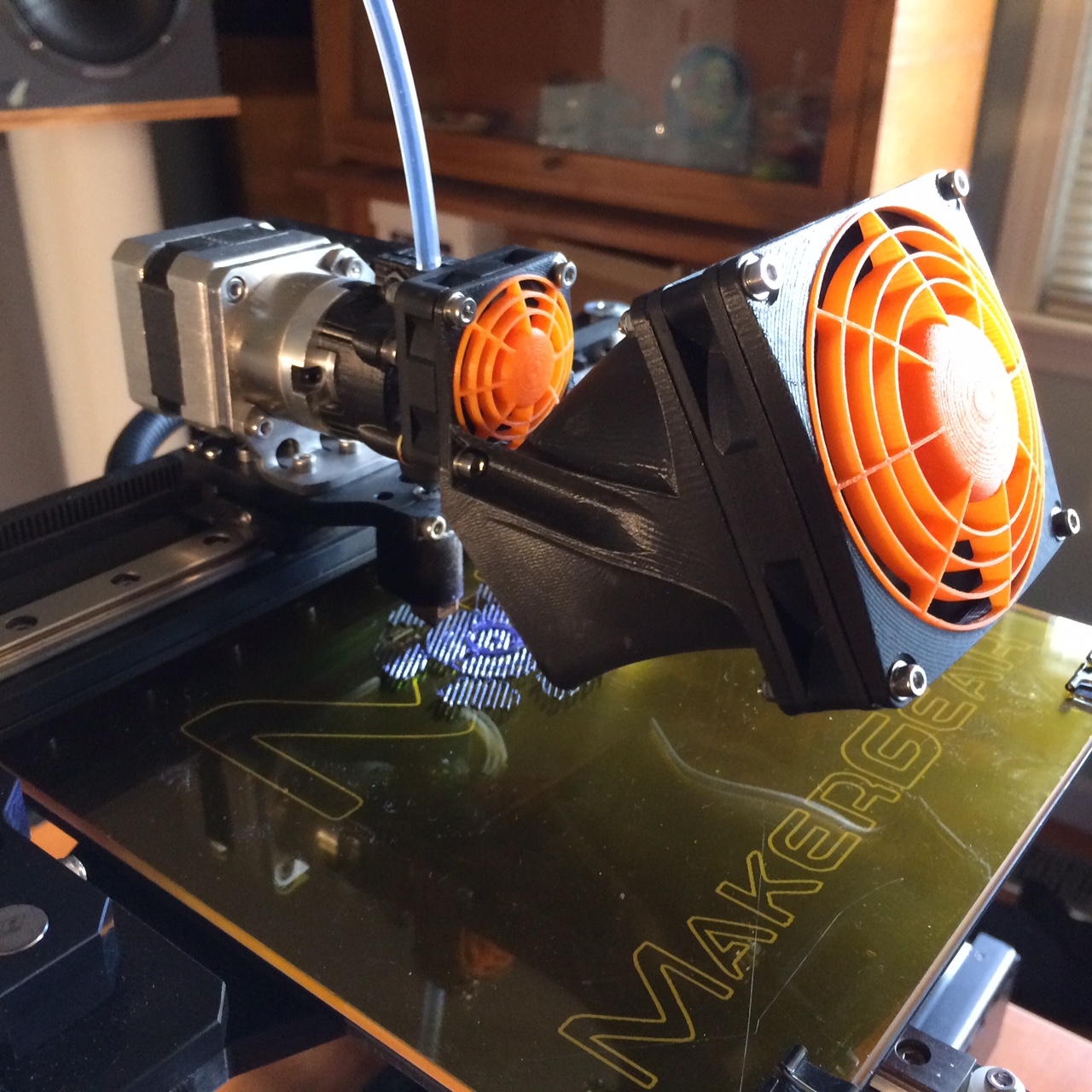

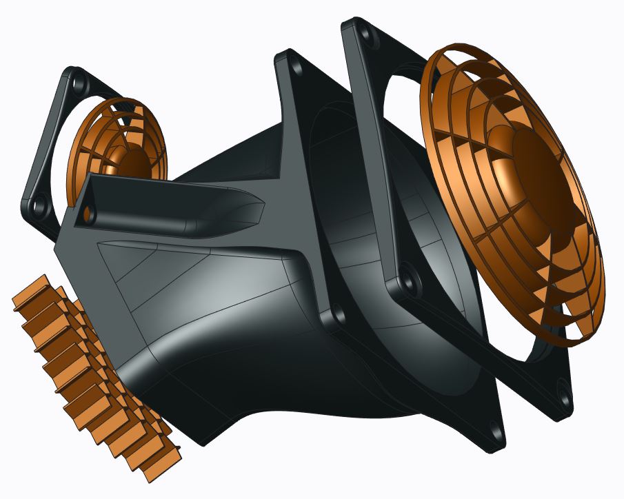

https://grabcad.com/library/makergear-m ... and-duct-1
The duct builds with the 80mm flange on the table. I made everything in PLA with .1mm layers.

Jules wrote:Nice! That oughta cool it down! :D
It does, but my main goal was to run the fan slower for less noise.

Post by jsc » Sat Apr 02, 2016 10:15 pm
Nice model. The problem is, it turns out high CFM 80mm fans rely on moving a large volume of air at low pressure to get that CFM, which is the opposite of what you want in a ducted fan.

Post by zemlin » Sat Apr 02, 2016 10:28 pm
jsc wrote:Nice model. The problem is, it turns out high CFM 80mm fans rely on moving a large volume of air at low pressure to get that CFM, which is the opposite of what you want in a ducted fan.
As I said above, my main goal was to maintain cooling with a lower RPM fan - not to increase CFM.

Post by pyronaught » Tue Apr 05, 2016 11:11 pm
Love the color scheme. What CAD program are you using?

Post by zemlin » Wed Apr 06, 2016 5:43 pm
I use PTC Creo (aka Pro/ENGINEER) via the day job.
