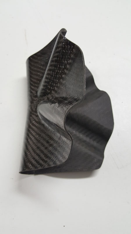

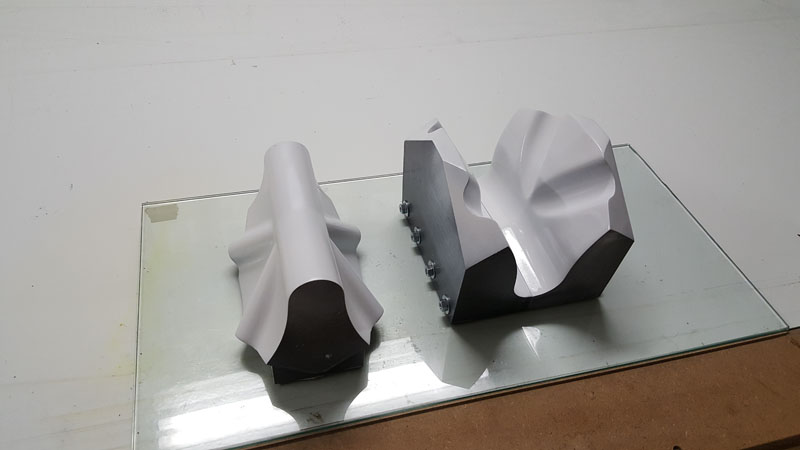

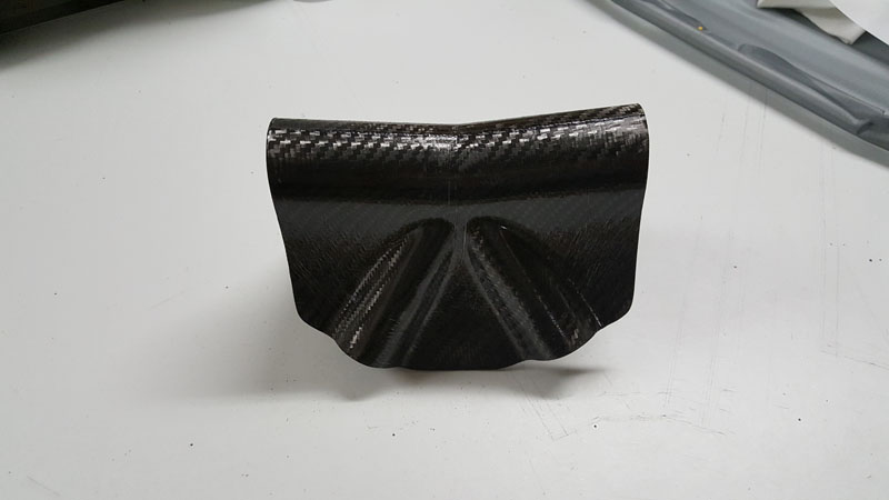

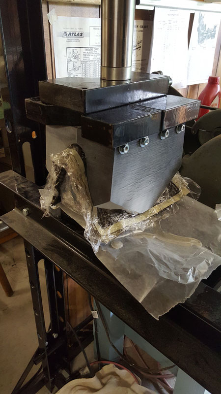

Let me just say I have new respect for PLA. The mold set below was printed in MakerGear black PLA with 80% infill. They are hollow inside with a 1/2" wall thickness. I am using them to press 10 sheets of carbon fiber in a hydraulic press down to a 3mm wall thickness with a fiber to resin ratio of about 65/35. These parts are holding up to a whopping 9000 pounds of compression force without cracking! I'm real curious what the limit is before they crack, but don't want to ruin a mold to find out. It takes three printers a full 24 hours to make a mold set, then there's several hours of sanding involved on top of that. The molded part tuns out great though, and is super strong. I tried to vacuum bag the same part for comparison and it didn't even come close to the quality of the compression molded part, and vacuum bagging is a bigger pain to prep and extract the part from afterwards. The part just pops right out of the compression mold with minimal waste materials (no perf sheet or breather cloth required and all excess epoxy can easily leave the part). So here's yet another cool thing you can do with a 3D printer!

thats great. what kind of epoxy are you using for the lamination? also what are you using for a release agent? wax, frecoat, liner? looks like i see a plastic release liner there and also some wax paper or something?

I'm using lamination epoxy, I can look up the company name if you are interested. Since these parts are not for show and are just for joint structures, I'm using a plastic liner for the release agent. The wax paper is just to catch the epoxy that is squeezed out of the mold so that it doesn't drip all over everything. I do wax the molds just in case something gets through, but thin stretch tape of the kind used for wrapping palettes of boxes works really well for release. The molds are a lot of time and effort to make so I don't want to risk screwing one up from something sticking to it. With the entire male mold wrapped in the film I never have to worry about epoxy touching it and it just pops right out of the mold with zero effort after curing. I just roll a couple of turns onto the male mold, then put a sheet of peel-ply over it in order to texture the inside of the part since it will be getting glued to another similar half that fits inside and sandwiches carbon fiber tubes in place. After the layup I put a couple more layers of the film over that so that the outside is glossy. There are still tiny wrinkles, but they are pretty small and nobody will ever see these anyway. These gussets are super stiff yet still light at around 150g. This is the best results I've ever had working with carbon fiber.

I see a lot of guys doing vacuum bagging over PLA molds for making RC parts, but never came across anyone doing compression molding. The nice thing about compression molding is you can really put one hell of a lot of force on the layers to squeeze them together. I have a mold set I could not use because they changed the part after I had already printed the molds for it, so I used them to do a crush test to see how much the PLA could take. This was just standard PLA with a 12mm wall, no PLA+, Raptor PLA or anything fancy. I went as high as 10 tons on the gauge, which is 1800 lbs pushing the two parts together and they STILL didn't break. The only damage was the press plate on the bottom started crushing an indentation in the bottom mold since the mold was slightly larger than the plate. Even that damage would not occur if the plate was bigger than the mold that is sitting on it. I think the part that would eventually fail would be the side walls of the female mold. There should be a point where they just buckle, but it is so far beyond the working pressure that I don't have to worry about ever hitting that point.

You can control how much epoxy you squeeze out by how much pressure you use. So if you measure the weight of the carbon fiber in the part and then weigh the finished part, you can figure out your fiber to resin ratio and adjust the pressure to make it what you want it to be. A hydraulic press ram holds its position, so it wont keep extending as the contents compress the way an air ram would.
