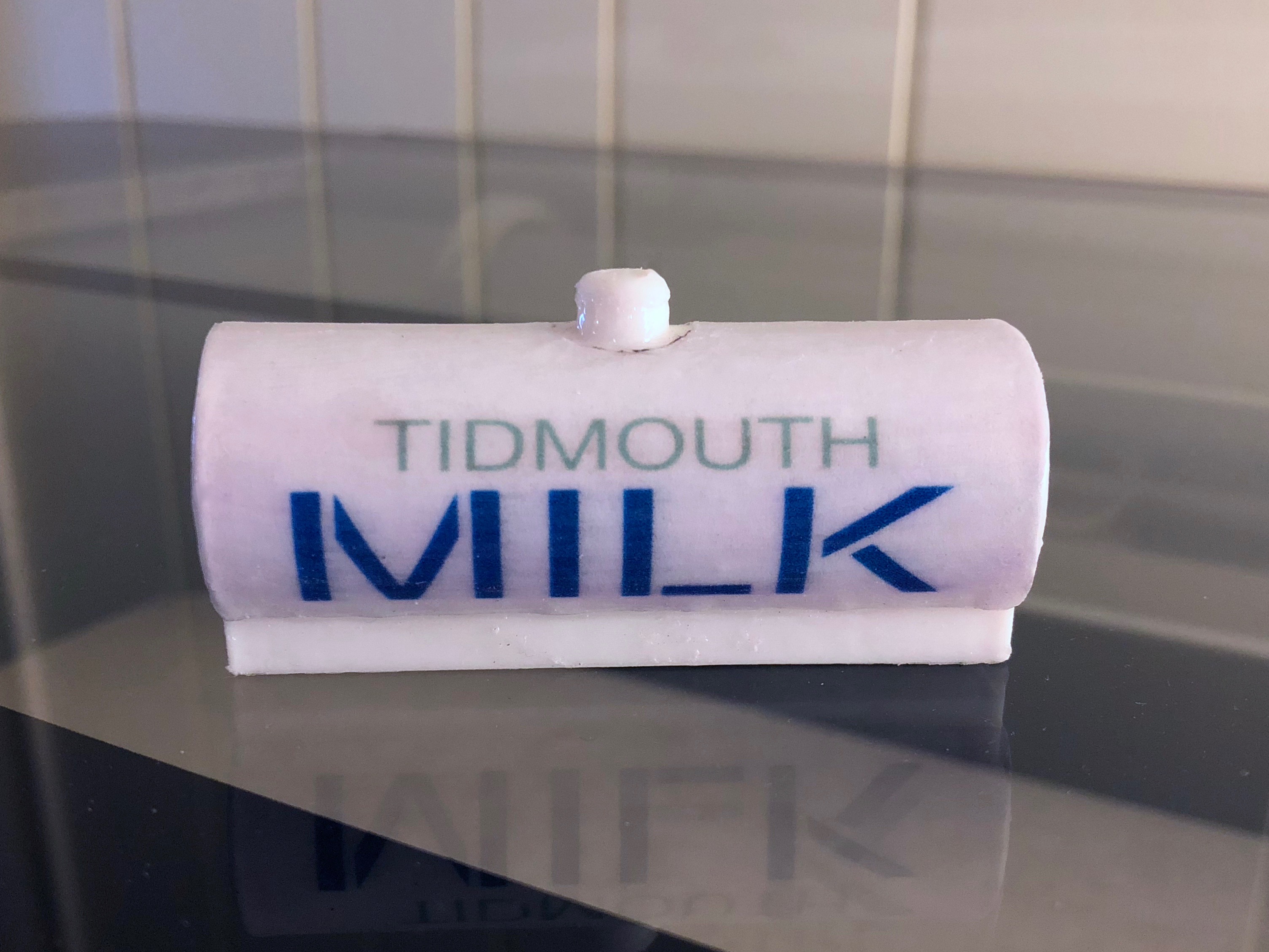

Trying out a new-to-me technique for getting graphics on a print. Printed out the graphic on an inkjet printer sized to the circumference length of the curved section with an oversized center cutout for the dome. I should have taken a little more care making sure to cut out all of the line marking the hole, and maybe waited a little longer for the ink to dry before slathering on mod podge, but overall it worked pretty well, would try again.

looks great!
