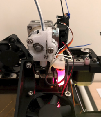

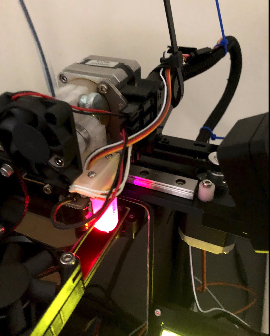

I upgraded my M3 ID rev. 0 with the Makergear BLtouch upgrade and had the mounting plate left over. After using the BLtouch on the ID I decided I had to have it for the M2. So using the leftover plate, I mod'ed the M2 to include the BLtouch and the other parts that Makergear provides with the M3. I found it easier to use the Marlin 1.1.9 firmware than the original firmware to get the BLtouch to work. So far it works really well.
https://www.thingiverse.com/thing:3254205
I had a V4 dual extruder, and the 4 point spider upgrade on the M2. I dropped the dual option since I have the M3 ID now.

Very nice. i'm running bltouch as well and 1.1.9 Still working on getting the zoffset good . so the mounting plate from M3 ID rev. 0 works fine on M2? Need to see if I can buy it from makergear
Can you post your part cooling fan shroud that you used with 40mm fan? also It looks like your connector mount is flipped. Was that done on purpose?

I'm not sure about the connector mount being flipped, most likely it was just ignorance as to how it should look :). I believe that the Digipot_motor_current sets the current available to the stepper motors. There were only a couple of changes I could find in that file, and that was one of them.

Hi Tom. I followed this video https://www.youtube.com/watch?v=y_1Kg45APko and it seemed to work. My offset with another mount is z-2.12 for now but i need to increase it as first layer is still not that good.
what was the size of the feeler gauge you used?
reason why i asked if it was flipped is because this is how my original filament drive looks like
and my electronics mount is on the right side, yours is on the left

I understand now, I ended up modeling things based on the layout of the M3 ID. The wiring looms are on the opposite side. I don't think it matters with the single extruder. I used a .15mm shim. It didn't get it to where I wanted it exactly. I don't have a machinist's feel for when things are right. Once I got it close, I just increased the z-offset by .05 mm until it looked good.
