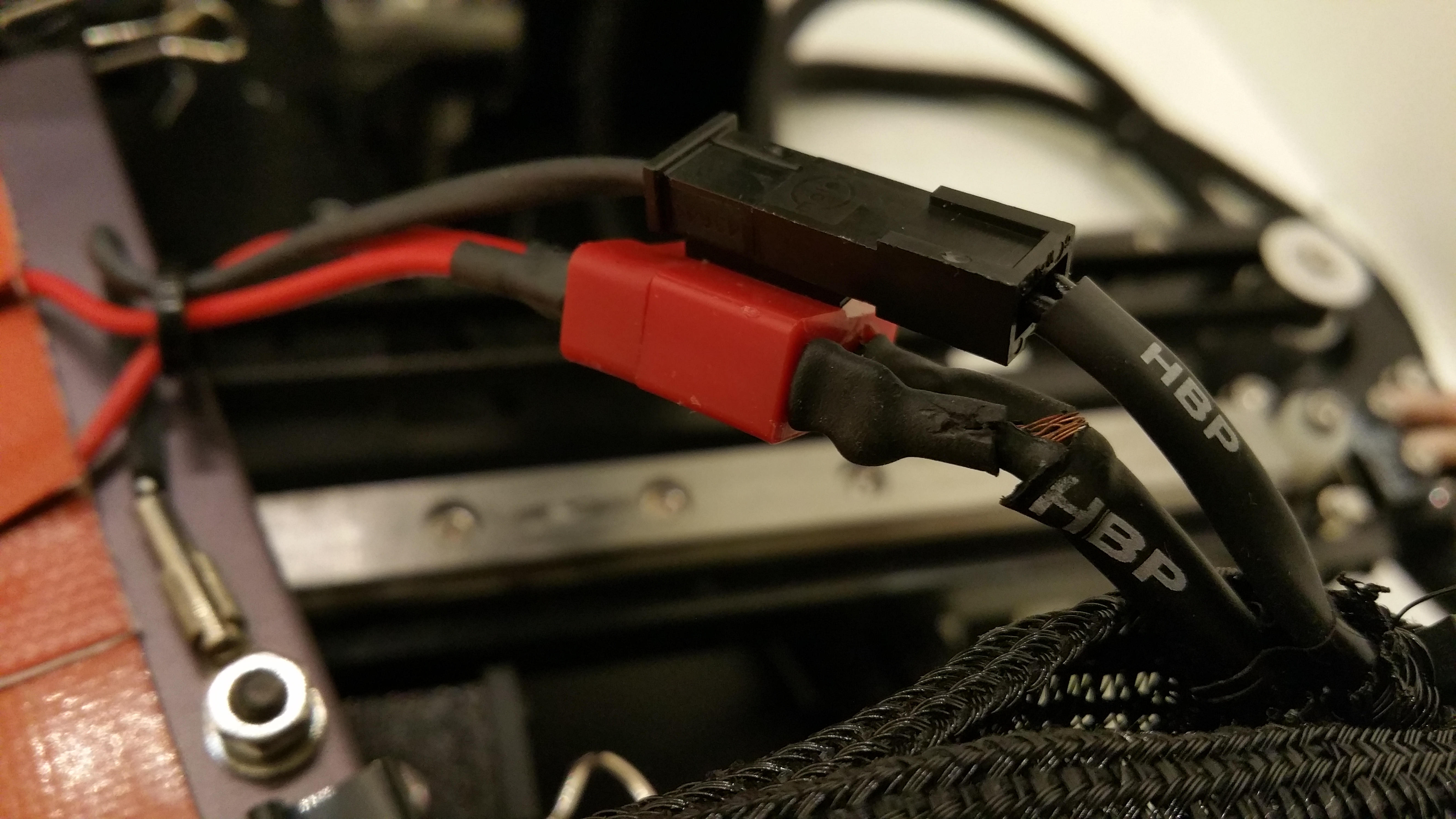

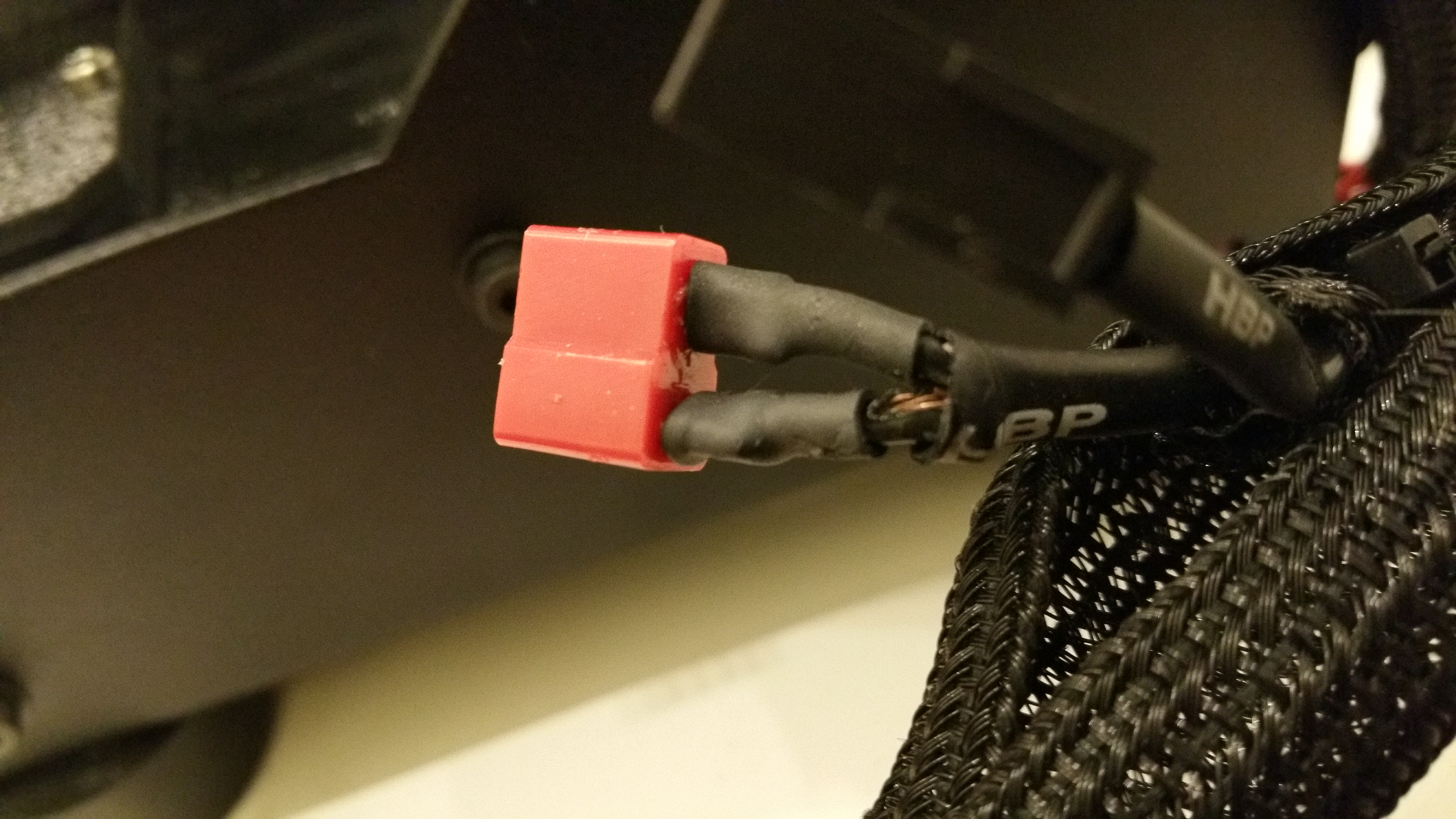

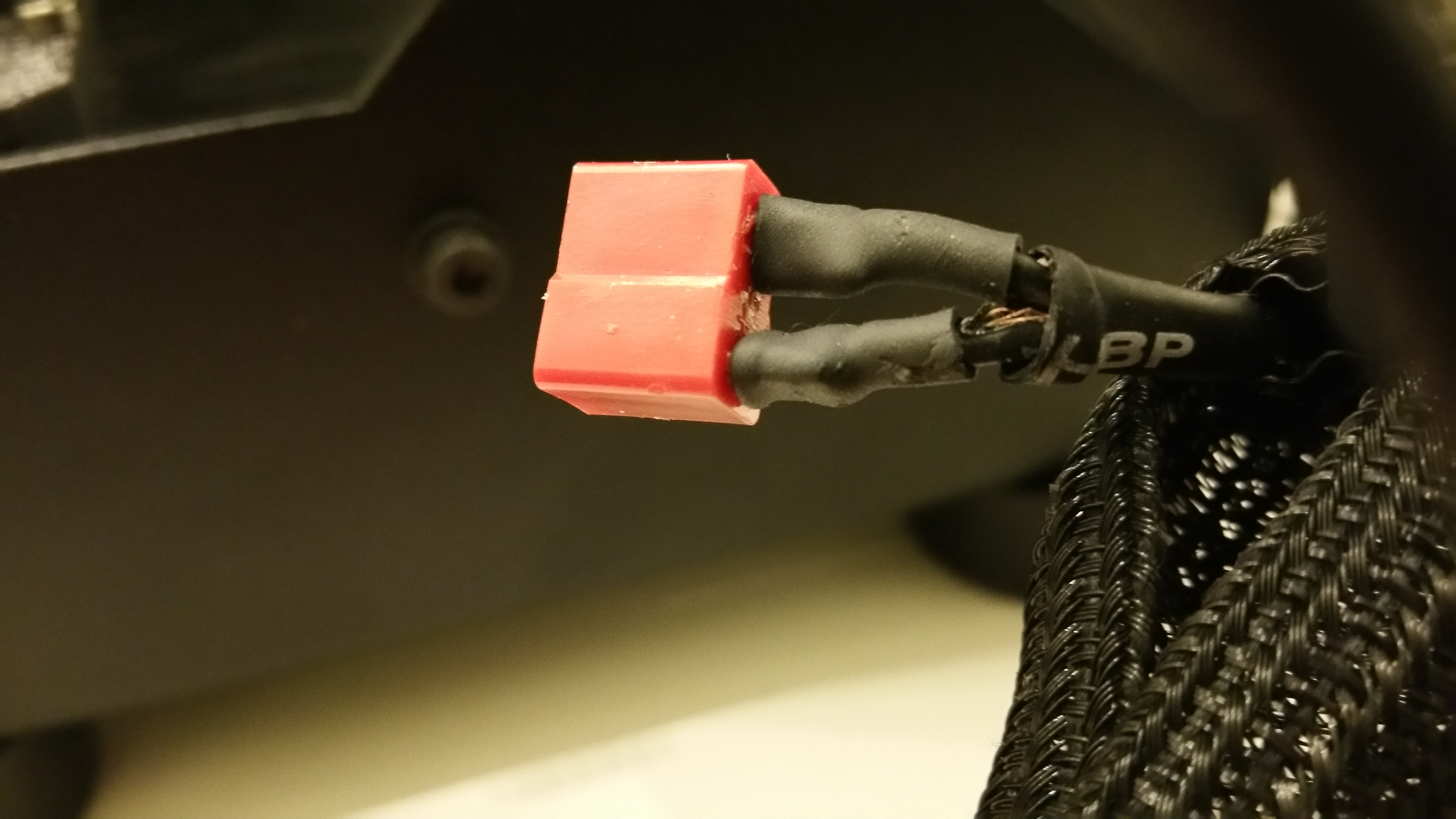

Wanted to know if anyone had this issue with the HBP connection. So far it frayed the wire at the connection (y connection). Is there a reliable fix this this? Or can Makergear replace the wire or something? It is not under warranty as it is past 6 months.
Figured I would post this because it is a potential issue in design possibly.

you can get a new hbp harness from makergear. that is from repeated flexing in that area. your wires going to the bed need to make nice even sweeping motions. all the bend cant be concentrated in one location. you need to reroute everything and tywrap the wires so they dont flex in one area.

I didn't see that as order able on the page. Is that something special I have to contact them for?

yes all the parts arent avail from their website. you just need to send an email. they have everything.
Re: HBP Wire Connection Fray
Dang this is an epidemic. All the 12v machines hitting some EOL?
