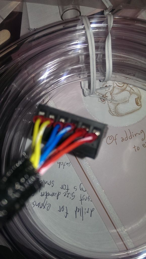

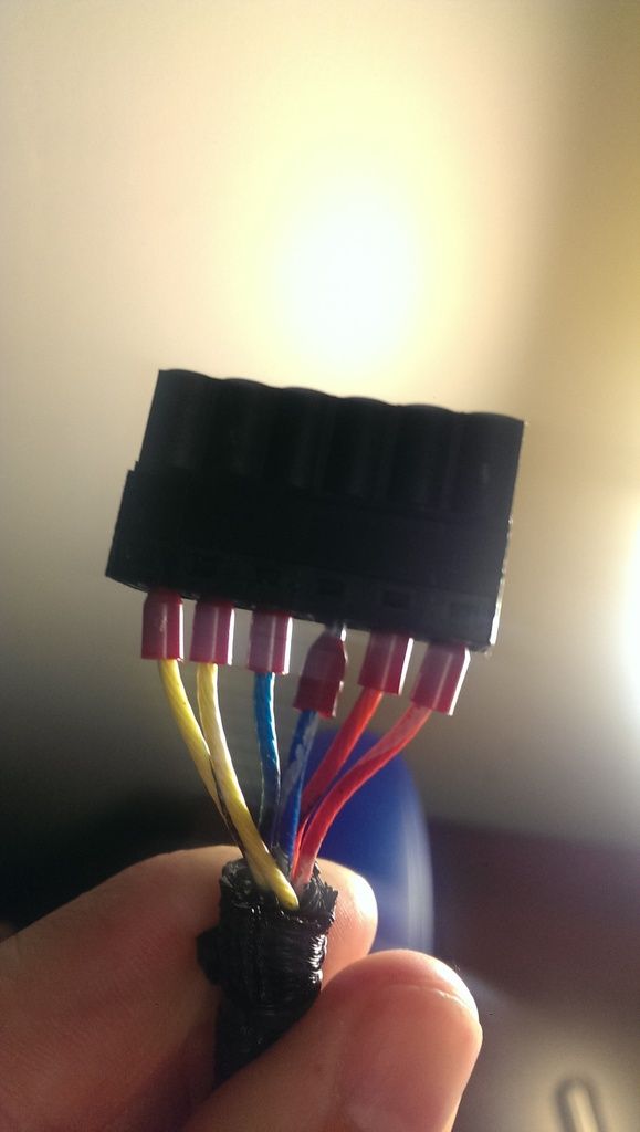

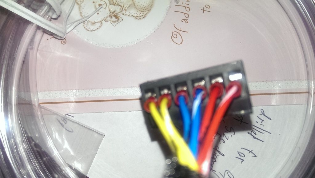

Solved because of your suggestions (Warning, large pictures)- One of the individual wires of the power cord terminal was not secured. I gave a little tug to each individual power wire and one of them popped out.
I scraped off the glue and, screwed the the flathead screw down, securing the wire. I fired up the printer, and it started with no problem. I moved the wire around slightly to see if the problem would repeat, and it did not. I took some pics before and after, though my camera stinks.

Re: Power connection issues on new printer - Solved
Eric - first, I am sorry that you experienced this problem.
We recently started having this part made/assembled by the wiring house that does most of the wiring harness. We are forwarding the photo so that we can get a process in place to prevent this from re-occurring.
Thank you,
Rick
