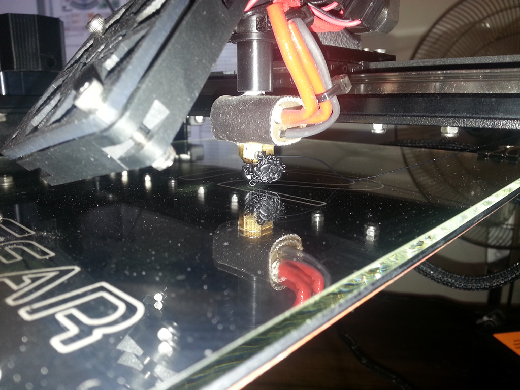

Hi 1st post - bit embarrassing but seems like a friendly community so jumping in :)
Have attached photo of 1st M2 print - which resulted in a blob of plastic sticking to the extruder whilst printing out the "bracelet". Just wondered what I'm doing wrong or if this is par for the learning course when getting started ;)
Settings: 215c extruder & 60c heat bed (using PLA).
Software: pronterface. (will upgrade to simplify3d soon as this seems to be the goto software to run)
Other than that - having fun watching all the motors/electronics purr and wizz around :)

the z bed needs to be zeroed and likely leveled

macsboost wrote:the z bed needs to be zeroed and likely leveled
Wow fast response. Thnx macsboost :) will go back thru all procedures here: http://makergear.wikidot.com/m2-getting-started

Check out the M2 tips thread in the hints forum, as well. It covers some alternate procedures and things that may be helpful.

jsc wrote:Check out the M2 tips thread in the hints forum, as well. It covers some alternate procedures and things that may be helpful.
@jsc funny you should just reply. I just read your very informative "M2 Tips" post here: viewtopic.php?f=3&t=12 - and got the idea to increase the heat bed temp from 60c to 70c - maybe e'thing was too cold - anyway my very first print (the bracelet) printed out perfectly. All is right in my world again :)
Thnx very much for the help ppl.
