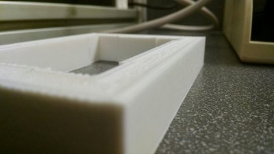

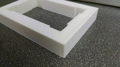

My problems began when I tried to print the part pictured below. The beginning of the print looked pretty normal but when I came back to check the print about halfway through, I noticed that all of the surfaces parallel to the Y-axis (the shorter faces the way I placed the print on the bed) had weird vertical ridges (first picture). The surfaces parallel to the X-axis (the longer faces) were normal. Also, the infill seemed to be sagging below the level of the perimeters. In the spirit of discovery I decided to let the print complete. The pictures below are of the completed print. It might be hard to tell from the pictures, but the same problems persisted - ridges in all surfaces parallel to Y-axis and sagging infill. The top surface is slightly recessed and a bit porous-looking as a result.

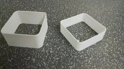

My next step was to run a test/calibration print with the same settings. I got the same result (image below, right - I stopped it mid-print). Then I ran the same test print with my 0.2 mm layer height settings and got a perfect print (image below, left). Finally I ran my part again with the 0.2 mm layer height settings and got a perfect print.
