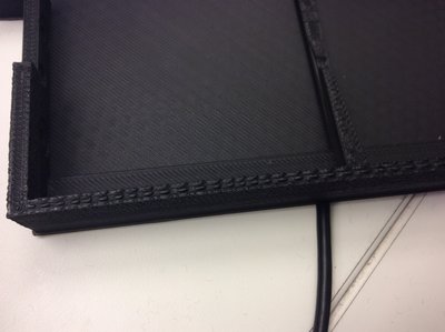

I just got my Makergear M2 last week. It is my first Cartesian printer. I normally worked with Deltas. Very happy with the quality. However, I am seeing this issue during my prints that I haven't experienced before.
I was hoping someone seen this and might have a solution.
Issue Description:

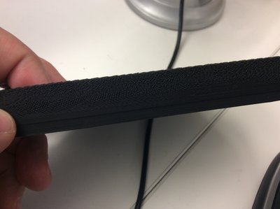

When filling perimeters, it seems that the filament "over flows" or is raised up a bit. Which causes a loud grinding noise when the nozzle passes over it.
Attempts to troubleshoot:
1- I am using the black PLA filament spool that came with the printer. Although, I tried 2 other PLA filaments (Third party) with same issue.
2- I have triple checked the bed leveling.
3- I have experimented with temperatures. The issue appeared when printing with the recommended 195, but I went back and tried to print using 180,185,190,195,200,205, and 210. The issue continues.
4- I have messed around the speeds as well. Printed at 60 mm/s and Settled with 30 mm/s at the moment, but the issue happens with both speeds.
5- It seems that this issue happens when the Perimeters are filled in a long line across the perimeter's length. Other Perimeters that are filled in a Zigzag patters along it's width do not produce that.
6- Using a paper test, my Z Calibration feels right. I don't think it is a Z Height problem.
7- I am using Slic3er mainly, but I tried with Cura and I am getting the same issue as well.
Pictures to Clarify the issue: (I hope this helps)
Any help is appreciated.
Filament over flow causing grinding when nozzle passes over

Well it looks kinda cool, but that aside...
have you calculated the extrusion multiplier? you may be over extruding.
link: viewtopic.php?f=3&t=1964#p9144
if that doesn't help, try lowering your infill/perimeter overlap. my PLA profile is set to 15% overlap.

Probably the gap between the bed and the nozzle is too small....(It's the most likely candidate for a "new to the M2" user.
Read through the Guide to Getting Started post here, it really helps to lay out the few calibrations that you need to perform to get the machine set up and extruding correctly. (It's written for complete newbies to 3D printing, but those with experience need to do the calibrations as well, to get good results.)

Just a crazy idea, but check the set screw that holds the hot end in place and see if maybe it is loose and the whole hot end is slowly being pushed out.

I had the same issue awhile back. If you are using S3D, find the setting called overlap and turn it down. Let me know if this helps.
EDIT: finally home infront of my computer. The setting is under Infill and is called perimeter overlap. Mine is set to 15%, when turned up to %25 I had the exact same issue as you.

Hummmmmmm, I didn't excpect that, but the only way for me to fix this is to reduce my extrusion multiplier from 100% to 60% is slic3r. I didn't expecting that it is over extruding thaaat much. I will double check later to make sure that my Steps Per MM are correct on the extruder.

Besides that problem, your extrusion multiplier should fall around 0.90 to 1.10. some materials might be higher or lower than those numbers but only another tenth. 60% is just a silly multiplier.
can you send me your slic3r config files for your print settings and filament? maybe I could spot an issue.
