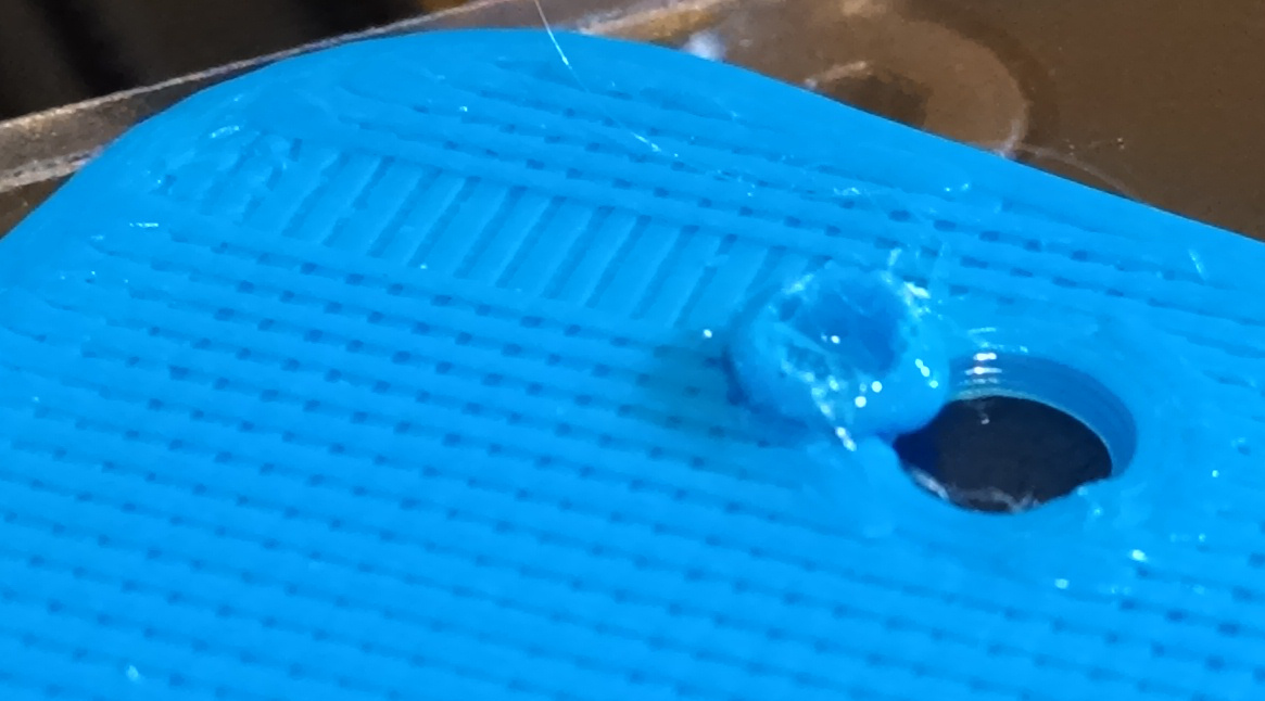

I looked at the incomplete print carefully and around one hole there is a bump of plastic sticking more than a layer height over the rest of the print. Could the nozzle have crashed into that bump and caused a fault that the Marlin firmware picked up which resulted in the aborted print?

Here's a pic of the area that seemed to be printing when the firmware got out of sync with the host. You can see the raised circle and compare it to the layer height which you can see in the small lower area to the left of the hole. I was using a 50% infill.

regarding the blob, that occurred from when the nozzle sat there in one place. your looking at the ooze all collected there in one spot. that is pretty common when you nozzle comes to a decent length stop on top of a print. the blob wasnt the cause, it was the result.
