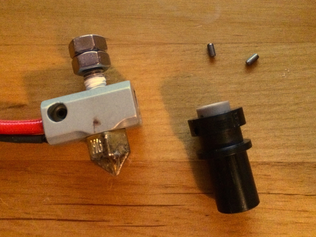

I had a bad clog, and trying to clear it with an allen wrench through the feed hole didn't work. I decided to try a full tear down. Now I'm halfway through, and stuck. I have a few questions.
On the left, I an at the point where you use a pair of M6 nuts to unscrew the nozzle. Only, I can't seem to get that to work. Whenever I turn the nozzle, the entire assembly turns as a whole, and the nuts just start unscrewing off the end of the barrel together. What's the trick?

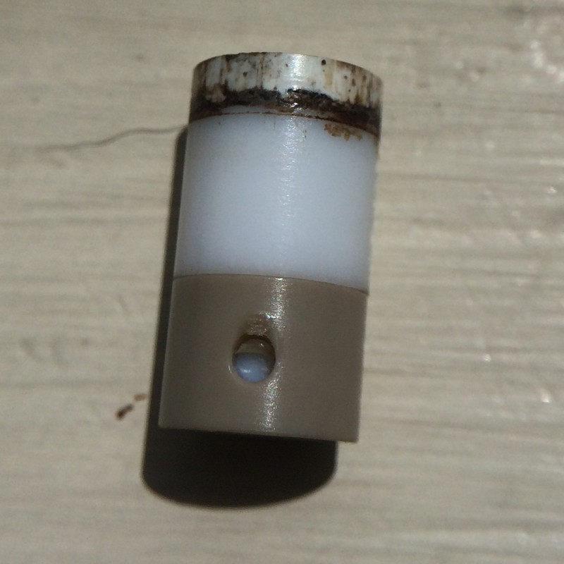

On the right, you can see where I managed to do something weird to the PEEK insulation, and now the white bit is sticking out of the black bit, and the two pins have come free. I can tell this is not what it's supposed to look like because it can't snap into the filament guide in this state. How do I get that part all back together?

jin the pins in the peek are not supposed to come out. no big deal though really. the white liner will push back and stick the pins back in. the 2 nut may need to be twisted together on themselves a little tighter if they are spinning. you can also heat the hotend up and try it. there may be plastic inside still that is bonding you nozzle to the tube. put a wrench on the heater block and another on the nozzle and unscrew them from each other. you just want to make sure that the block and nozzle are locked tight together like the 2 nuts are on the other end.

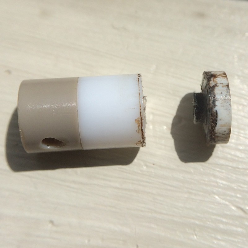

I managed to get the nozzle off. With Josh's help on IRC, I got the PTFE insert out of the PEEK barrel, but couldn't figure out why it wouldn't seat properly until Josh pointed out that the dirty bit up top wasn't supposed to be there.

Jin its sprayable stripper from kleen strip. I think they have it in quarts and gallons. Just soak the tube for a couple hours then a pipe cleaner or something to run through the barrel will clean it right out. Soak the nozzle as well. I have never pulled the ptfe out of the peek like that so im not sure if what you have there is normal.
