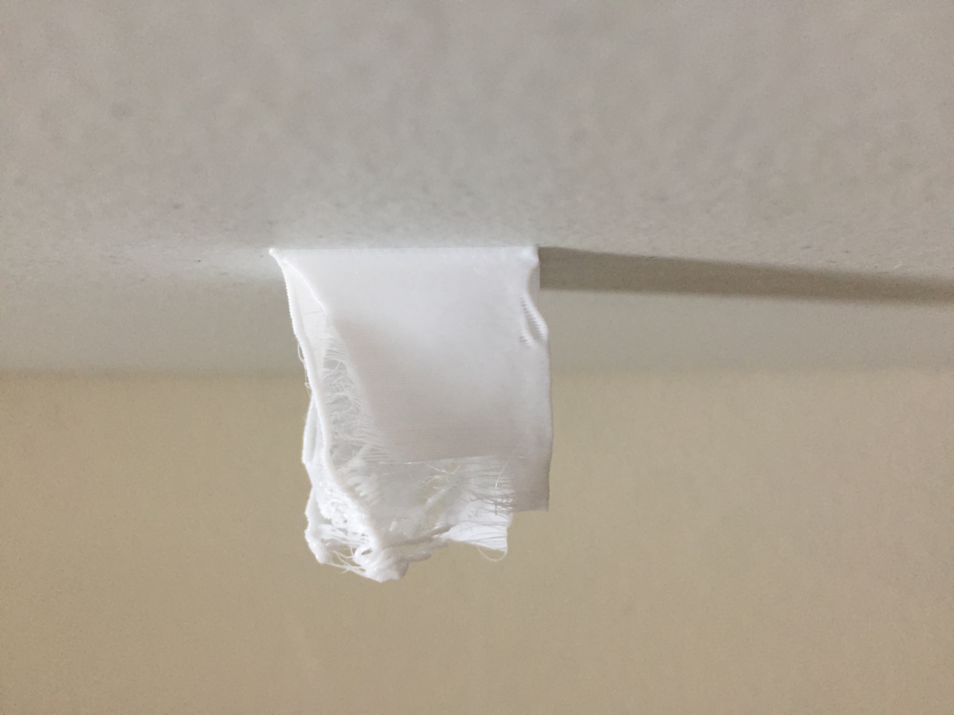

Please see attached.

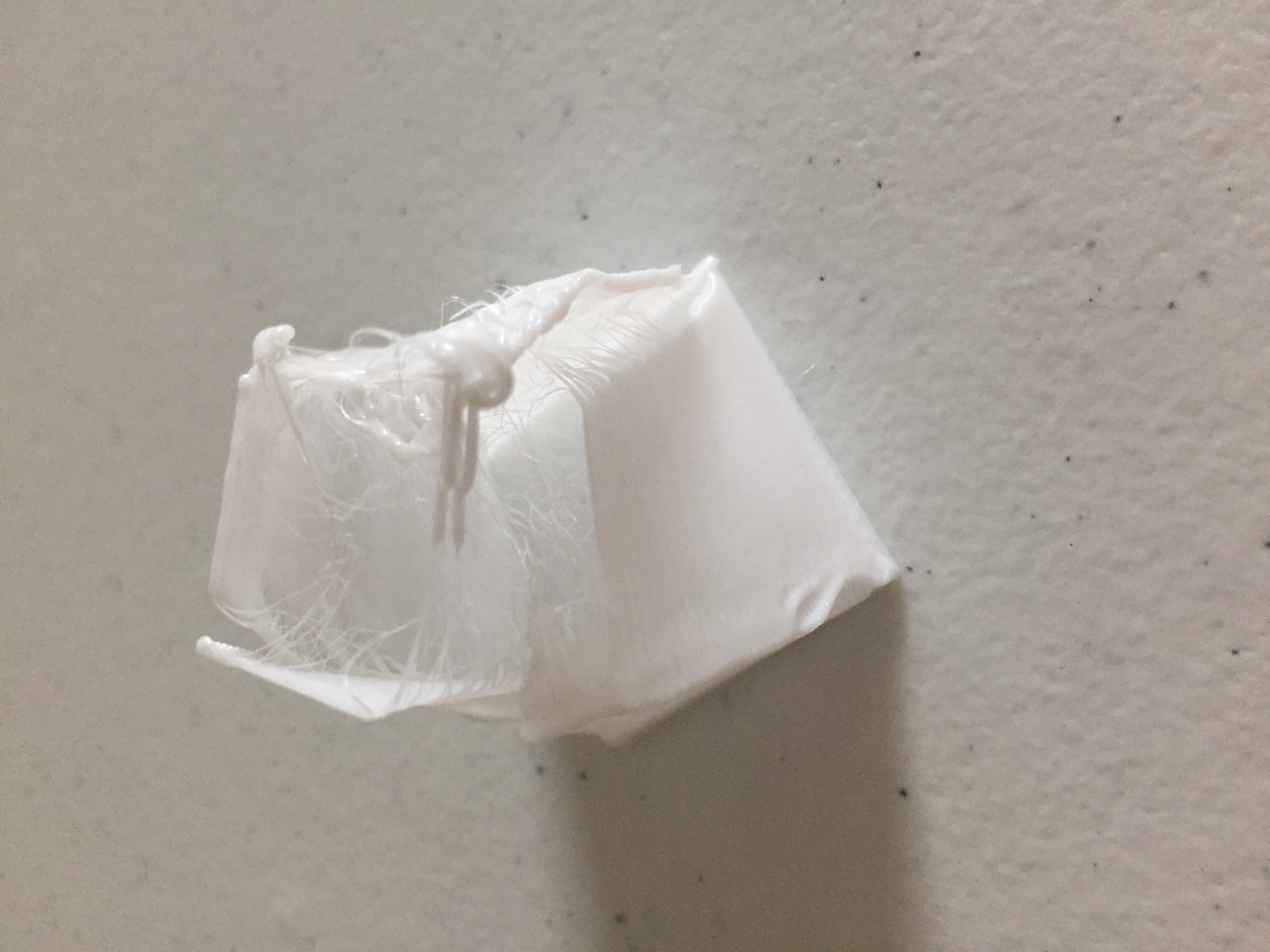

Every Hatchbox PLA filament print regarding the attached image successfully prints but when printing with Hatchbox TPU, the texture is fantastic, but so bendable and goopy that every print fails.
I'm using Simplify 3D with my MakerGear M2 E4 and am lost on what settings I should change the profile settings to using this TPU filament. I know every print is different but I at least need some sort of pilot light to get these prints going as every single one is failing.
Thoughts?

Try multiple outlines. That needs some more support.
Re: Hatchbox TPU Filament Amazing but Goopy
Thank you! That was definitley it.
