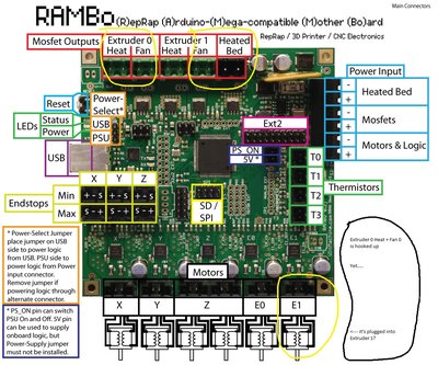

Checked the wiring on the board. The middle bit of the mosfets, the Extruder Heat 1, has nothing plugged into it.
But, in the corner, the motor is connected to Extruder 1, which is weird to me. Should I connect it into Extruder 0? To that extent, would that address the extruder fan issue?

If you have a single, that Mosfet (Extruder Heat 1) is left empty. (That is where you plug in the second extruder for a dual.) The E1 slot at the front is also reserved for the dual, as is the T1 slot for the thermistor.
Looks like you need to shift your wiring over to the E0 slot.

Thanks! I had did a wire swap form E1 to E0 on the board, but made no difference. I also edited the firmware with the supplied instructions on the page, and still no dice. Extruder fan also not turning on.Jules wrote:If you have a single, that Mosfet (Extruder Heat 1) is left empty. (That is where you plug in the second extruder for a dual.) The E1 slot at the front is also reserved for the dual, as is the T1 slot for the thermistor.
