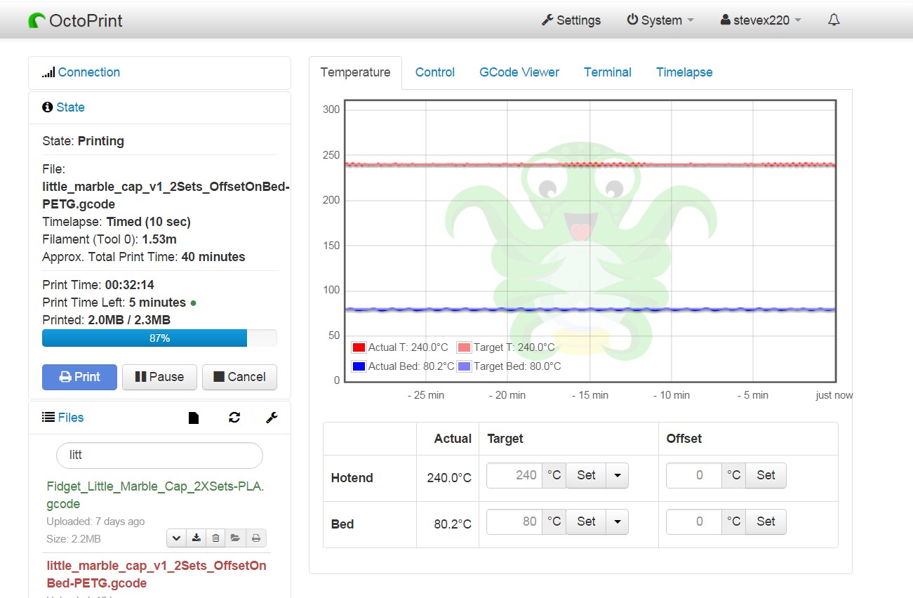

Came home to a stopped printer that had kicked out a MAXTEMP Error. Revision E with a V4 hotend. I was printing a long PETG print at 245C.
Rebooted and all seems functional. Is this a sign of future problems? Any ideas what would cause this? IIRC, the V4 is rated to over 300C, so it should have been well within range.
EDIT:
Printer is working, but thought I would add an Octoprint screenshot showing that the temp is fluctuating a great deal.
EDIT:

Thanks everyone for the input. The thermistor pulled out really easily, meaning the set screw had likely come loose. I tightened that down and all seems right with the world now. Just finished the 13 hour print that had thrown the error previously. Here is a printout of the temperature screen from Octoprint showing no more wild fluxuations:

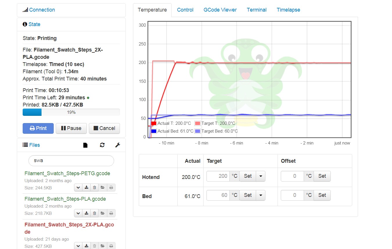

Well, may have spoken too soon. The temp fluctuation issue came back, so I changed the entire hot end (including another new thermistor). Thankfully, I have not gotten another MAXTEMP error, just the temp fluctuations. Thoughts on where to look next? Here is another screenshot showing the temp after the new hotend.

Here's a new temp printout.
