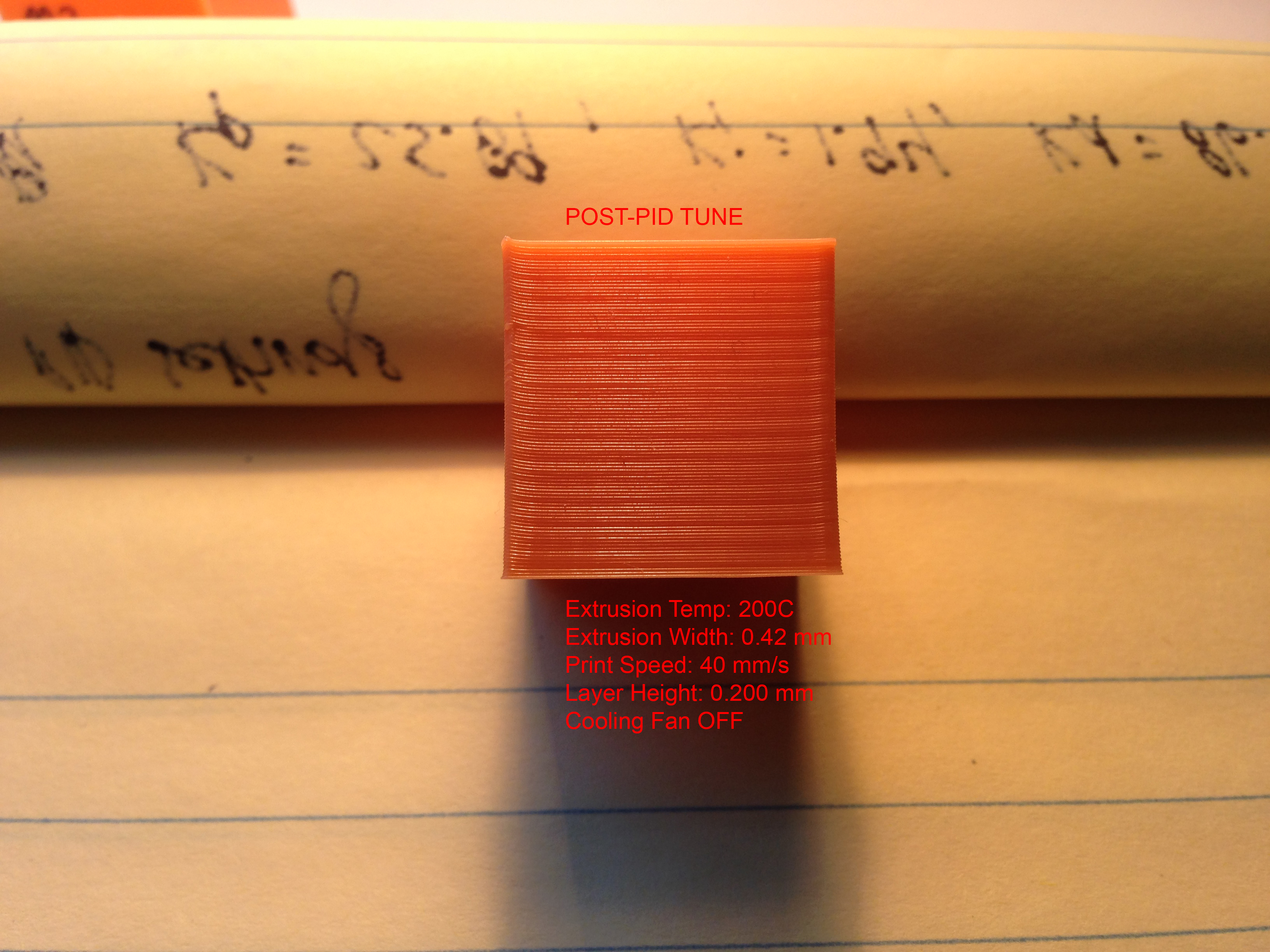

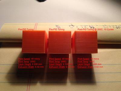

So, I did exactly that. I re-ran the calibration cube print at 0.100 mm layer height and the results seemed to confirm a PID tuning issue. I then re-ran the calibration cube print at 0.200 mm layer height after running PID autotune on BOTH the extruder and the bed. I confirmed the PID values had been changed successfully after an M301/M304/M500 command by restarting the M2 and checking the new PID values were in place via the attached LCD. The PID tuning did absolutely NOTHING to fix this problem. I've already notified Makergear Support about this issue, but they've yet to give me any options to resolve this. I was hoping some of the forum members have ran into this issue before with their M2 and could give some advice....
Note: I did run the PID autotune with the bed cooling fan OFF, which may explain why the lines still show up when actively printing PLA with the fan ON. I'm guessing this may be the issue since the PID autotune isn't running under exact printing conditions???

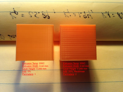

I did notice however, whilst calibrating my extrusion multiplier, that when I print a calibration cube with 0% infill, no top or bottom layers, and only 1 perimeter, the lines finally go away (see photo). I have no idea what to make of this. THAT is how I expect walls to look...nice and smooth. Any other ideas on whats causing the lines?

What are your infill settings?
Re: Defective z-axis or PID needs calibration?
I'm using 20% rectilinear infill for the calibration cubes, all printed in PLA.What are your infill settings?

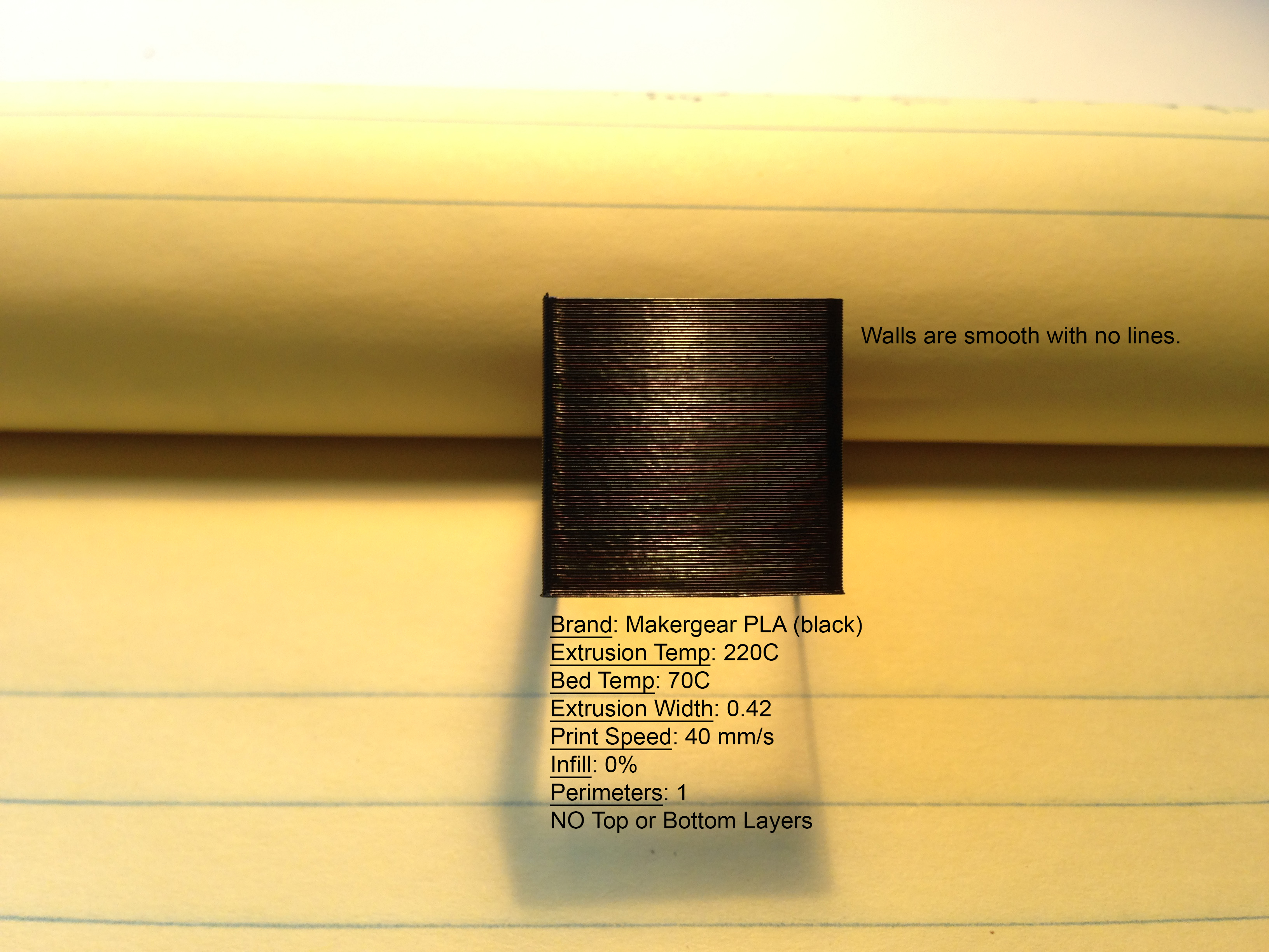

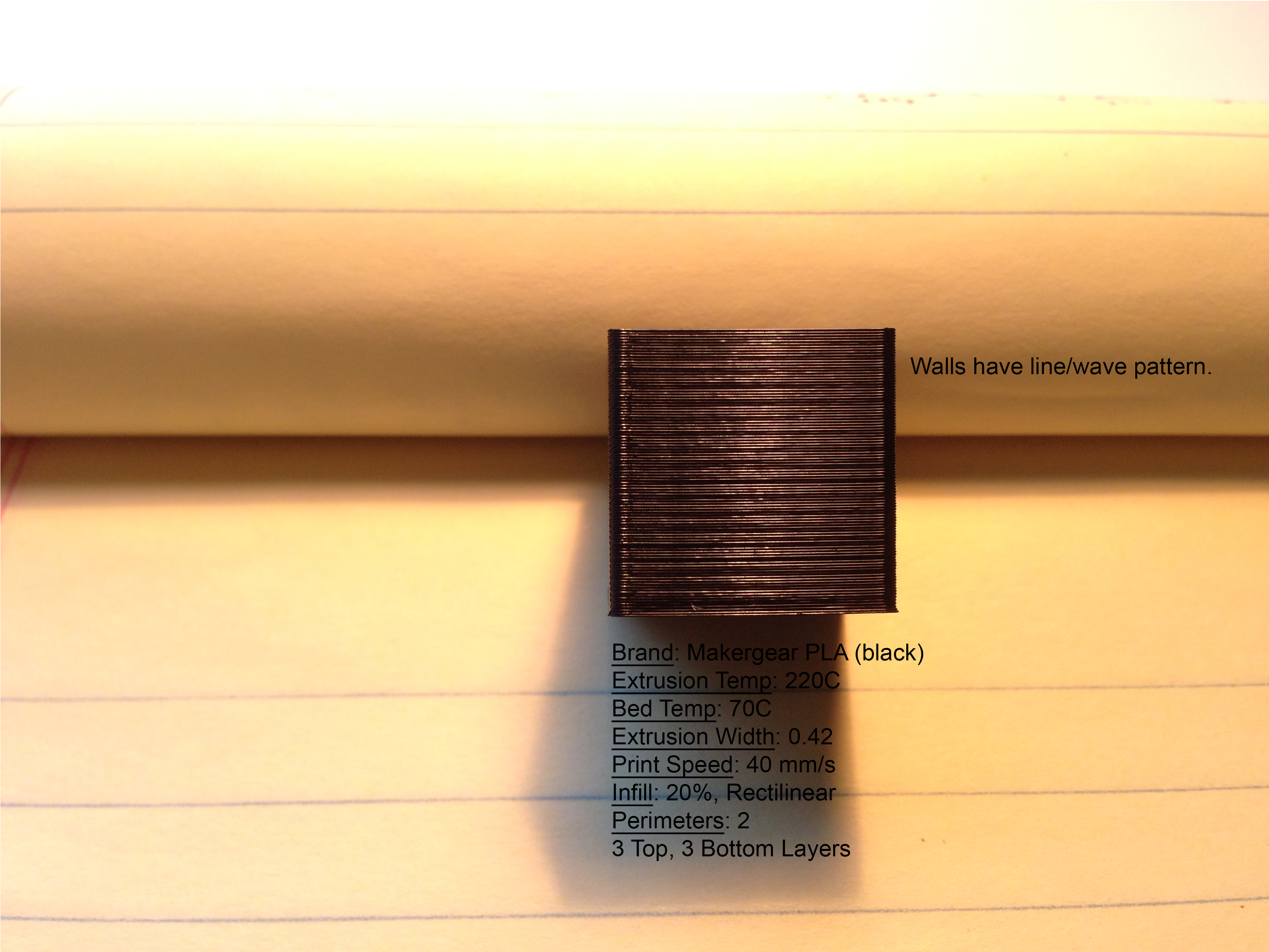

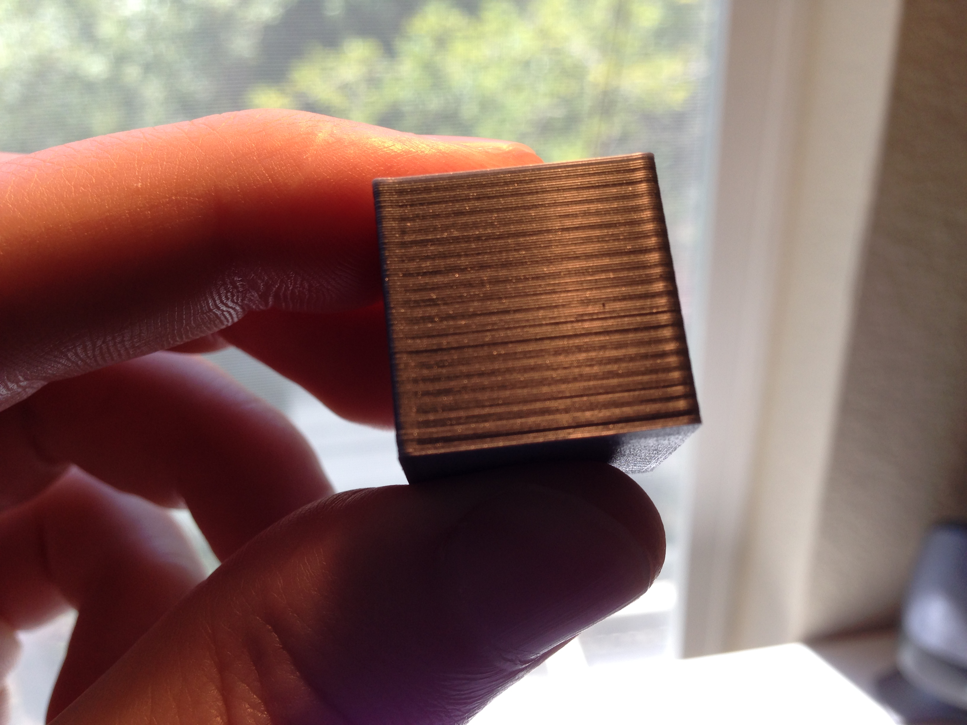

I re-printed the same cube again, this time in Makergear PLA. The issue still shows up in the cube with infill. I sent Makergear the g-code I was using and they can't replicate the issue. The cubes need to be illuminated from the right angle to see the lines (see photos). I'm in the process of printing four cubes at once to see if the issue still shows up. Correct me if I'm wrong, but this really is looking like a PID controller issue. If the z-axis rod(s) were defective, we would see the issue in the perimeter-only prints as well, yes? If it is the PID controller, I'm not sure what to do about it, short of running autotune again...
