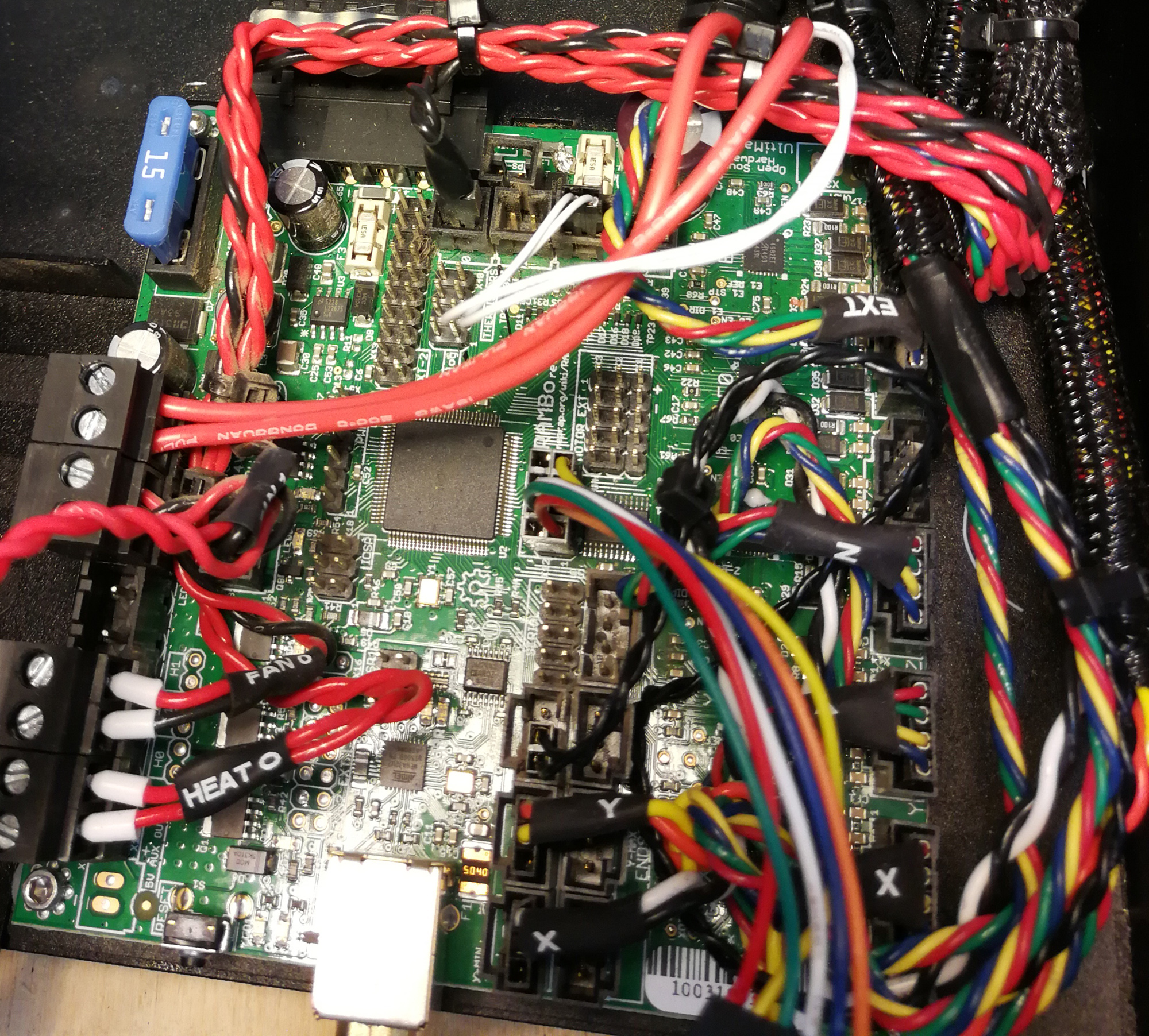

I may have fried my motherboard upgrading to a 4 point bed and new heating bed. I’m a novice with electronics. I still don’t know if I inserted the thermostat connector in the right way (no instructions on this), but I think that they are the same the same direction as my other newer printer.
I tried upload using the correct older Arduino (after initially mistakenly uploading using the older version and trying the Quick Start app). The printer no longer connects, and the MB fan no longer works (I tried 2 fans. Albeit the little green light in the front goes on and the USB makes a sound when inserting and taking it out).

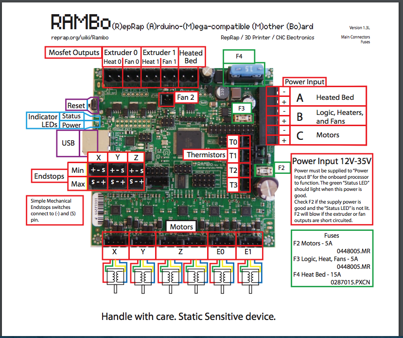

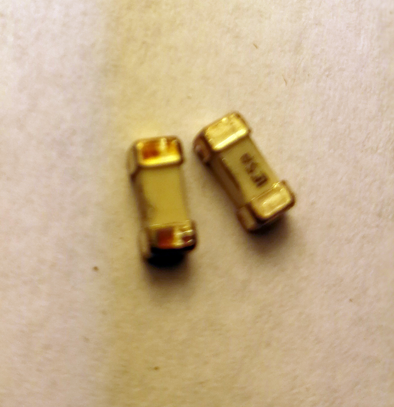

The image of the MB that attached names 3 fuses. Two of the fuses are tiny. I have no idea how to get them out (with tweezers?). Or if they have blown.
I did a Google search for the 04448005.MR fuses and couldn't find a place in New Zealand that sells them (but I did find a NZ site that appears to be based in the US. It costs about 5 times the value of the fuses to send them here). I’ve emailed a friend who knows a little about this stuff who may be able to source them.
Any suggestions on getting this machine working... and if i need them, where one might find these tiny fuses this part of the world?

  • Hopefully one of these fuses is the culprit (although I just checked with a voltmeter, and they seemed OK?)? Does anyone down-under reading this post know where to find these fuses?

A fuse is basically binary: if the ohmmeter (1) shows nearly zero resistance from one endcap to the other, then the fuse is good. If it shows "open" / "overload" / whatever, then the fuse is bad.
New Zealand seems like a great place to live, but sending anything there is expensive.
If they're still zero ohms, then reinstall them, because they're not the problem.

The switch cable is backwards in its socket.
The (polarized) jacks on the PCB have three pins: [S - +]. The switch pin ("S") is on one end, with the common ("-") and 5 V ("+") pins adjacent to each other.
The (non-polarized) plug on the cable has three positions, but the switch has only two wires. When you insert the connector backwards, the switch wires connect to the wrong pins.
Everything works fine until the switch closes, whereupon it shorts the power supply to ground and resets the microcontroller.
You're not the first to do this and definitely won't be the last … [sigh]

And apparently I had initially plugged the z stop connector to the wrong plug (the min plug instead of the max plug as on the motherboard image above). That mistake for some reason caused the USB to fail to connect to my laptop, and the motherboard fan not to run - which led me to believe that the motherboard was fried. All is good now with the best 3D printer in town!!
