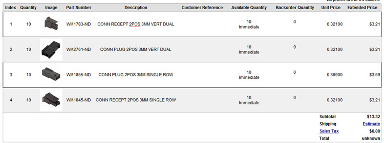

Here's what I ordered.

Re: Molex Connectors for Fans = ??
Post by Tim » Tue Sep 02, 2014 3:19 am
Don't forget the crimp pins. The connectors you have in the screen capture are just plastic shells. Of course, you may have plenty of crimp pins lying around (I know I do); I'm just checking.
And, again, only the top two are the ones used for the fans, with the latch on the short side of the connector. The other two are used for the thermistor and heater. MakerGear has very helpfully put the connector types one way for the thermistor and the other way for the heater, making it impossible to plug them in the wrong way. Likewise, the use of the different latch style on the fans makes it easier to avoid cross-connecting the fan to something else, and the use of the latch on the connector (as opposed to the simple headers they were using for the fans a year and a half ago) makes it easier to avoid connecting the fan backwards and having it run in reverse.

Post by Lateralg » Tue Sep 02, 2014 5:29 pm
Tim wrote:Don't forget the crimp pins. The connectors you have in the screen capture are just plastic shells. Of course, you may have plenty of crimp pins lying around (I know I do); I'm just checking.
