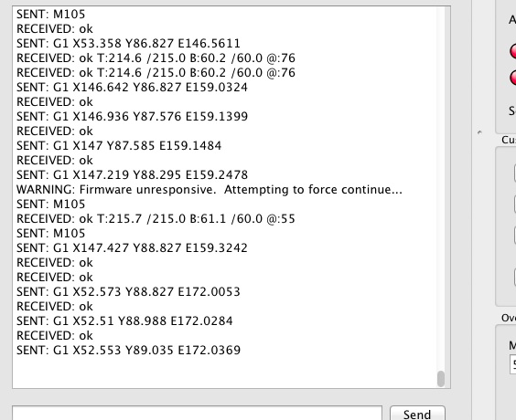

Hey all - I'm having a problem with my M2 after a month of successful prints: During the print process, I get a message in S3D's Communication window that says "Firmware unresponsive. Attempting to force continue..." and the print head keeps going outside the perimeter of the print, I think until S3D reestablishes communication. Or the print head moves without extruding.

Today I printed the same GCode via the SD instead of over USB, and it worked. I'll continue to test - I've had success printing over USB in the past - but thanks for that advice.

The "knowledgable response" is that USB uses differential signaling, so it can't really suffer from ground bounce, although a large ground difference can reset the RAMBo on some earlier board revisions. There are many possibilities for what the problem could be, such as a baud rate that's set too high, or a latency that's longer than the timeout period, etc. All of these problems would be down in the USB driver, and whatever they are, you can avoid them all by running off of the SD card.
Although you won't be upgrading the Mac, there's always the possibility of updating the USB-serial driver.
