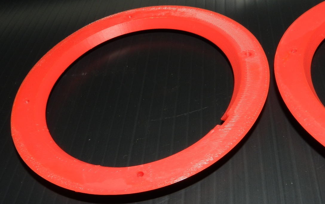

By printing without a raft, your model on the bottom side should have a nice finished look like this:
ABS_base 002.jpg (161.34 KiB) Viewed 6032 times
