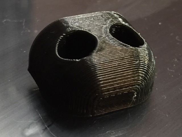

I don't think your theory about acceleration control is correct. Stepper motors work by counting an absolute number of steps, regardless at the speed at which they are delivered. If the extruder were out of position and turning the corner early, every layer would be shifted. However, it might be the case that there is a mechanical lag in the system such that the extruder position is not quite to the corner when the other stepper kicks in to begin motion in the other axis, which might lead to asymmetric effects between X and Y axis because the mechanical properties of the axes are different.
Anyway, here's my print of your test object. There is some vibration/overshoot induced rippling but it is in line with what I have seen with vertically oriented holes on other models.

Try printing at 2400 mm/min (40 mm/s) and lowering accelerations by adding
M201 X800 Y800 ; lower default accelerations
to your startup gcode in the Scripts menu of Simplify3D.

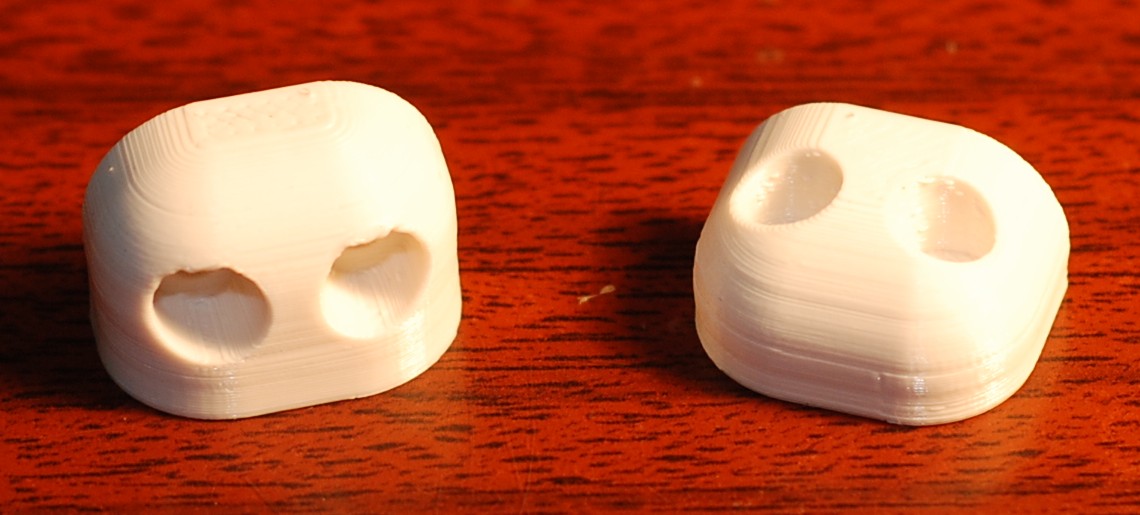

And as I promised the print with cheap China printer

The flat area around the tip of the nozzle is there for a reason; it flattens out the filament. MakerGear designed the flat part to be a bit wider than the nozzle opening itself. I have noticed that it is wider than the flat area on my E3D nozzle. However, when I was using the E3D nozzle, I found no change in the echo ripples on the print. After using the E3D for a while, I concluded that I liked the MakerGear nozzle design better.
