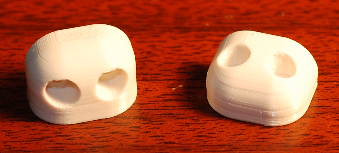

Both models printed by other people. First printed by M2 printer second with cheap Chinese printer. So we can tell 1000 marketing words but once again I put to your eyes the evidence that M2 nozzle has a problem. And any one on this forum can print this model and check. Since you have cool nozzle you should able to print the model without problems on the first photo. So I wait the evidence not the empty words. (Please include information about nozzle and it's photo. )
M2
vs noname

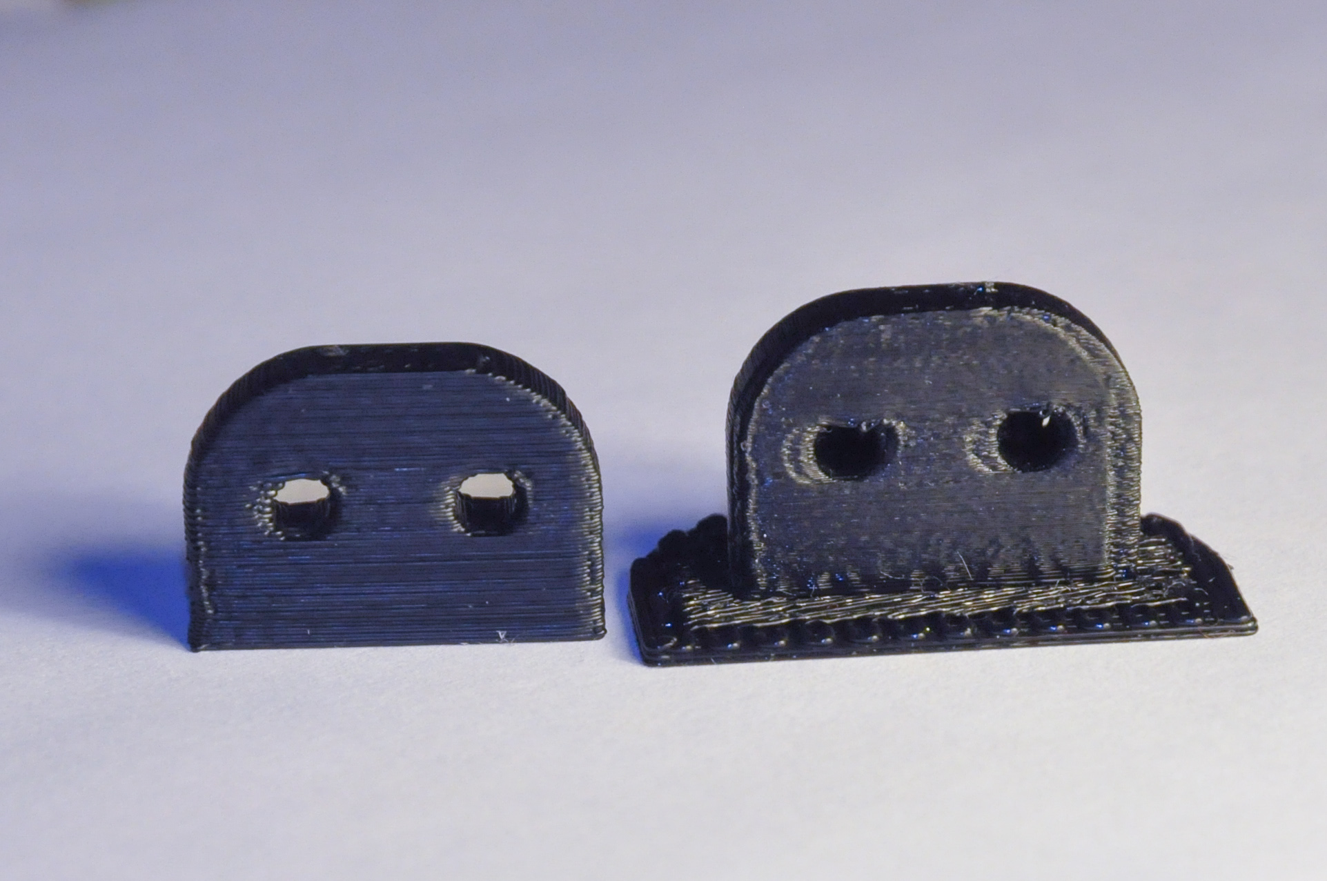

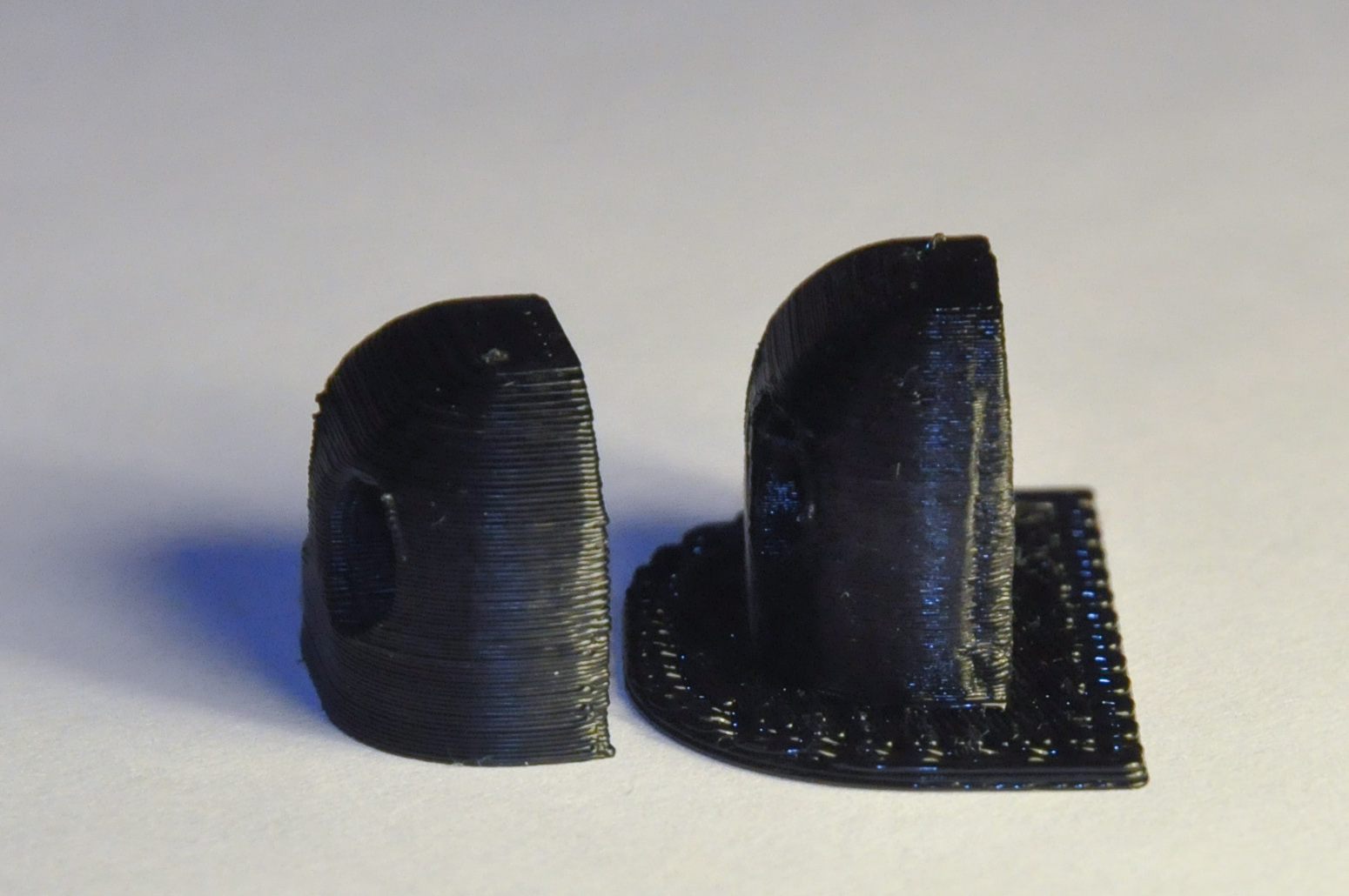

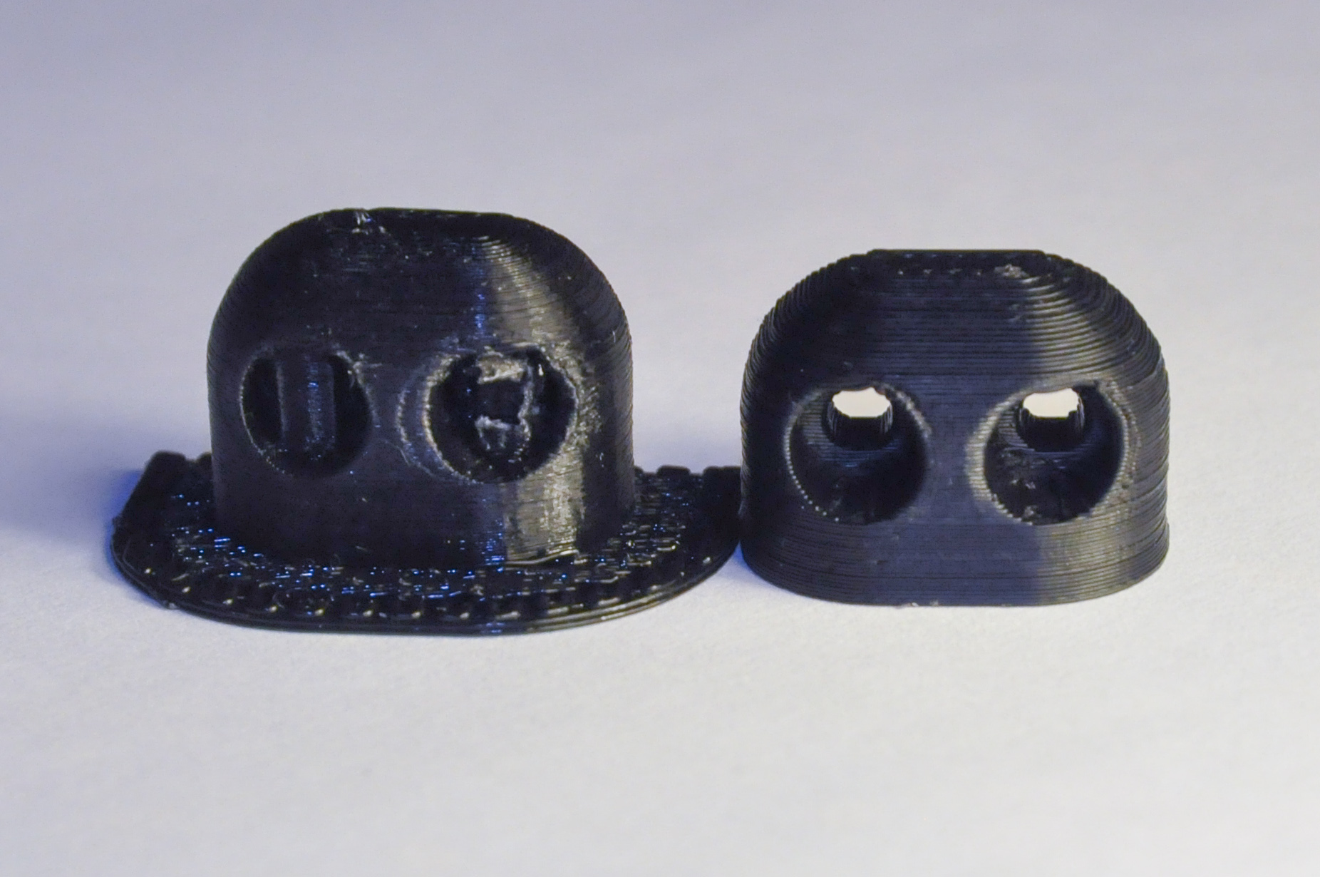

In this post I put few photos.
On the Raft the default nozzle print. Without raft the same nozzle but fixed by my father.
(536.02 KiB) Downloaded 404 times
(596.98 KiB) Downloaded 404 times
(672.81 KiB) Downloaded 404 times
(437.97 KiB) Downloaded 404 times
