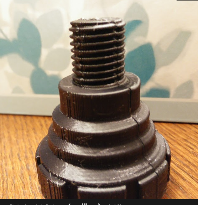

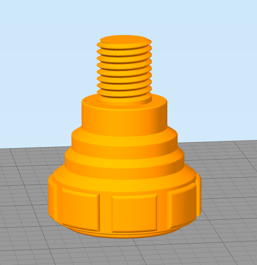

Hi guys. I am having troubles printing some threads on this part and I am not sure what to do about it. It's only the threads that are giving me trouble. I am happy with the rest of it. Does anyone have any tips or things I should try in getting these threads printed a little better. The part comes from http://www.thingiverse.com/thing:92824/#files
I am using rsilvers profile called "M2_PLA_0.25mm_Medium-v1.0.fff" that I found on http://www.thingiverse.com/thing:269637
Thanks,
-Dan
Help printing threads on this part

Looks like the threads could be too small for the layer height you are using (there seems to only be about 3 layers per thread). You could try lowering the layer height.
Also appears that the weird section aligns with all the layer-start 'pimples' lower down. There should be an option somewhere in the slider to randomize layer start positions. That spot is also where there will be a weird seams in the layers, as you are trying to print a spiral using flat layers, there is always going to be a seam somewhere. Higher resolution layers, and the randomized starts should help you get to somewhere closer to usable.
I have had success printing threads in the past, but they tend to need to be courser than the ones you appear to be trying.

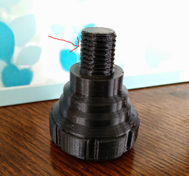

Thanks everyone. My 4 year old son and I are super happy. Doing what Ed suggested really cleaned up the threads. Thanks jsc for the tip on just rotating the model in S3D.
@benavery, I first tried what you suggested and lowered my layer height and it didn't seem to help any. Thanks anyway for chiming in.

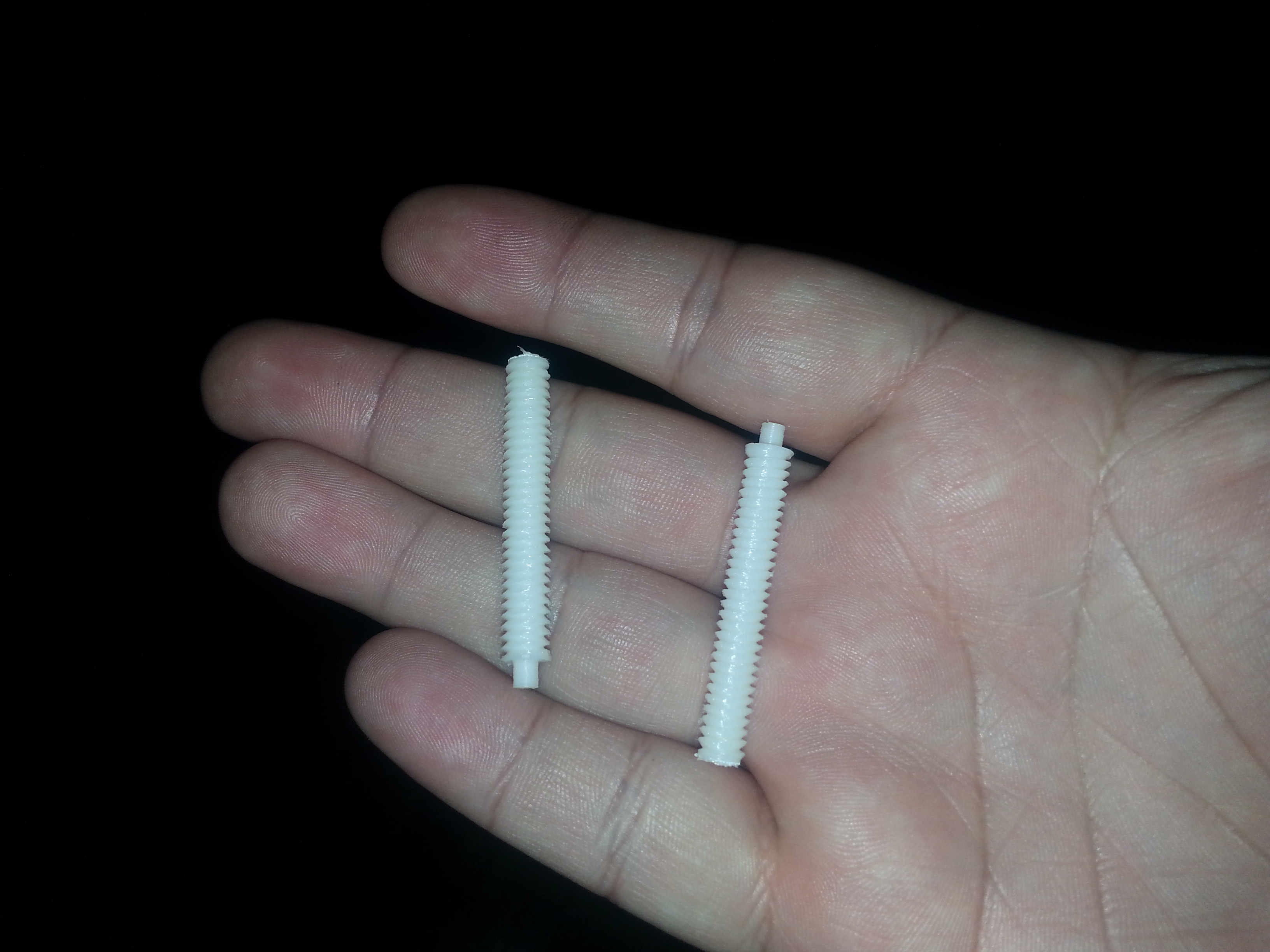

Don't be silly, you don't have to split and glue threads. Just print multiples at once.
These are ABS @ 0.08mm, printed vertically, 4 at once on a raft.
