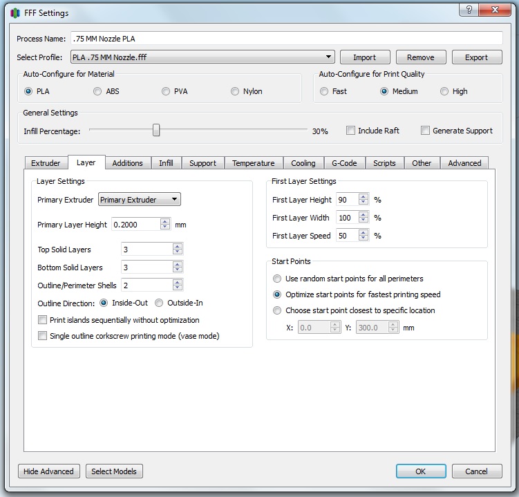

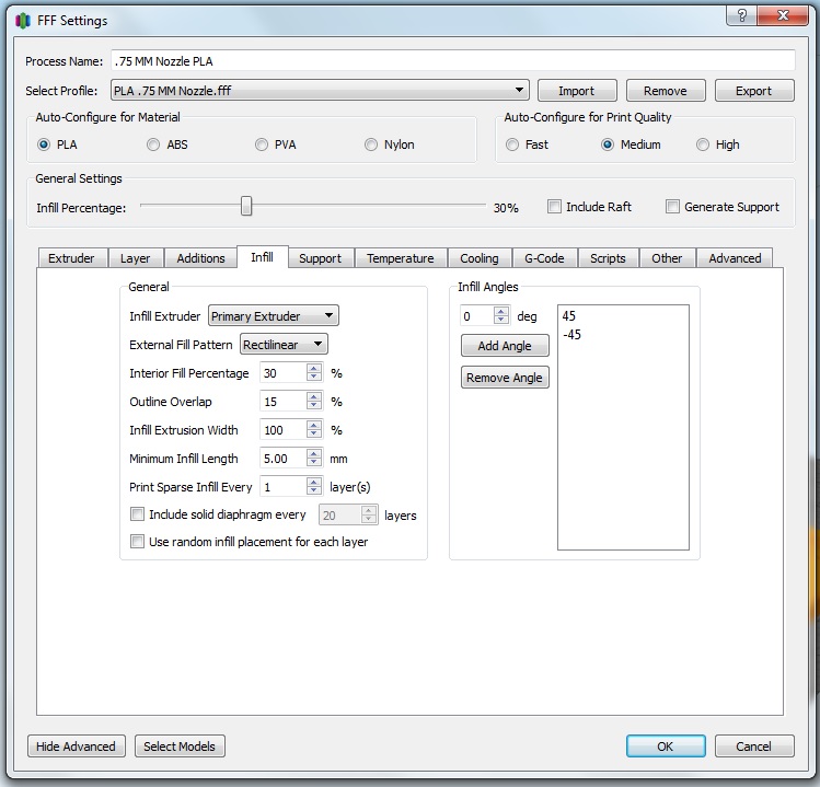

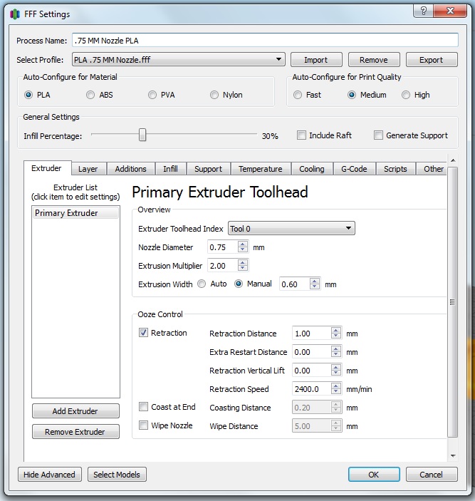

I was able to get the .75 mm nozzle to work, but the problem I am running into is that its laying down 3 times as much material...... so It kind of defeated the purpose since the time savings will be eaten up by material cost.
I have attached a sample print of the same part printed with a .35 mm nozzle and .75 nozzle. You can see how much darker the .75 nozzle print is because of all the material used. ( both parts were printed using the same material )
I have also attached 3 screen shots from Simplfy3d profile for the .75mm nozzle.
Kind of a head scratcher...

Some of that difference can be accounted for because you are laying down two solid perimeters at 150% of what you would normally be doing with a 0.35 mm nozzle, so your perimeter is the thickness of a 3 layer perimeter.
I don't know what accounts for the rest of it. Presumably, 30% infill means lay down a pattern to cover 30% of the surface area, regardless of extrusion width. So you should be seeing no more than a 50% gain in weight.

I think that's what the parameters call for...kentd wrote:its laying down 3 times as much material
For a 0.75 mm nozzle, forcing a 0.6 mm width requires the extruder to produce a thread narrower than the nozzle, which doesn't work well. Set the width to about 0.8 mm, maybe 0.9 mm.
Using a 0.2 mm layer thickness with a 0.75 mm nozzle doesn't take advantage of the material flow rate. That should be around half the nozzle diameter, maybe a bit more: try something close to 0.45 mm for starters.
Using an Extrusion Multiplier of 2.0 doubles the amount of material laid down. That number should be very close to 1.0.
You'll probably need more retraction, because a 0.75 mm nozzle has nearly 5 times the area of a 0.35 mm nozzle: there's a lot more molten plastic ready to drool out that bigger hole, so you must yank it back further.
Once you reset those values, calibrate the actual output using a series of thinwall boxes. When you get everything right, the single-thread wall thickness will be spot on 0.8 mm (or whatever you set). When you measure the filament diameter accurately, the slicer should come pretty close to the right output, whereupon you tweak the Multiplier to get the exact width you're specifying.
For the 0.35 mm nozzle on my M2, I use a thread 0.4 mm wide x 0.2 mm high = 0.08 mm². For a 0.75 mm nozzle, using 0.9 mm wide x 0.45 mm high gives a 0.4 mm² thread. That's 5 times the plastic volume per unit of XY length, so your prints will take maybe 1/5 (that's optimistic) of the elapsed time at the same XY speed.

Ah, I hadn't noticed the 2.0 extrusion multiplier. That, plus the 1.5x amount going into your perimeters, would give somewhere between 2-3x the amount of filament, which is what you're seeing.

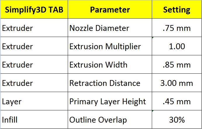

First off.... I want to thank EVERYONE for their input...... I am now much closer to success because of your help.
The .75 nozzle is now flowing great... and the parts are looking much better.
I have just a couple of follow up questions.
Question #1: I noticed that the two outside wall layers don't stick to each other. In other words they are just laying next to each other.
I tried adjusting the Extrusion width downwards to .75 and .70 mm and it looks like they get closer, but then I am seeing poorer quality print on the rest of the part.
Any suggestions of another setting change that may help fix this?
Question #2: Now that I have decent parts coming out, what would be my next tweak in my settings that may help me decrease even more the amount of material I am using?
The photo below shows my current settings.

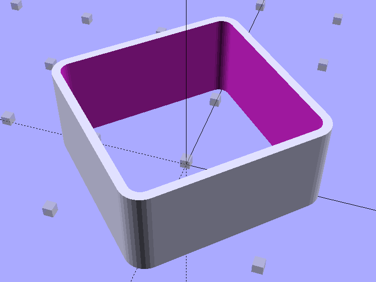

Because the thread width is so much larger than the typical cubes out there, you should build your own model with a 0.85 mm wall, so the slicer doesn't go nuts trying to lay a 0.85 mm thread along a path that calls for 0.30 mm. The attached ThinWall.zip file has suitable STL file generated with my OpenSCAD routine:
http://softsolder.com/2014/04/18/revise ... on-object/
Slice it, print it, measure it. If the wall isn't spot on 0.85 mm, adjust the Extrusion Multiplier by 0.05 and repeat until it is. You must re-slice the model each time you change the Extrusion Multiplier so that the printer knows about the new number. After a few iterations, you should get consistent results that match the values you told the slicer to produce, at which point you can re-slice your model and see how it comes out.
