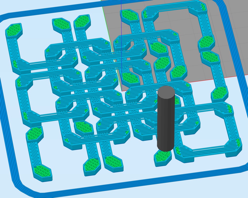

Ed, this is in Slic3r 1.2.1:
The links:

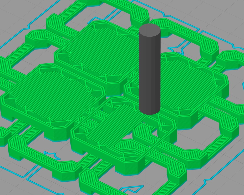

Cap bridging:
(240.94 KiB) Downloaded 384 times
Looks okay to me. Here's how S3D handles the cap bridging, it opts to bridge just the interior gap rather than the whole thing:

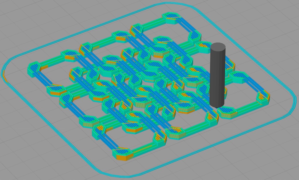

Here's the latest version of Cura.

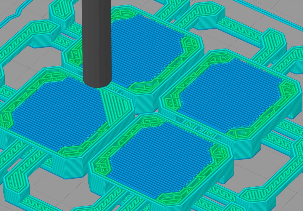

Cap:
Links:
I thought maybe it's something with your config, so I loaded your config and resliced it. Here's the links layer again (note your zero centered bed):

jsc wrote:bridge just the interior gap
That's definitely better, but Cura seems to produce each bridge thread with an independent extruder start-and-stop cycle. Anchoring a bridge thread exactly on the perimeter thread(s) requires very, very finicky retraction adjustment; you'd (well, I'd) never notice any problem in a model with fewer bridges.
Apparently Cura gets confused, too: the topmost link in that image has the infill pattern!

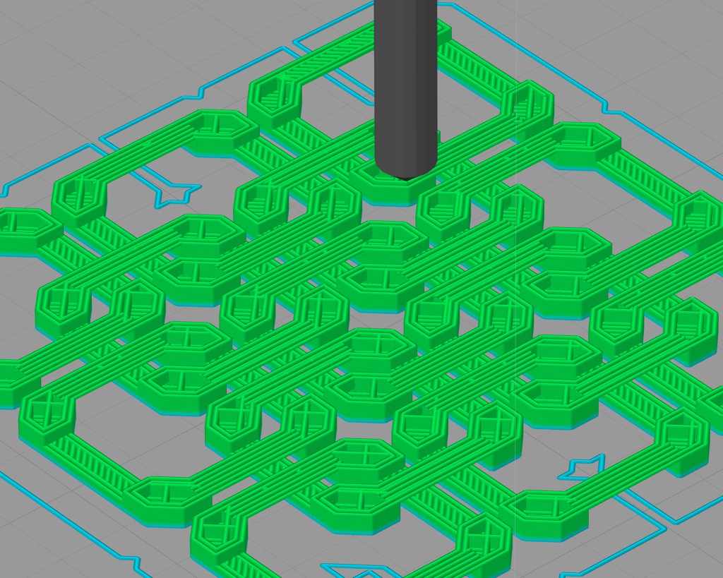

The bridging threads look a bit ragged, but there's no evidence of dragging:
In fact, the strands start out droopy and tighten up as they shrink, producing a final result that looks better than I expected. That's why I'm leery of starting bridge threads on just the perimeter threads: given the small anchor area, surely they're more subject to being dragged away, particularly when the nozzle starts next to the end of the thread it just finished laying down.
The bridges run at 50 mm/s and 100% flow; the nozzle doesn't spend much time dilly-dallying over the abyss.
The bars definitely look better than the cap, mostly because the cap spans a larger opening. I think increasing the flow a bit would help with the sparse bars in the cap, but it probably doesn't make any real difference.
The first layer of diagonal infill over the bridges came out fine... whew!
