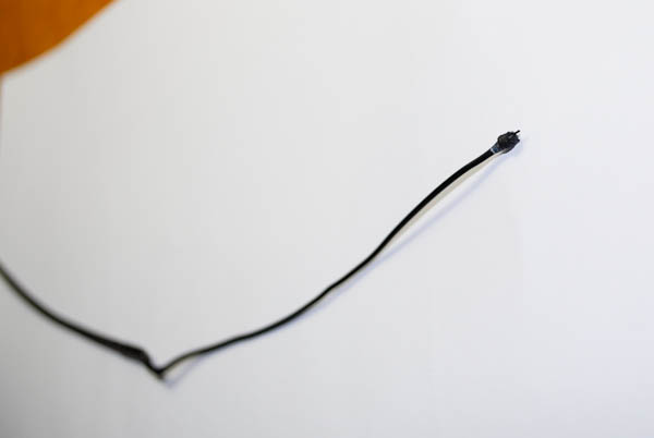

Post by sthone » Fri Feb 13, 2015 2:14 pm
Before you go taking it apart did you try doing the cold pull technique on it to clean it? I did this last night and you can see from the below picture is is very effective when it even cleans out the .35 tip.
Basically with the temp off and the filament still in the extruder I removed the entire thing from the motor. After it is removed turn on the extruder and when it reaches around 80c give a yank on the filament and it should be just hot enough to pull out but just soft enough so everything in the nozzle/barrel should and come out with it. (it might stretch a bit when you pull on it) That temp was using PLA though, read this page for more info on using other filament types. http://bukobot.com/nozzle-cleaning
