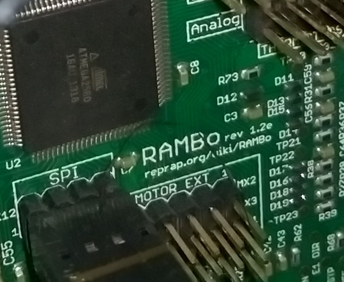

Pop open the top of your electronics enclosure, and see if you have a RAMBo 1.2:
Look for more than just the blue fuse -- it'll say 1.2 on the board. They had a static electricity problem which could kill parts of the controller.

Looks like it's version 1.2. Attaching a photo.

Contact MG support then, I bet it got fried with static :? .

Already have, they are not very responsive for some reason. Do you think the entire motherboard would need to be replaced?
