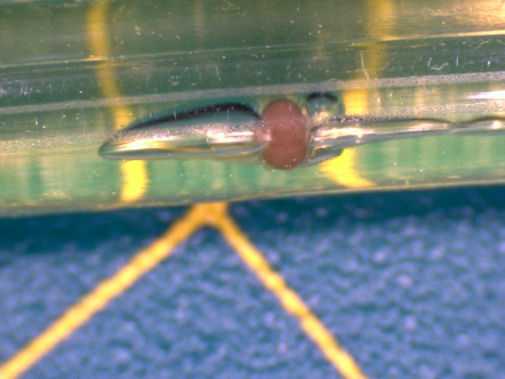

Have you popped the nozzle off the V4 yet and looked around? Might be something clogging the nozzle ( http://2.bp.blogspot.com/-fUqAk76r7fY/T ... ball_3.jpg ), char, dust, etc. Take the nozzle off and try extruding through the giant fat hole that the nozzle threads on to. If that works, soak the brass part overnight in the strongest solvent you have, then an hour in acetone, then torch it with a propane torch, and rinse again in acetone (have a sufficient quantity of acetone so the red-hot nozzle doesn't cause it to catch fire). At that point you can inspect the nozzle carefully for any debris that shouldn't be there, and remove it, if it wasn't incinerated already. Polish the nozzle with 1000-grit wet-dry before reassembling the V4.nokianich wrote:PcS wrote: Just wondered as too low a temp could cause that .
