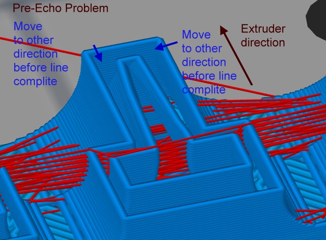

Please read forum more carefully, other people also has the same problem. Please take a look at the photos with red arrows. I assume that your printer is tuned fine and should print without problems?
If so, please find the model in attach , rotate it by -90deg by X to make the holes horizontal and print as slow as possible to avoid machine vibration.
I waiting your photos of the details. This will helps define reason of the problem.

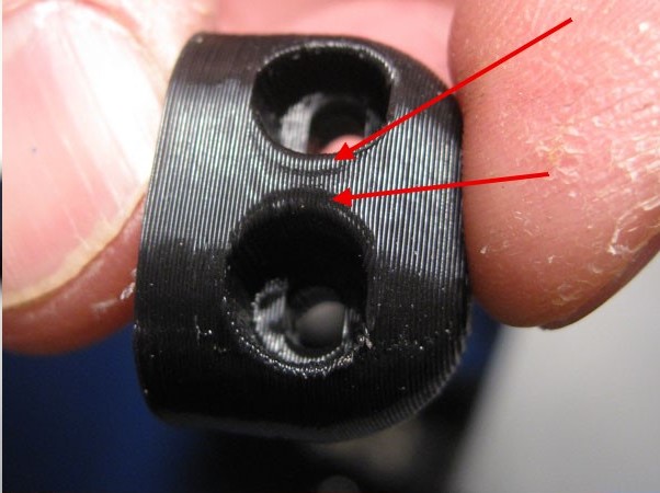

The echo that you pointed out on my pictures is totally different. You will not fix that and you will find that on almost any 3d printer to some degree. as i said previously,its the vibration from a direction change which travels through the hardware. If you are seeing some type of artifact BEFORE the move then that is not an echo. It is a totally different issue.

You have shown that the problem on your M2 occurs shortly before the nozzle reaches a corner. That's not the same as the slight mechanical resonance / ringing that occurs after the nozzle goes around a corner, which is what appears in the photos of models printed by other people.

Well i have printed the model and what you are pointing to in the pictures i will repeat again is very common with most printers. Some more than others. Unless you plan on paying $4-5k for a well built core xy machine you are goig to get this. Again if its happening before the move then its completely different problem and not what the arrows are pointing to. I think you need to look around a bit and see the prints from other machines in person. You will see it on all of them unless the print is specifically printed super slow to make a print to avoid this in pictures. You are going to be quite disapponted with whatever printer you get. Good luck to you.

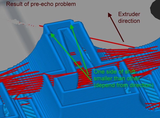

Sorry but problem not related to the well built. I think the problem related to firmware that try to stop extruder before the finish of the line to avoid "mechanical vibration" but M2 not tuned correctly and printer do this before it really should do this. Some other printers don't has this problem. I will prof this on the next week. (even cheap Chinese)
My prof (not _words_) -
Pre-Echo prof1.jpg (90.93 KiB) Viewed 12327 times
Pre-Echo prof2.jpg (85.68 KiB) Viewed 12327 times

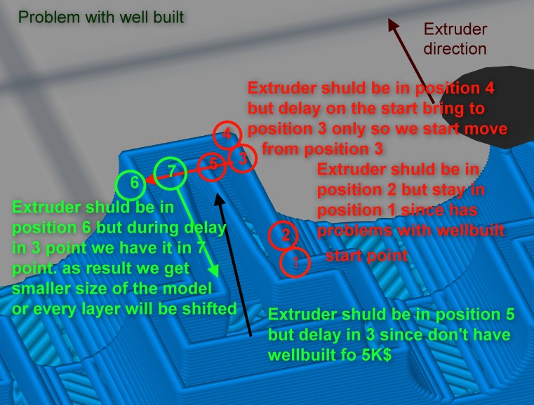

My explanation of well built and setscrew problem. as you can see you will get completely other picture in result.
Pre-Echo prof3.jpg (127.92 KiB) Viewed 12323 times

seems you even don't _want_ understand me :) I don't tell about extrusion. I tell about movement of the extruder as coordinate point.
Just open your mind and step inside ©fight club
yes. we try connect M2 to Arduino Mega instead RAMBO and get the same problem. But we use same firmware - marlin. The company who use other firmware have a different results. Why MakerGear don't want to finish tuning of own printer and continue tell the story about vibration and well built I don't know :)
I can bet 300$ that other printer that cost less than 1700$ will print this model without problem :)
