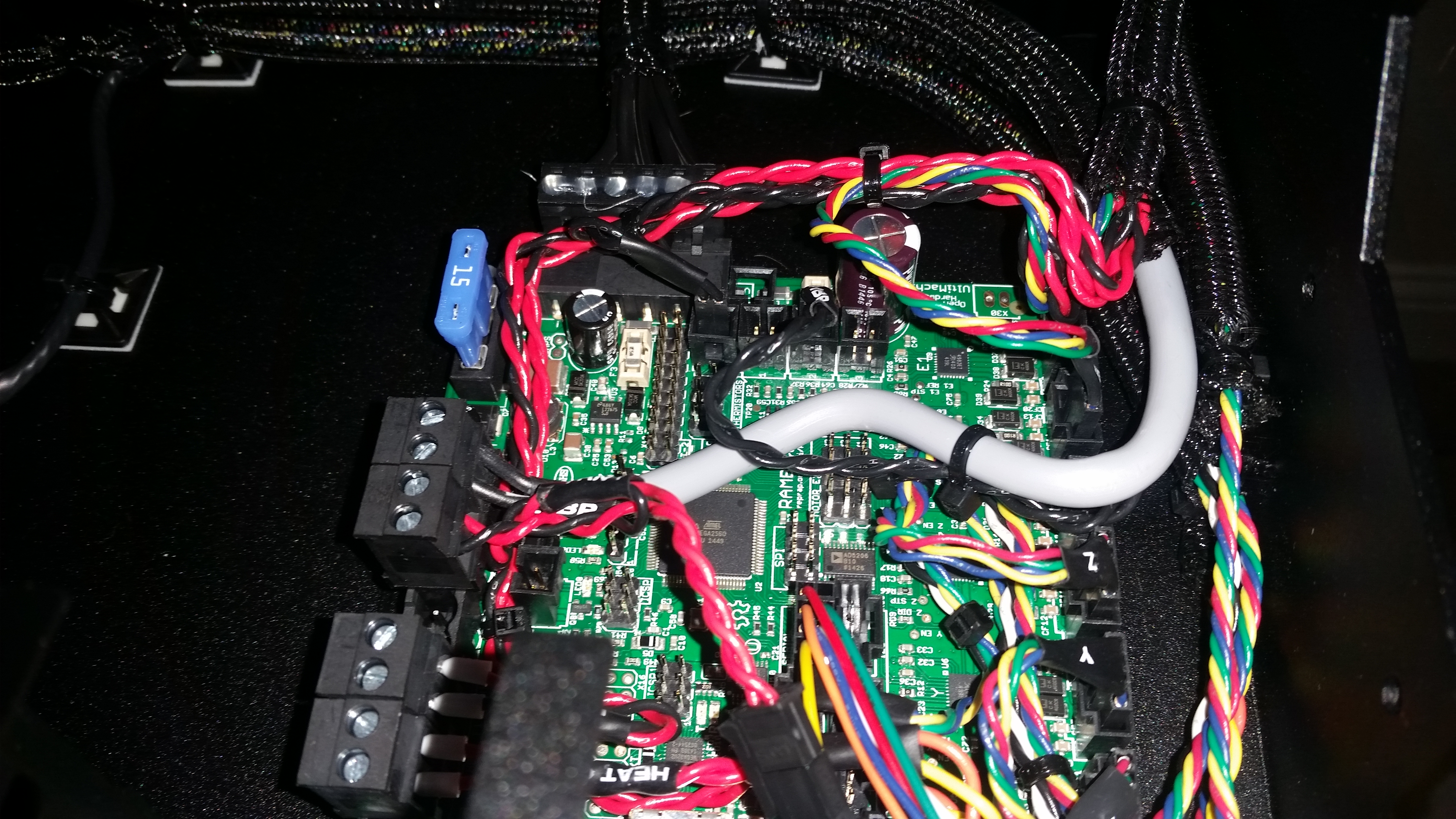

I will post a photo of the board, let me know if it looks correct

Re: What firmware do i re-install?
I can almost make out the individual transistors in the microchips
edit: the wiring looks good, something else is wrong. Get your multimeter and check for continuity between the pins on the thermistors at the harness (basically stick staples into the harness plugs with everything unplugged and see if each one reads a resistance between the wires). You should get comparable resistance on the bed thermistor vs. hotend thermistor, and they should both be like 80k ohms.
I will check it whenever i get back home. i am at college at the moment. if there is no voltage what should i do? I need 3d printing to start before the end of this month for business purposes...
Not voltage, resistance.
If the resistance between the two thermistor wires is not in the 80-100k range, then you have a short or your thermistor is bad. Contact MakerGear support, you should be under warranty.
