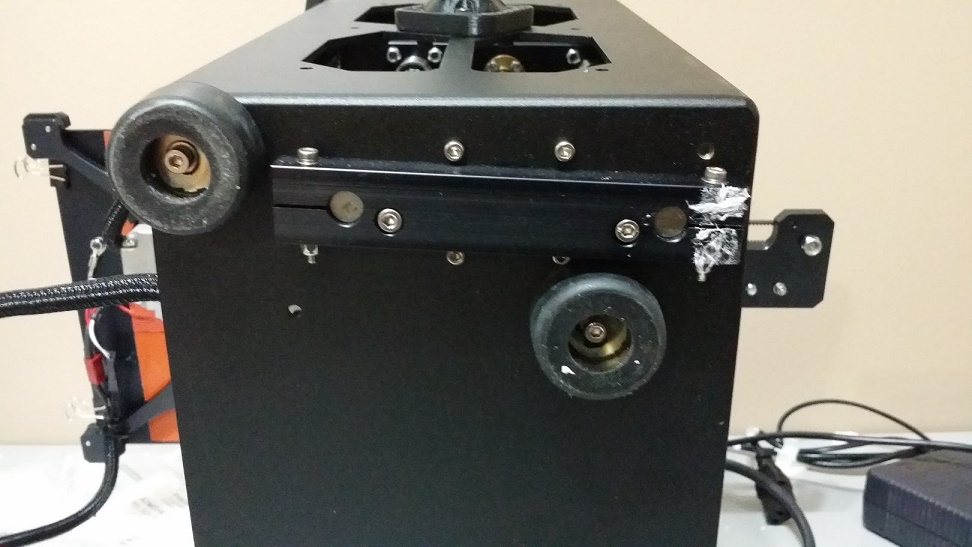

Sadly, no. I think it's related to this (jimc seems to be on the ball here)
Re: Y Axis Printing at an Angle
Post by jimc » Tue Jun 30, 2015 4:04 am
GOOD LORD! :shock:
Post by insta » Tue Jun 30, 2015 4:07 am
So, uh, how do I set it? I'm just using my 2mm driver between the Z bolts and the rod clampy thing as a spacer. I'm sure there's a more official way.
Post by jimc » Tue Jun 30, 2015 4:14 am
i believe if you find a copy of the older instructions for the kit there are instruction to build the printer from square one. z stage and all. mine came with instructions for that even though makergear assembled that. i didnt have too much trouble setting my red printer. i can tell you it wont be twisted like that. i cant believe the bed raised up and down smoothly like that. i would think it would have binded terrible. as the bed is raising its actually rotating around and causing your shift.

How the heck did that happen. Before I shipped it the z was smooth. Did I over pack it with foam? Or do you think vibration from shipping with a combination of loose bolts cause that? I packed that machine better then I have ever packed anything before(i'm sure you can agree it was pretty good). Maybe I overdid it?
Post by insta » Tue Jun 30, 2015 4:27 am
It did bind terribly, I could lift the entire printer by the Z stage. I think we're onto something here.
My other idea is just to loosen the bottom clamps, run the bed up and down a few times, and retighten them.
