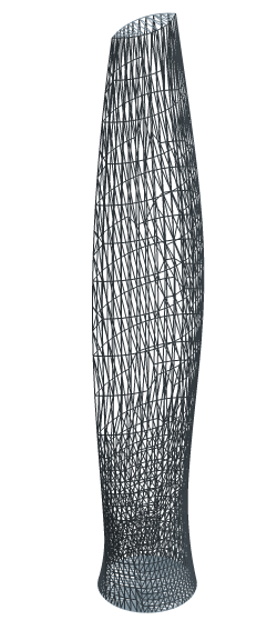

So I just checked the actual tessellation of the prop blade. It doesn't look too busy (at least to me). But it's something I'll keep an eye on for future models. I do rendering on the side, so high tessellation is just a habit :D

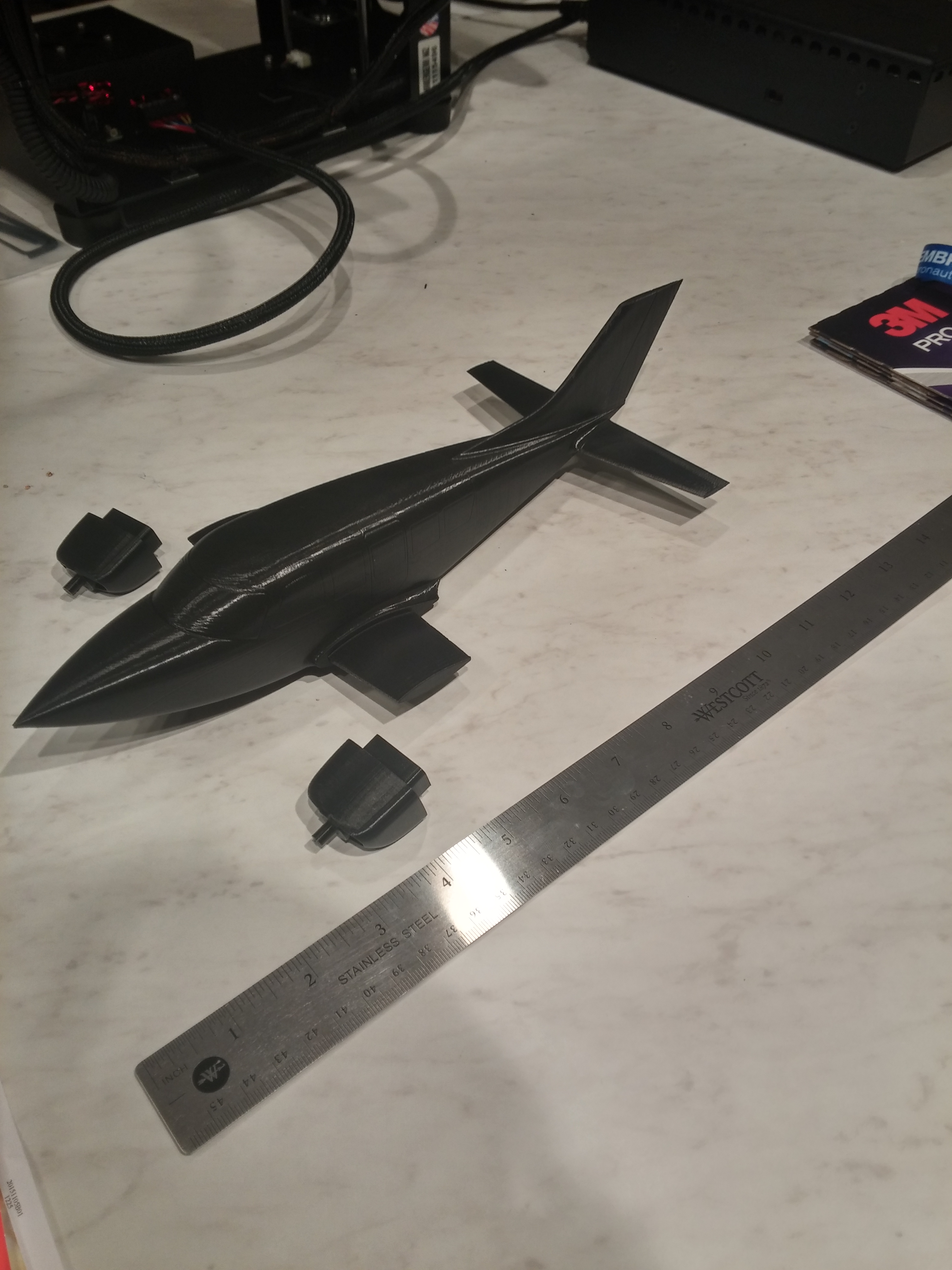

By the way, here's the rest of the plane I'm printing. Only the wings left to print. :mrgreen: It was my group's preliminary design senior project last year. I enjoy CAD so it was my baby for a semester. :lol:

ChrisERAU wrote:It doesn't look too busy (at least to me)
That's because your eye is calibrated for visual effects, not 3D printing! [grin]
If the prop blade is 25 mm long, then the chord is maybe 2 mm near the middle, so the total perimeter might be 3 mm or so. More than three dozen triangles along those nearly horizontal lines doesn't improve the results; I lost count long before that.
At the base, you have grossly exceedingly far too many excessive segments around that 2 mm circle. Two dozen would be plenty; you'll never see the difference beyond 16.
Really and truly, lower model resolution will avoid many, many subtle printing problems, without compromising the visual quality of the final plastic shape.

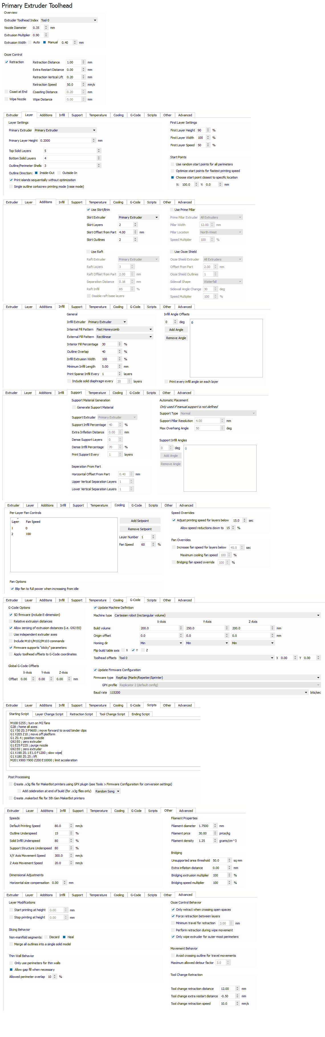

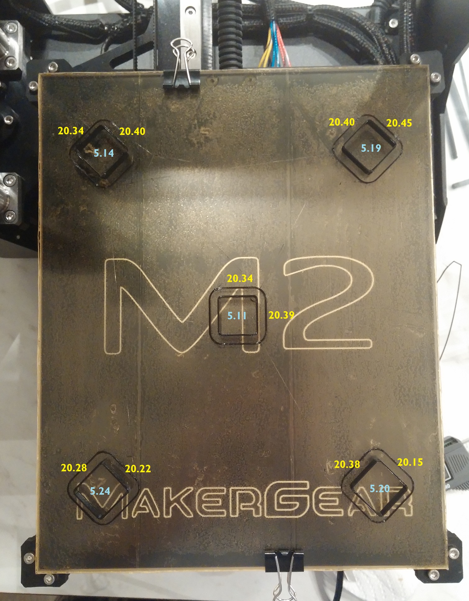

Squares printed pretty well, or at least as expected. The middle square had the best adhesion and the best first layer... and consequently the lowest height. The top left square was a close second, and the other outer ones were about the same: weaker adhesion and not quite squished first layers. I measured the thicknesses (in blue) and the sides (in yellow). Pics below. I also added my print settings. What can I do to minimize the apparent central bowing effect?
Edit: I forgot to add the wall thicknesses in the pic. They ranged from 0.7 to 0.85 mm. 0.8 mm was the most common thickness. I confirmed in S3D that the walls were one filament wide, yet they printed quite a bit over the expected 0.4 mm....
MakerGear M2 (24V V4 hotend) Medium Res.fff
(11.69 KiB) Downloaded 690 times

Post by ednisley » Wed Nov 18, 2015 3:16 pm
ChrisERAU wrote:at least as expected[/attachment]
OK, let's recalibrate your expectations, too... [grin]
If you've set the slicer to produce 0.40 mm walls and you're measuring 0.8 mm walls, then your settings are off by a factor of two: the walls should be exactly 0.40 mm. You're not going to get anywhere until the printer's extruded plastic matches the slicer's instructions.
Go through the Extrusion Multiplier calibration routine:
viewtopic.php?f=3&t=1964
Pay attention to measuring the actual filament diameter, because a factor of two error seems unusually large.
When you've iterated on that and gotten good results, slice & print another set of five thinwall cubes (which will now have exactly the right wall thickness), and measure their top-to-bottom height. That will lead you into the platform alignment fine-tuning routine:
Coarse:
viewtopic.php?f=3&t=2783
Fine:
viewtopic.php?f=3&t=3047
When you're getting exactly the right heights, then things should start looking better all over... honest!

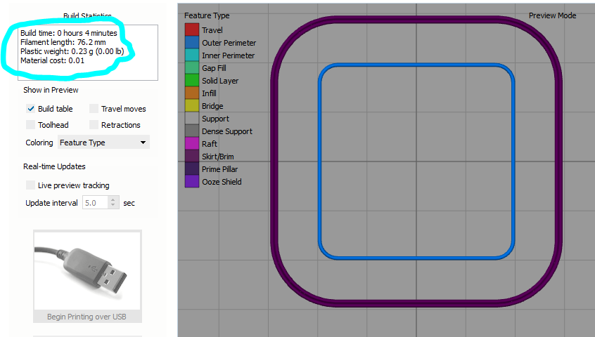

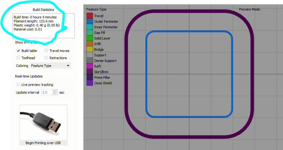

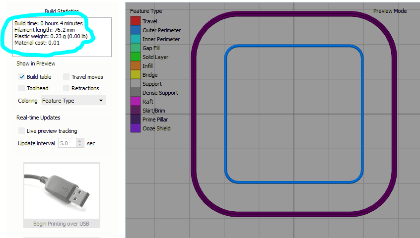

Perimeter only box, same as the ones I posted in the pic earlier. I did make a discovery, however, when preparing to do the extrusion calibration Ed mentioned. Someone said to "merge all outlines into a single model". When I did that, the print preview looked exactly the same as before, but the estimated filament weight and length usage dropped by about half. This implies that the walls will now only be 0.4 mm thick.
I then reprinted the square at 0.3 mm layer height, and sure enough.... the walls were now 0.44 mm thick. The height was 5.03 mm.
I reprinted yet again, changing only the merging parameter, and I get the 0.8 mm walls and 5.19 mm height like before.
Conclusion: Merging in S3D is very wonky. Now to run the extrusion calibration with merging parameters enabled!
EDIT: I ended up with an extrusion multiplier of 0.82. Is that normal? The square looked the same as the 0.44 mm thick one (0.04 mm is imperceptible just by glancing), so I guess yay, I get to use slightly less filament now?
