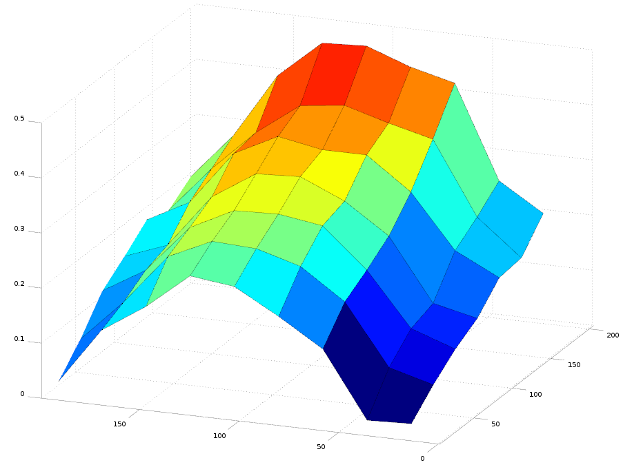

Matt_Sharkey wrote:We're talking fractions of a millimeter here. The x gantry probably bows a total of 0.10mm from center to edge. Y axis is also subject to this, but less, more like 0.03mm
Remind me to post the matrix of values I get from the Z-grid correction using the inductive proximity sensor and the Smoothieware firmware. It clearly shows the bowing in both directions, more in the X direction than in the Y direction, but clearly present in both directions, just as you state. The Z-grid correction is just wonderful. . . I don't have to shim anything, I just run the Z-probe routine and the firmware forever after corrects for all the bowing, in both directions, automatically.

Re: Build plate, high spot in the center...
Post by Tim » Sun Feb 07, 2016 8:43 pm
Tim wrote:Remind me to post the matrix of values I get from the Z-grid correction using the inductive proximity sensor and the Smoothieware firmware. It clearly shows the bowing in both directions, more in the X direction than in the Y direction, but clearly present in both directions, just as you state.
Here's a quick plot I made:
Plate surface profile, as measured by the Z-probe
All I did was to use the (Smoothieware) g-code command to save the probe grid data to the SD card, then read that into octave and plot it.
The Z-probe only works on a metal surface, so I have the Zebra plate under it, and the Zebra plate is pretty flexible and can easily get bent out of shape. This is a solution that causes the problem that it's meant to solve. Anyway, it's probably not very representative of a glass plate, but I wouldn't be able to get this plot for a glass plate using the Z-probe.
The bowing here has a maximum deviation of about a quarter millimeter on the X axis. This is probably because at the time I had a screw in the frame putting additional tension on the belt. I have since realized the problem with doing that, and removed the screw. The bowing in the Y direction is visible but slight, and the Y direction is dominated by a tilt that I did not bother to correct manually. In fact, I haven't touched the bed screws for a long time.

Tim when you print does it use this pattern of offset for the entire build or just the first layer.
