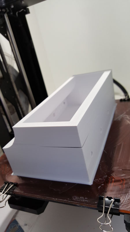

insta wrote:Why ABS or PETG? If it's not under heat, that looks ideal for some of the "+" PLAs. If abrasion is a concern, coat it with XTC-3D.
I was thinking that too, but I couldn't get the damn PLA to print without jamming the nozzle. I couldn't even get two rounds on the brim before it would jam, then I'd have to drill it out to get it working again. I'd blowtorch the nozzle, drill out the other tube with a 2mm bit and then print at 200 temp. I could extrude fine, but then I'd go to print and it would jam. Then once it jammed I couldn't even manually push the filament into the hot end. Something just gummed it up bad and twist drills up through the nozzle wouldn't fix it. I just got tired of screwing with it due to how long and annoying the whole nozzle recovery procedure is. I'm amazed PLA is supposed to be the "beginner" filament, I've had nothing but problems with nozzle jams every time I use it (which isn't often).
I'm throwing in the towel on ABS though. This part just can not be done in ABS. The warp, which is really just shrinking it looks like, is not just on the bottom but on the sides of the corners as well. So the face where the two halves are supposed to attach to each other is bowed and ruined. Also the image below shows a huge split I got on an ABS+ attempt, which didn't happen the first time I tried it. So there is no consistency on what degree it will fail.
But yeah, PLA was my original plan since it sands easy, doesn't warp, is very rigid and the RC airplane guys use it for their molds. But I'll be damned if I can get PLA to print without jamming. How fast can you print with PLA?

That part in the last picture I posted actually destroyed my 5 mil kapton sheet. It pulled almost 50% of it off the plate, and stretched it so bad in the process that there is no way it would ever lay flat again. What sucks is that Eckertech no longer seems to stock this stuff, which is a real bummer. That material is so tough you can clean it off with a glass scraper and never worry about ripping it. I've used thin sheets of metal to chisel parts off the kapton and never ripped it. Guess I'll have to settle for the 4mil stuff being sold on Amazon, I hope it is close to being as tough.
