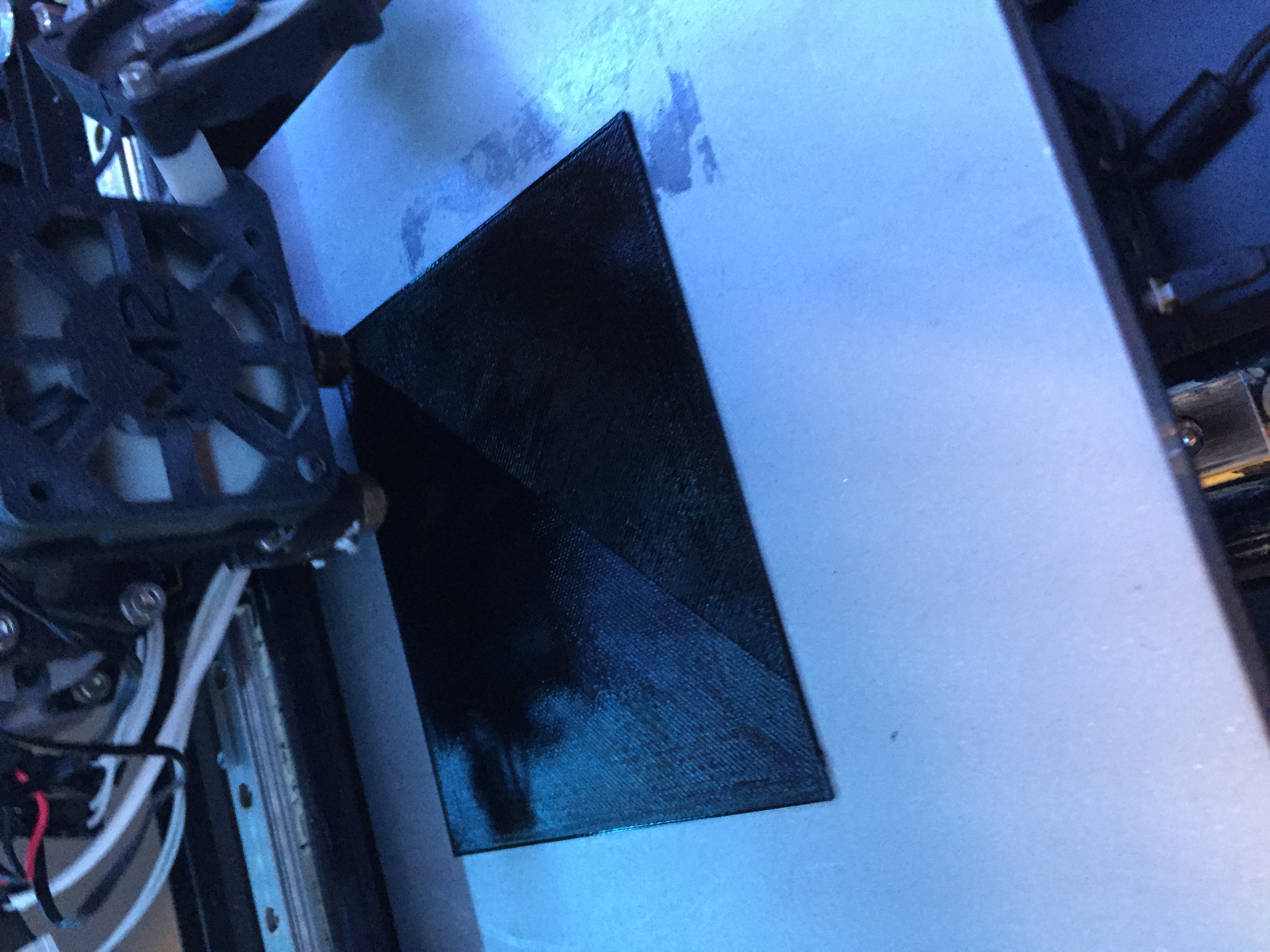

Regardless I'm getting a clean print now...I'll post a pic...

Yeah that looks good!

Here is the finished plate...notice the top is still not overly smooth
Does the Top Solid Layers affect this? Right now it's set at 3
