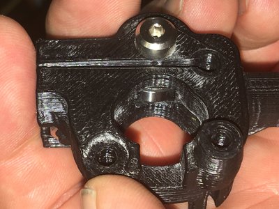

I went ahead and replaced the filament drive with my spare and the filament does not pouch out the front anymore. Printing now and will report back. Attached a picture of the problem one to see if anyone can see a problem with it. Has this ever gone bad for others on the forum? Do you salvage the tension screw and roller? I guess I could print this part but I have not taken the training wheels off for ABS just yet.

Only thing I can possibly see - you've got the tension on it so tight that the two top prongs appear to be touching. There should be almost zero tension on the Filament Drive. That gap between those two arms should be just about even from the bottom to the top. (But it might also just be the camera angle.)
Don't see any cracks or anything. Take the round wheel out and see if you can run a straightened piece of filament through the holes smoothly.
Re: Is This Practice Clogging My Extruder?
The filament runs through smoothly, so maybe the tension was just insanely tight and taking the path of least resistance. My new filament drive is running well and not anywhere near as tight. Thinking of keeping this on hand as a spare or maybe giving it another try when I have some time.

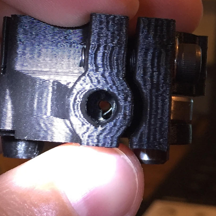

Having filament drive-related extrusion issues making it impossible to print. Motor is failing to extrude or retract filament without manual pushing/pulling assistance. I'm working with a brand new M2 (between 40-80hr printing since arrival 2wk ago) but have experience using an M2 day in, day out at work for months - never seen any filament drive issues there, so I'm lost on this one. The filament drive will grab the filament (Makergear black filament) but stops gripping the filament after about 10-20mm. I've removed the fans so I can watch the gears - upon loading the filament is moving rapidly from a happy midway position to a forward-bulging position, then stops gripping. Oscillating between extrusion/retraction on 10mm moves will also cause the filament to bulge forward. I've adjusted the tension screw to completely loose, and to pretty tight (top of drive housing almost touching) and the filament keeps bulging forward. (At a midway tension it will extrude a bit longer - say 20mm - before the filament bulges out enough that the gear won't grip.) I'm pulling my hair out because I have orders to fill including a wedding gift due in 10 days.

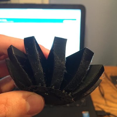

The only thing I can find is an odd-looking channel through the filament drive housing (see pic, top-down view) - I don't know if this is an obvious indicator b/c I've never taken an M2 drive apart before. (When this problem presents on a Makerbot 2x it's typically just filament buildup in the teeth of the filament drive.) It looks as though the filament has already worn away at the drive housing but the printer is so new and the filament pretty smooth, I am perplexed. Also included is a pic of the print on which the extrusion issue presented - some obvious extrusion issues there, evidenced by the hairy strandiness.
