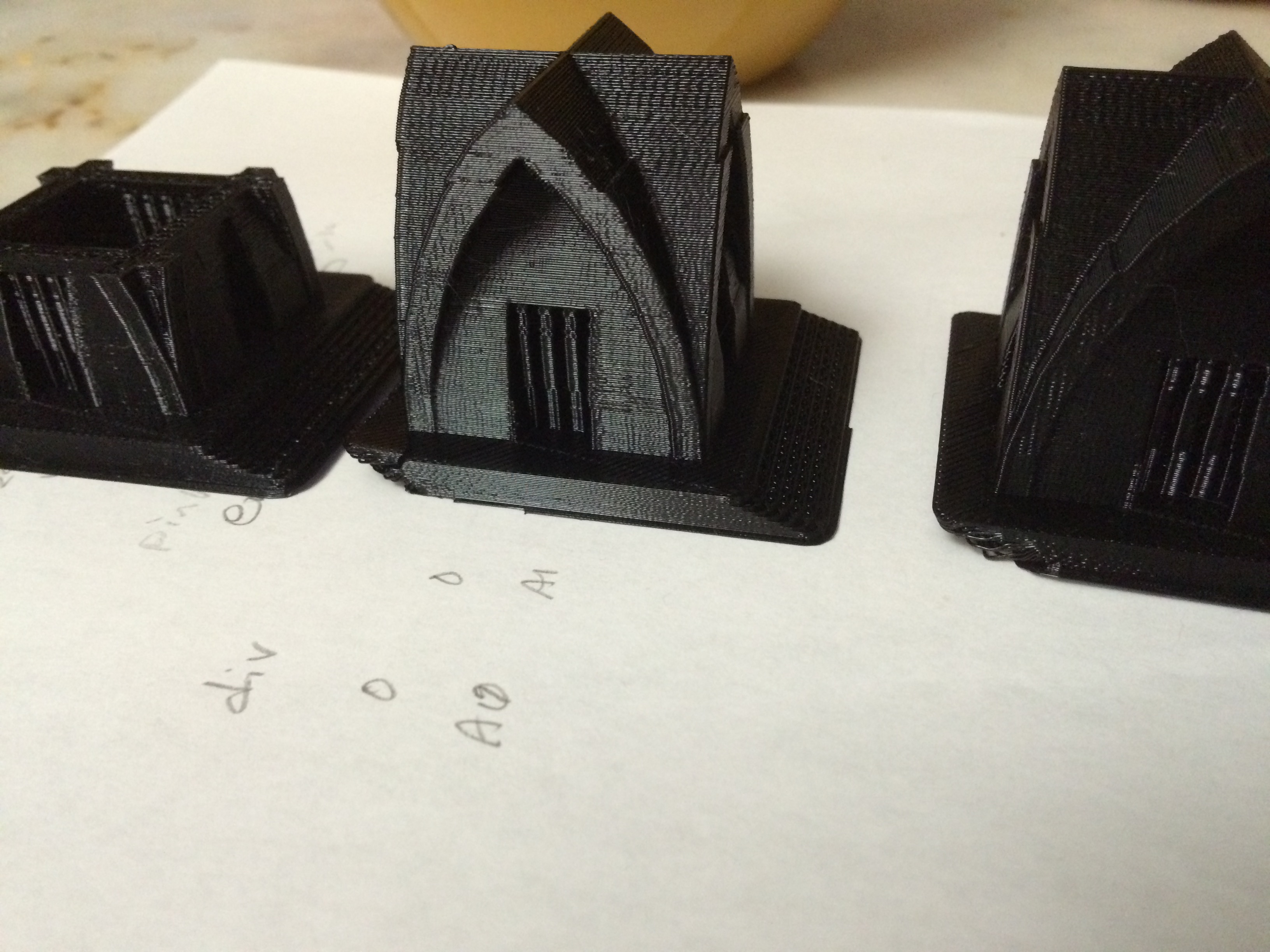

And finally the test objects; subtle variations in the shift, again only in the Y axis; considering running a test by placing one in each extreme corner of the bed and seeing what happens. All prints in PETG.

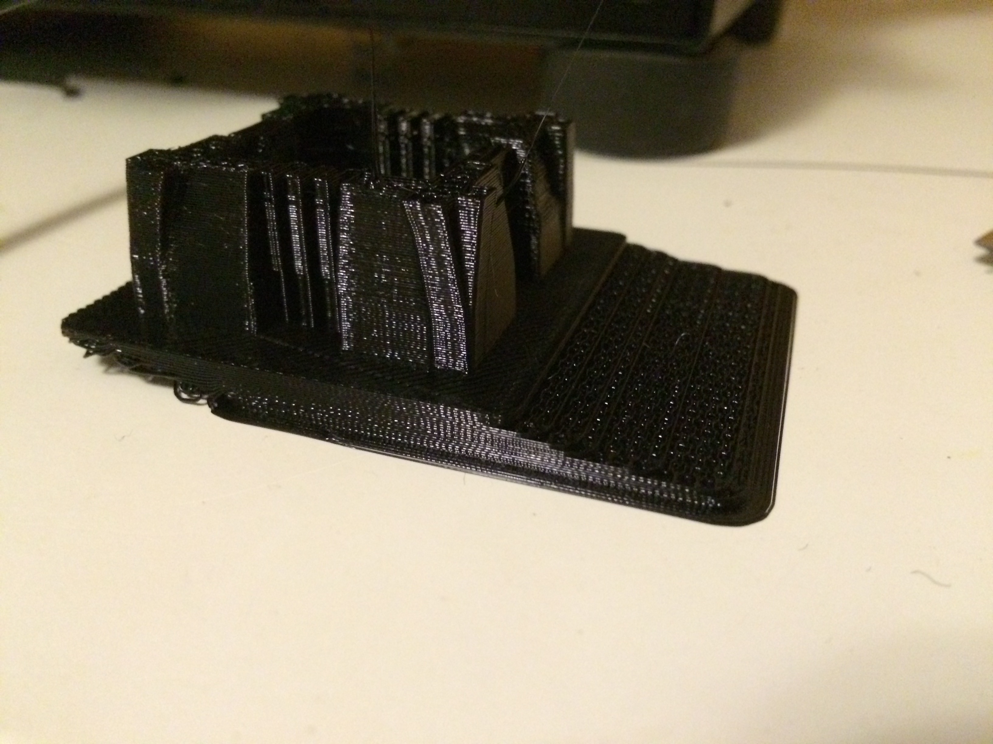

Printed the test object at the back end of the bed. The Y step was so bad that it was printing in air within a few layers.
When it happens, it is not between layers but on the first corner of the perimeter of a new layer-
Layer completes, Z step occurs, X move happens along the perimeter, then GRGRGRGRGRGT Y motor grinds (like the sound it makes when commanded past limit)!!! Not sure if this is due to accumulated error or introducing it; It has easily shifted 10mm while printing 5 in the Z axis.

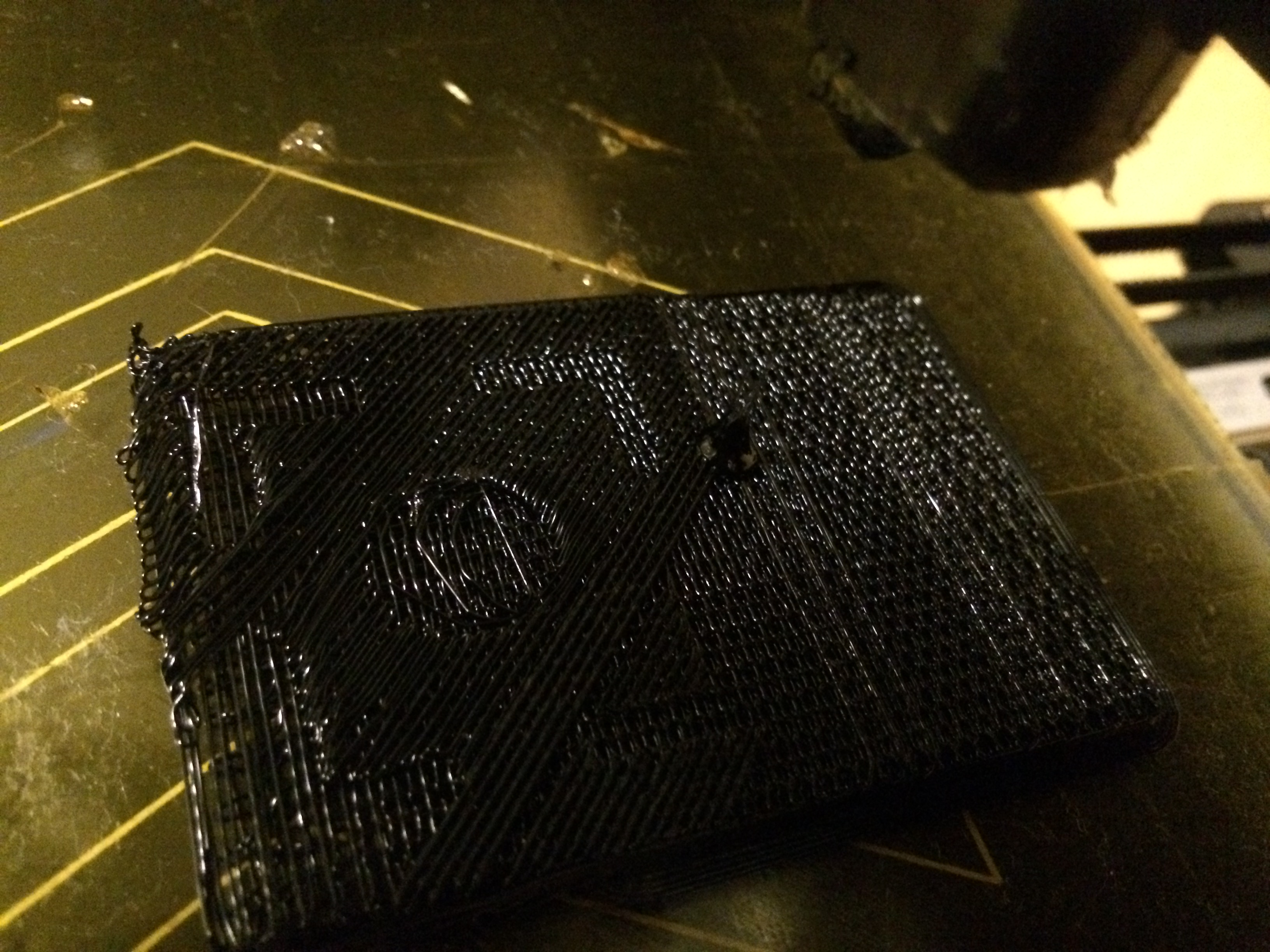

the test print at cancellation; I have video of the 'bbrrrrt' motor step; it's probably less than half a second, and it doesn't seem to change the position of the extruder relative to the print surface (jammed?). Gantry clear, all other print steps are fine and smooth.

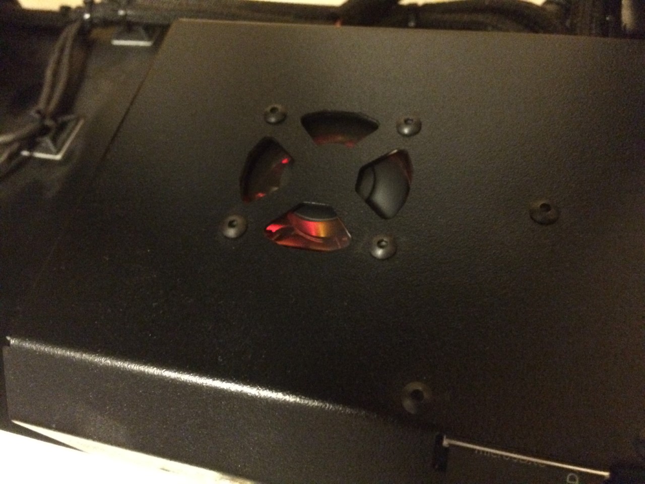

here's the glow from the board, flashing LED2; everything calmed down when I reset the USB by pulling out the cord. I'll start it again and see when that all lights up.
