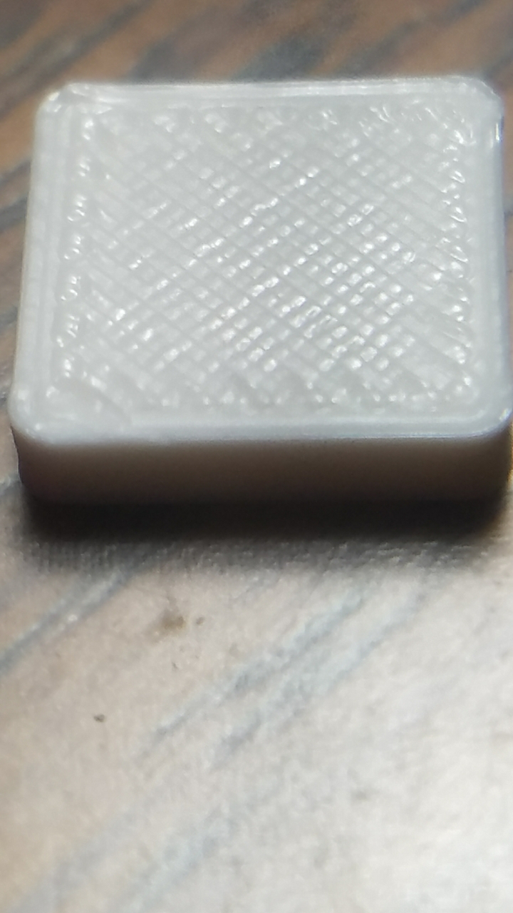

Attached are my 2 solid prints one is 26x26x2 and the other is 10x10x2
I have to admit the infill has no holes, but does have largish bumps at the end/beginning of the extrude (not sure which)
So is there room for improvement, tad tall around the edge 2.05-06 with the bumps.. micrometer tight on edge and not touching in center..
Not sure what to adjust.. or if it even needs adjustmemt.. :oops:
26x26x2
10x10x2

airscapes wrote:largish bumps at the end/beginning of the extrude
Now go tune your retraction.

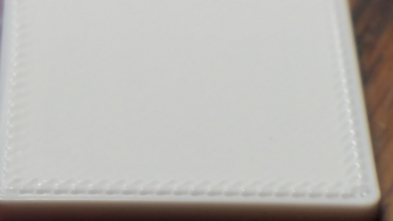

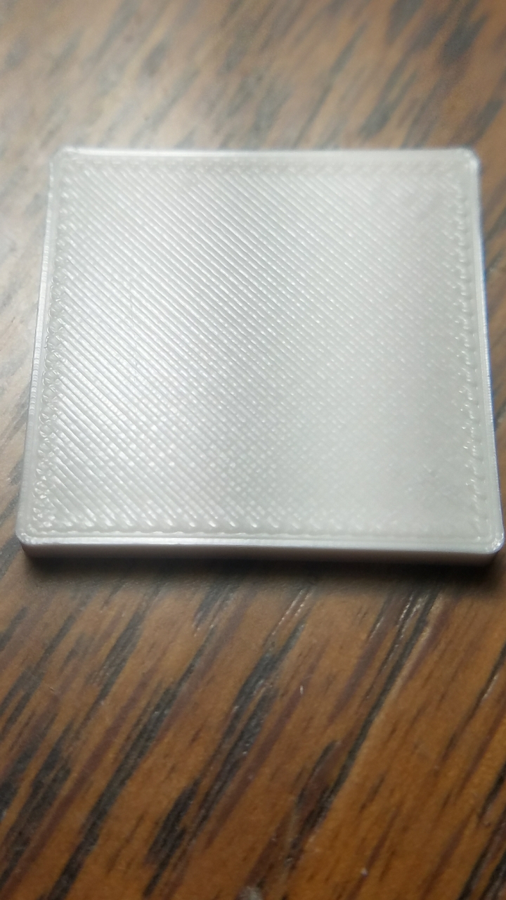

When I print my solid square 100% infill I get the bumps along the edges (nothing new been getting them since day one) where the infill meets the perimeter. There is one side that is the worst (highest) then one next to it is a bit better that the other 2 are good or very close to it. I have changed to .02 layer height and printed a solid .4 wide square (single layer) and height and thickness are good.
I have slowly one at a time adjusted the retraction distance up to the current 1.80, Extra Start distance -2.0, and retraction speed (set the other day for stringing) 4800. I also changed infill outline overlap from 15% down to 10% with little change.. What am i missing???

airscapes wrote:What am i missing?
Nothing: you're becoming a careful observer, which is all good!
If that's really 0.02 mm, then they layers are way too thin for anything other than bragging contests.
If it's 0.02 inch = 0.5 mm, then it's way too thick. Metric units are the default in 3D printing, so always specify inches if you insist on 'Murrican units.
If you're slipped a decimal point and it's really 0.20 mm, that's fine.
Remember what's going on: the extruder must exactly fill a sharp angle with a gooey blob of plastic squeezed out of a round hole. Getting a flat surface requires tuning:
  • Diameter & Extrusion Multiplier for exactly the right amount of plastic
  • Infill Overlap, so the round thread fits precisely
  • Infill before perimeter, so a single perimeter thread defines the joint
  • Probably something else I've forgotten
You've already measured & set the diameter & EM, so set the slicer to produce the infill first.
The Retraction distances (1.8 / - 2.0) seem excessive; return those to the defaults. Simple squares don't have much retraction, so they're not good test pieces.
Run off several solid squares with the Infill Overlap set to 0, 5, 10, and 15%, examine their differences, then pick the one you like best.
