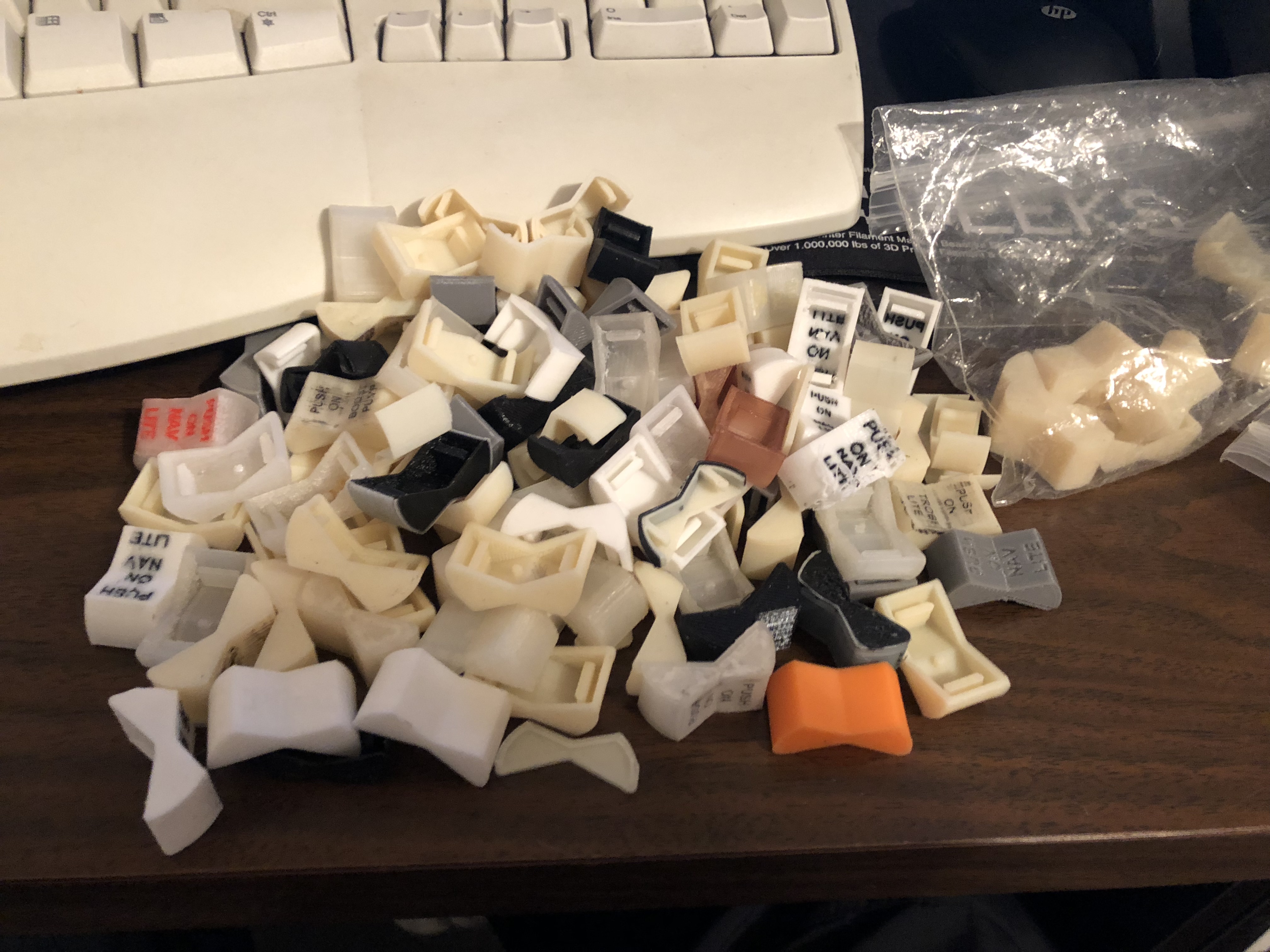

I paint, then laser etch the switch covers. I tried to print the lettering, but even with a 0.25mm nozzle, it just is not that great. It can also take a few trials and errors to get it all right, hence the pile. Fortunately, the local Innovation Studio has four laser cutters. At first I tried to cut the plastic, then paint inside the removed part. As you said earlier, too many small voids that the paint would fill and make a mess. I recently printed some in Glow-in-the-Dark PLA and painted them, but I have not etched the lettering, yet, even though PLA is not ideal for the environment.
I wanted to use nylon for the toughness and heat resistance, but someone on this forum suggested using an acetone-based paint on ABS. That does really well, and I think the paint actually strengthens the covers.
The silencers do erode, but plastic ones actually deaden the sound better than metal. I have been experimenting with BASF and TVF filaments, too.
