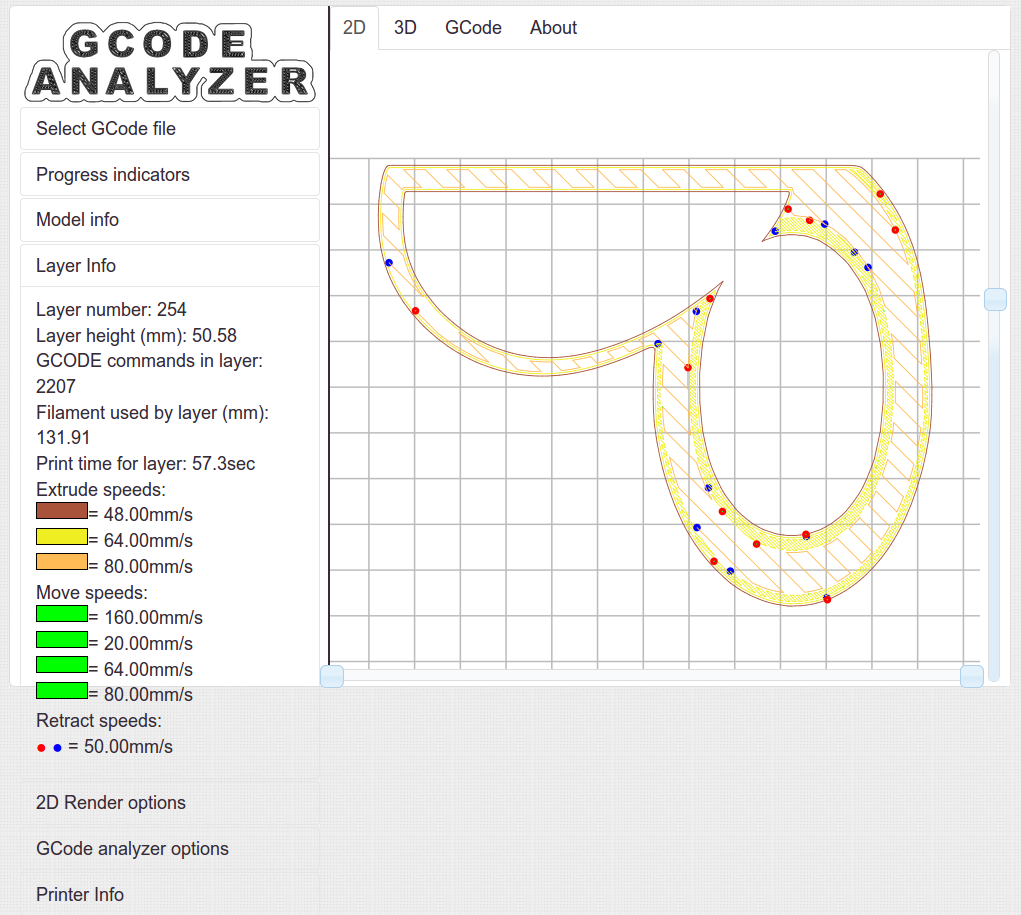

Here's the layer two down from the internal tail-body join:
Two layers below bridge
FoxxyBack - G-Code Layer 254.png (259.96 KiB) Viewed 14517 times

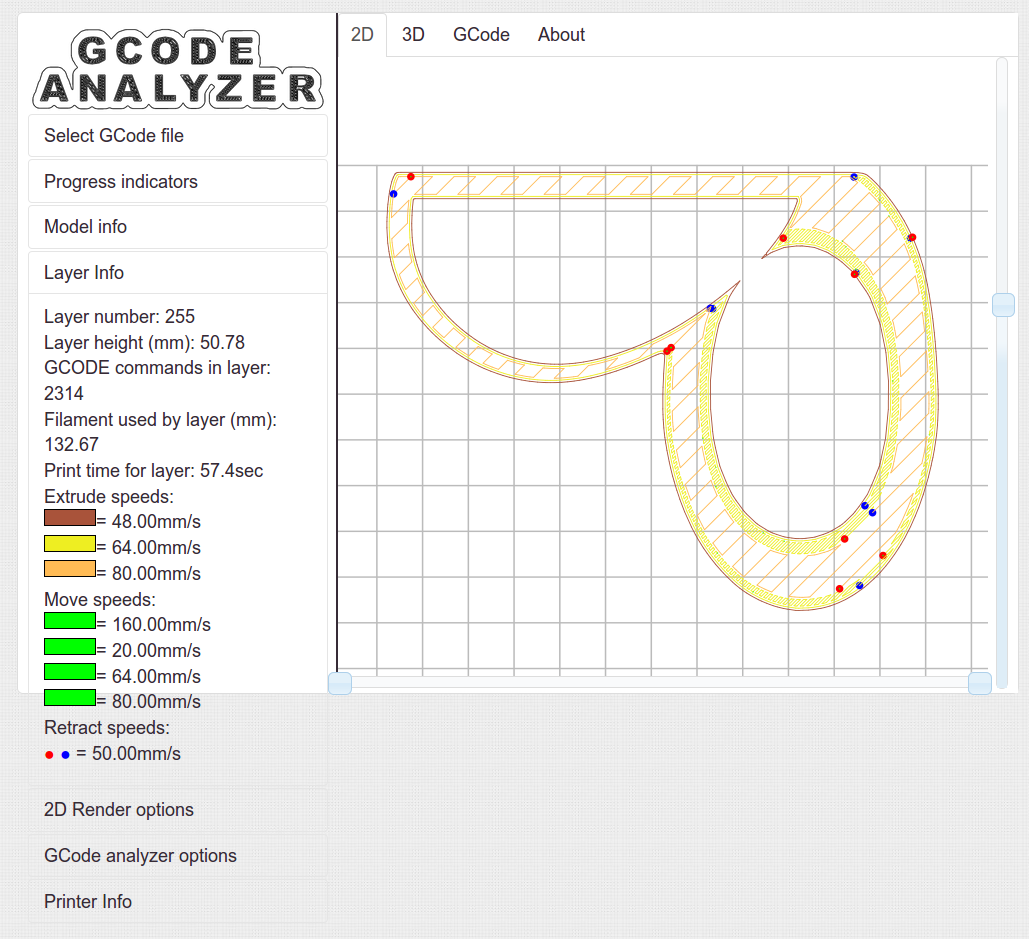

One layer below the bridge:
One layer below bridge
FoxxyBack - G-Code Layer 255.png (267.98 KiB) Viewed 14517 times

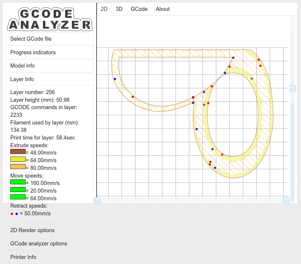

The bridge:
Bridge layer
FoxxyBack - G-Code Layer 256.png (257.28 KiB) Viewed 14517 times
Your M2 ticks along at a layer per minute, giving the plastic plenty of time to cool between passes. The sharp tips of those horns have an enormous amount of overhang on each successive layer, so the nozzle will tend to pull the thread back from the void and bend the tip upward, where it will cool and whack the nozzle head-on as it passes by in the other direction while bridging the gap. The impact with a cool and solid plastic obstruction repositions the loose-and-floppy hot end.
The same sort of thing happens just above the other gaps, but, to judge from the exterior shift, this looks to be the worst.
A rigidly mounted hot end whacking a large-enough discontinuity can stall the X / Y steppers and produce a layer shift, which is what we all thought was going on here. Layers due to lost steps tend to be inset on one side and protruding on the other, which isn't quite what your pictures show, but now you know what to look for.
The motors can also lose steps if the firmware applies more acceleration than the motors can deliver, which happens only if the acceleration settings exceed the hardware capabilities. You (well, I) generally figure that out when a seemingly harmless model fails at the same point, without any other plausible explanations. The only cure is to back off the XY acceleration by factors of two, but that's not called for here: we see smoke curling out of the barrel.
