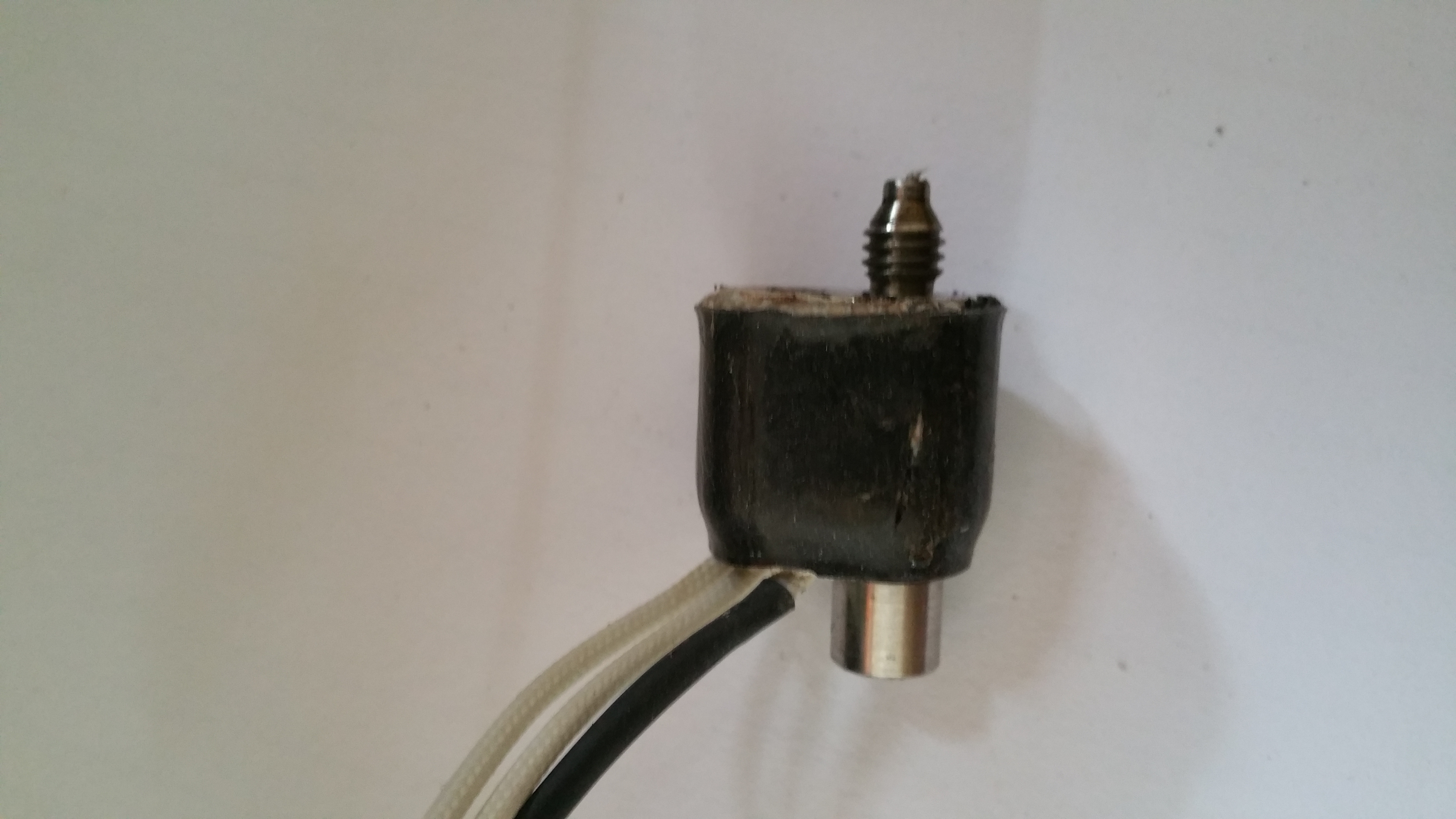

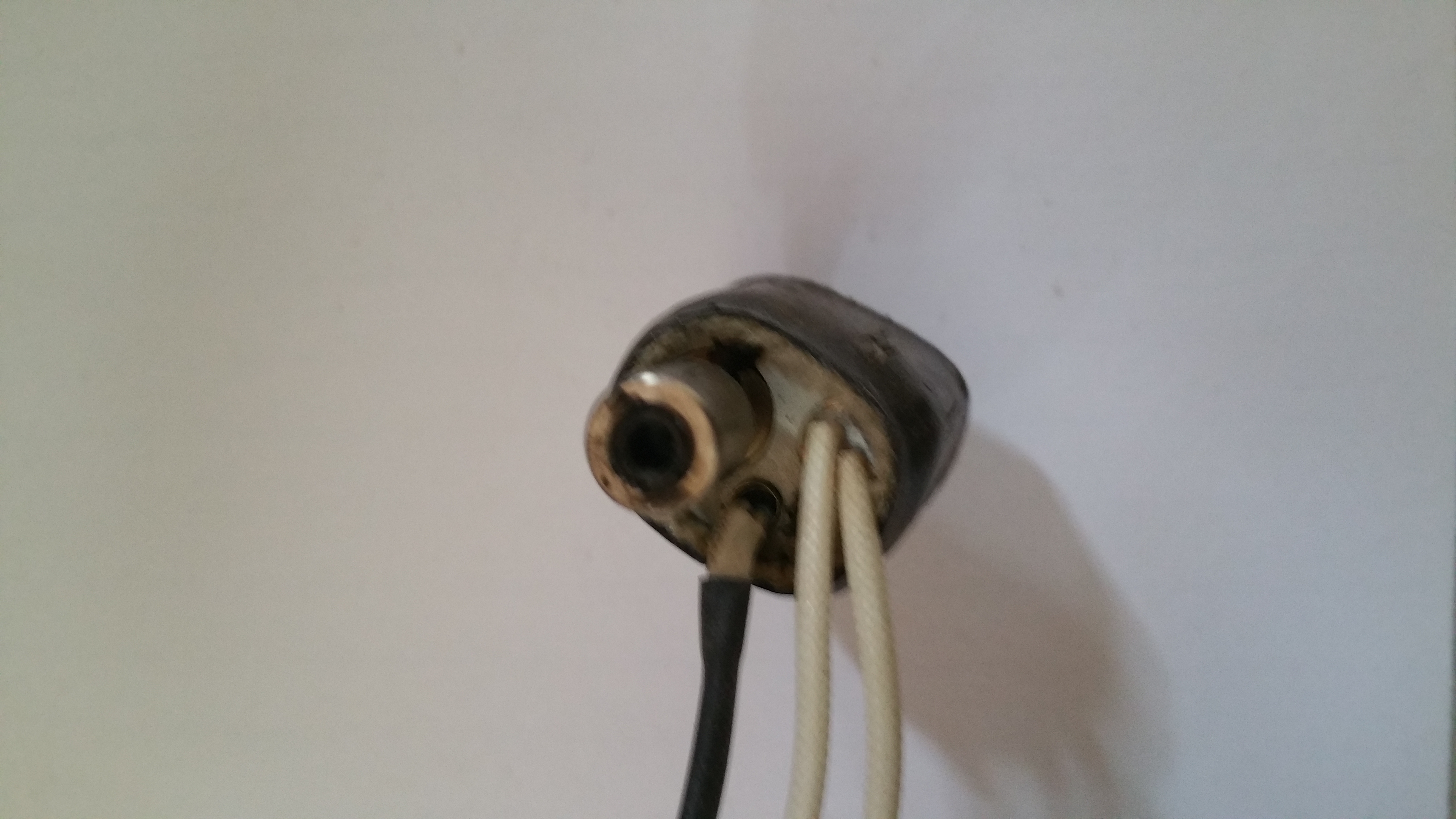

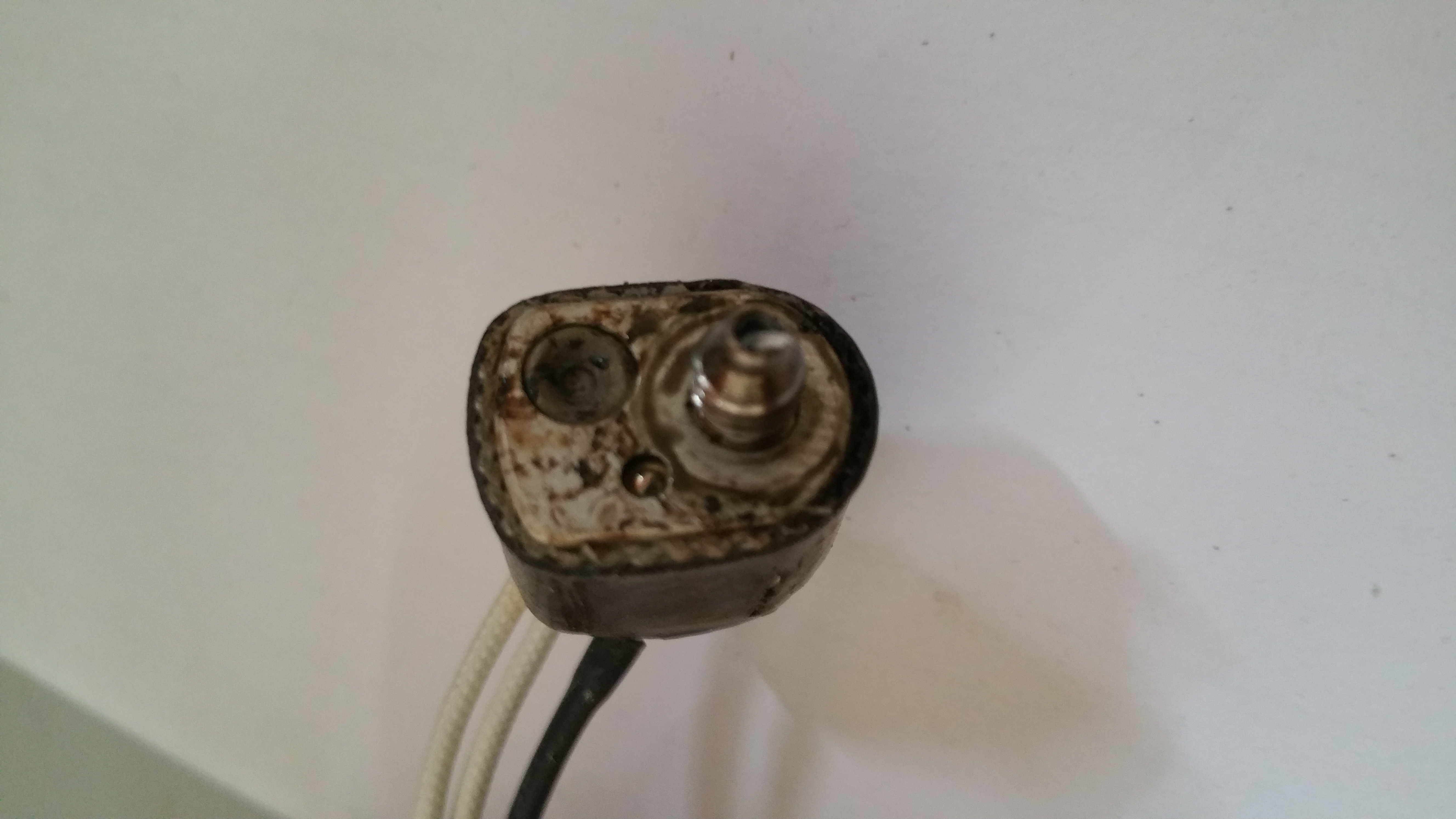

Re: Installed a new 30mm nozzle and its a mess!
Ok hope these show you what you need to see:

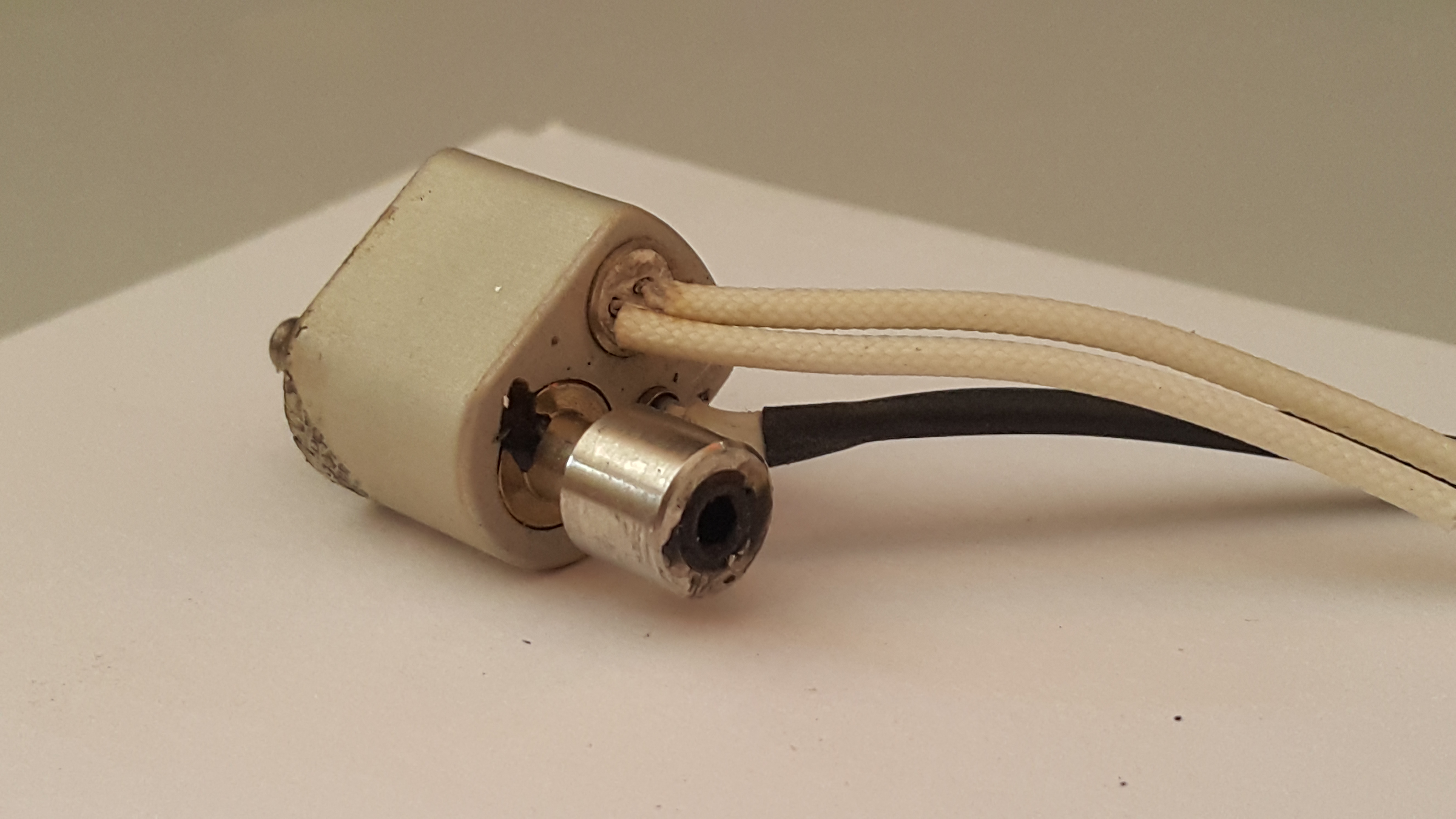

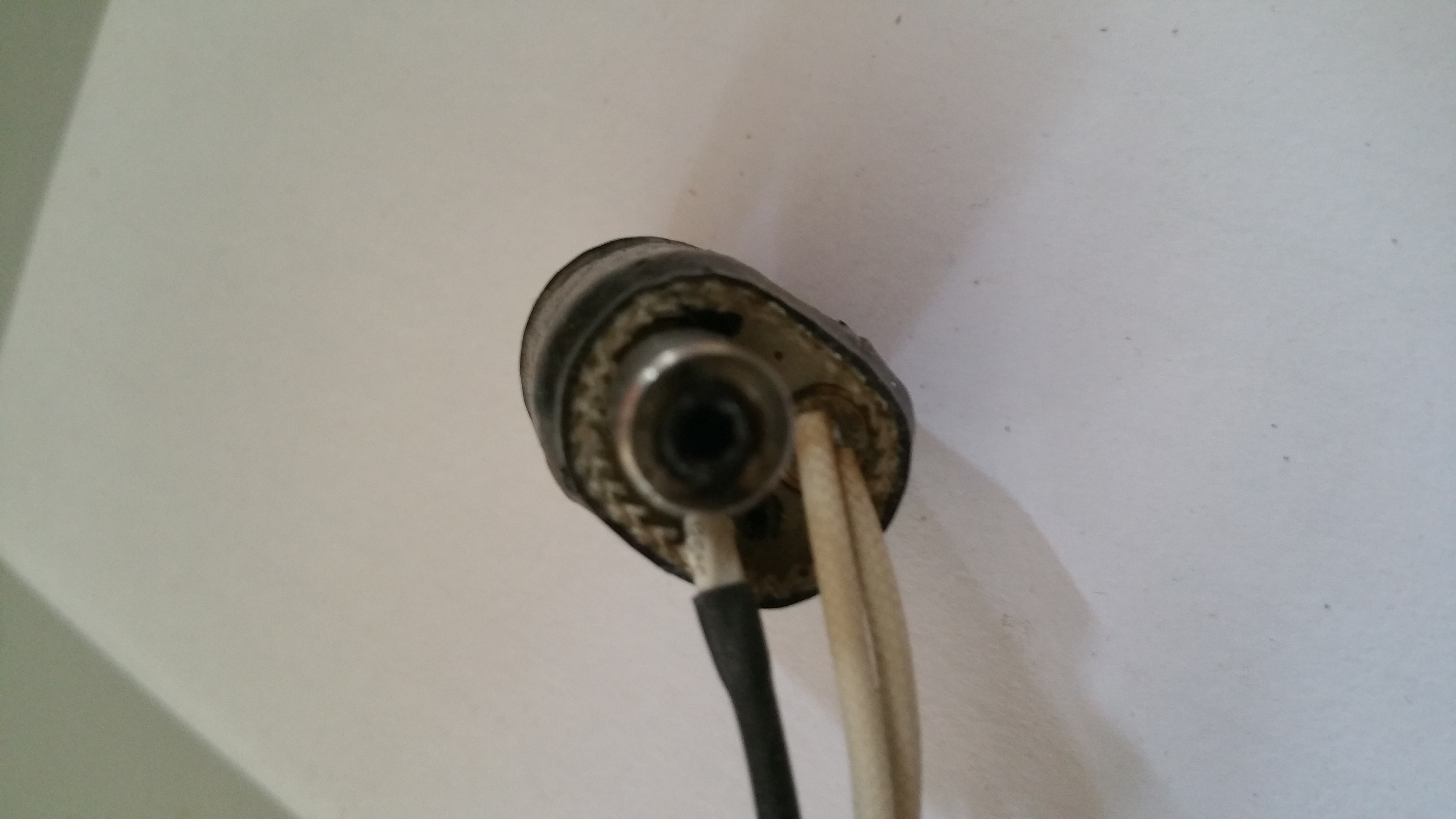

Need a bit more of a close up:
Lay it on it's side, like the first picture, but take the cloth cover off (it just slides off) and take the picture of the end that has the wires coming out of the top.
It's hard to tell if that is filament or just the angle of the picture.
I need one from this angle:
