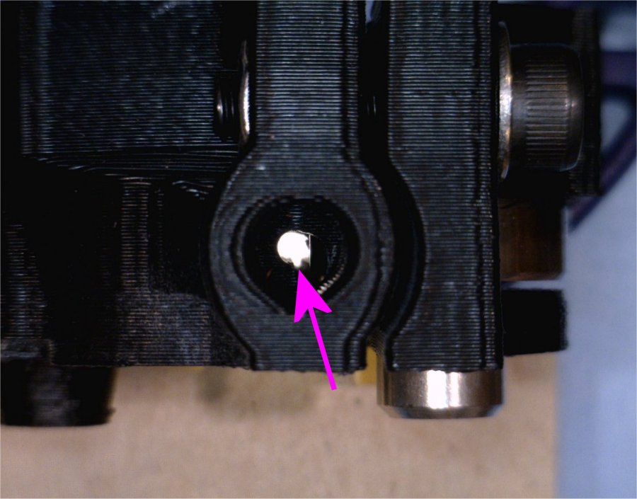

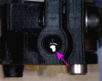

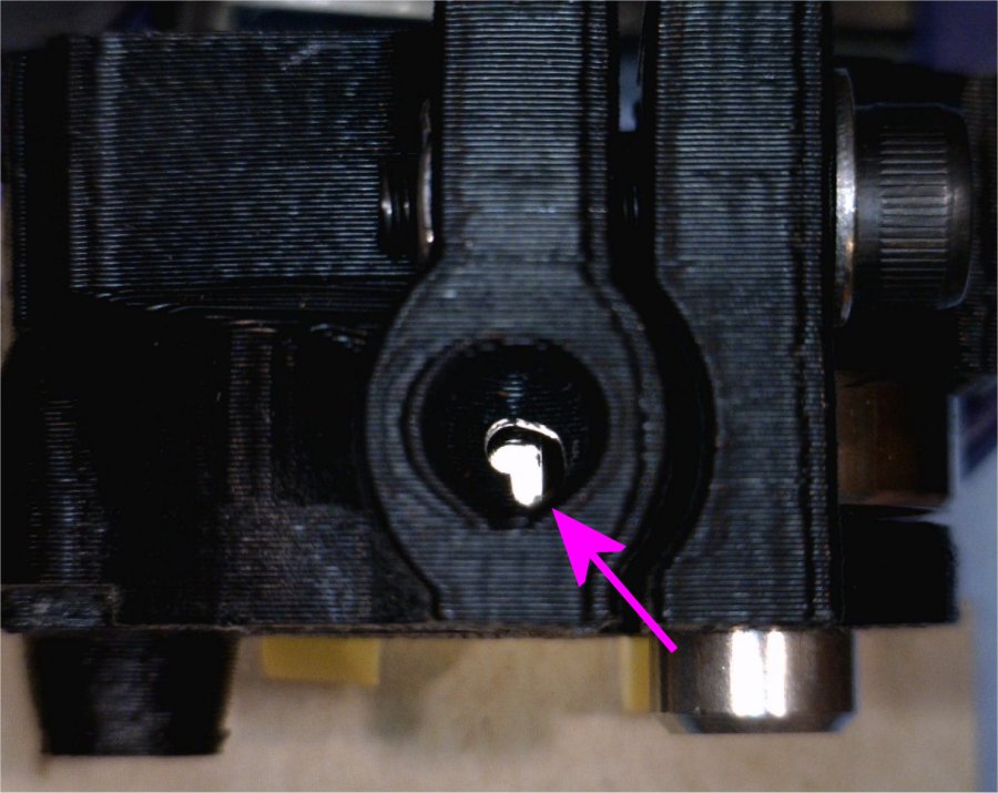

Well, I got my new drive from MakerGear, and installed it last night. Once I had the old one off, I could see the problem. Because the drive gear was too far back, probably combined with twisting of the bearing due to the offset support, the filament had been pushed forward inside. It wore a large groove in the top section of the drive:
and a slightly smaller one on the lower end:
All of this was happening inside the drive, where it was impossible to see without taking everything apart. Basically, the filament was coming down, and bending around the front of the drive gear.

Moving the filament drive gear forward helped. You want the filament path to be centered on the gear. Unfortunately, by the time I discovered that issue, the plastic drive housing had already been worn so that it was still possible for the filament to go off track. Replacing the drive housing fixed it, and I expect it to last a lot longer than it did originally.
