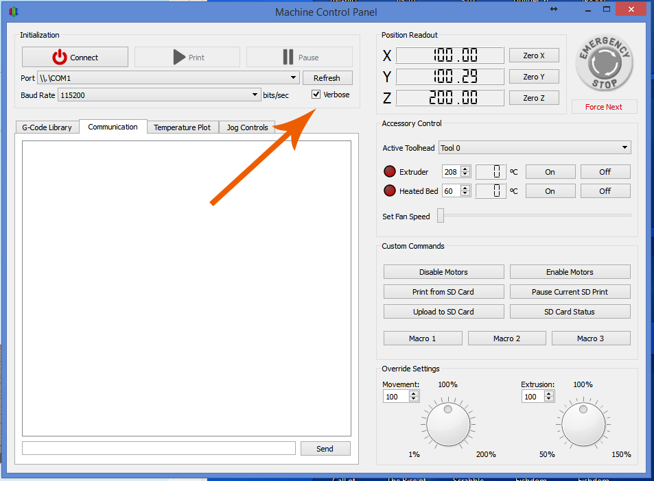

Next time it happens, copy the final commands and post them here so the guys can take a look. Just leave S3D open on the Communications tab while the print is running over USB.
(Make sure you have Verbose checked in order to see them all.)

Jules wrote:Next time it happens, copy the final commands and post them here so the guys can take a look. Just leave S3D open on the Communications tab while the print is running over USB.
Thanks, I do have verbose checked, however it seems these message run off..I'm not sure how long the buffer is for these...
