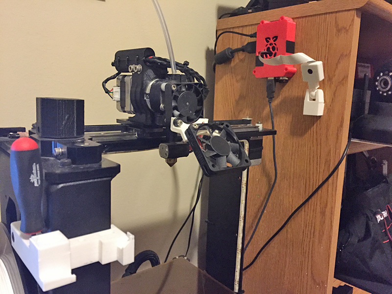

The main benefit for OctoPrint, for me, is that I don't have to worry about whatever happening on my desktop affecting my print. I have some external USB drives hooked up, and when they spin up because I've clicked on the Finder, or a backup is starting, USB serial communications will pause until it's finished spinning up, causing a blob. I've also hooked up a webcam that streams through OctoPrint, which is good enough to see if a print has failed. I can check in on it from wherever and stop it if something's gone wrong.
