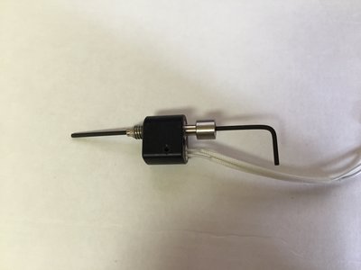

This is the smallest hex wrench - running all the way through a V4 hotend that doesn't have a nozzle on it. It should clear out the barrel almost entirely.
Make sure you have it going straight into the hole - and don't force it in quickly. Gentle slow push.
All you want to do is push out some softened plastic - if you hit a lot of resistance - stop.

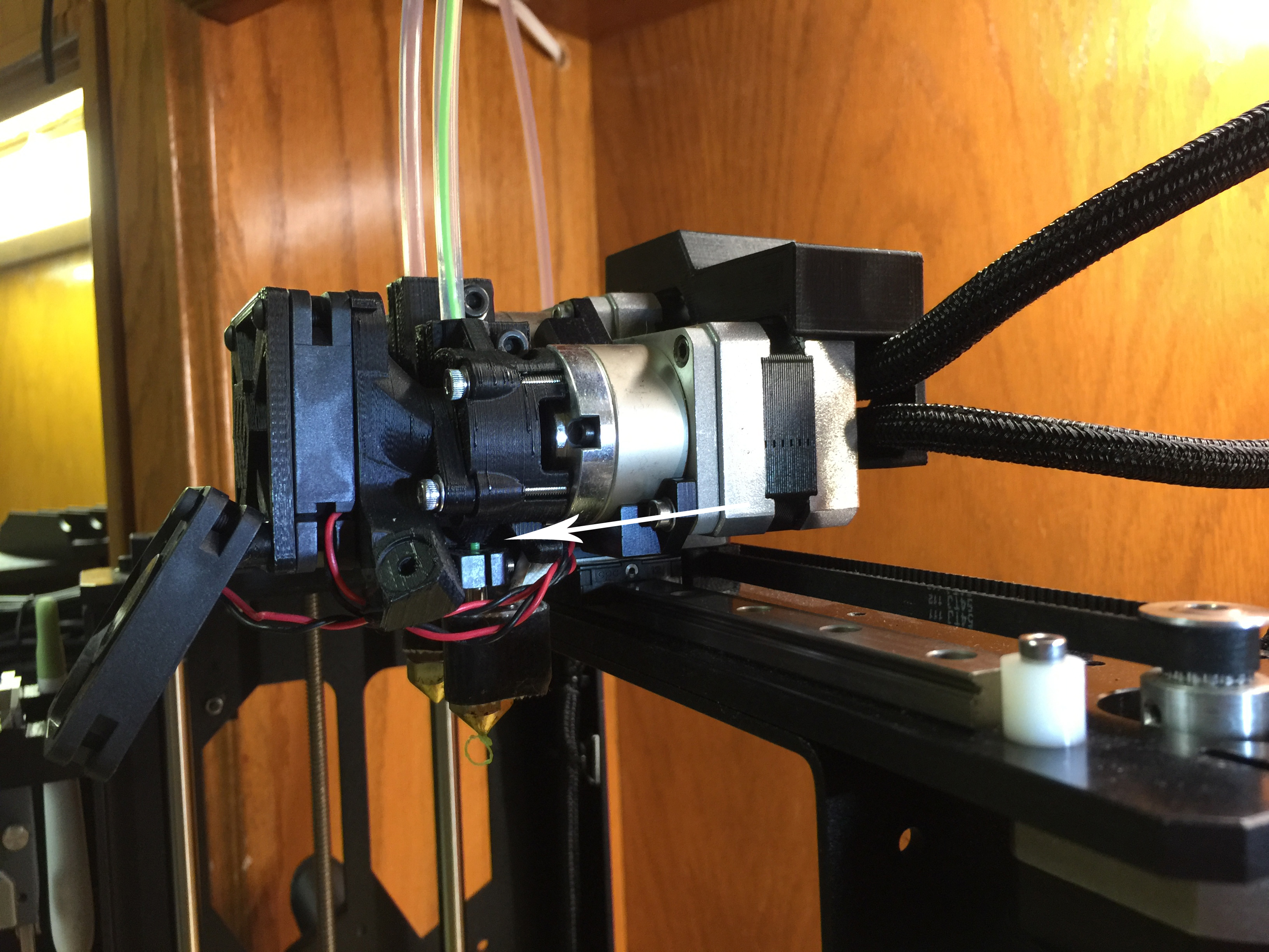

Get down at eye level when you seat the clamp and make sure that you have the holes lined up so that the filament is going directly into the top of the hotend. You will be able to see it going in in the gap. Just advance it about 10 mm at a time until you see if it is going into the hotend, or hitting on the side of the hole.
(You can adjust where the hole is by tightening/loosening the clamp a little and you have to be kind of delicate about it.)

Pull up a chair and sit down where you can see the top of the hotend as it sits in the clamp. The top of the hotend should be just about level with the top of the clamp.
The filament comes out of a hole in the black plastic filament drive above, and then should go straight down into the hole at the top of the hotend. If you get down at eye level you can see it. (It's the only place you can.)
If the holes are out of alignment, the filament will get stuck and not go into the hotend.
If you have any colored PLA other than black you will be able to see it, otherwise it's pretty tough. (working on a photo)

Here is a picture of green filament going through the holes. (coming out of the filament drive and going into the hotend)
If you get in really close with a flashlight, you should be able to see it from the side.
Unless you have the dual, your filament drive is going to look different than that. Yours should be much easier to see from the left side.
