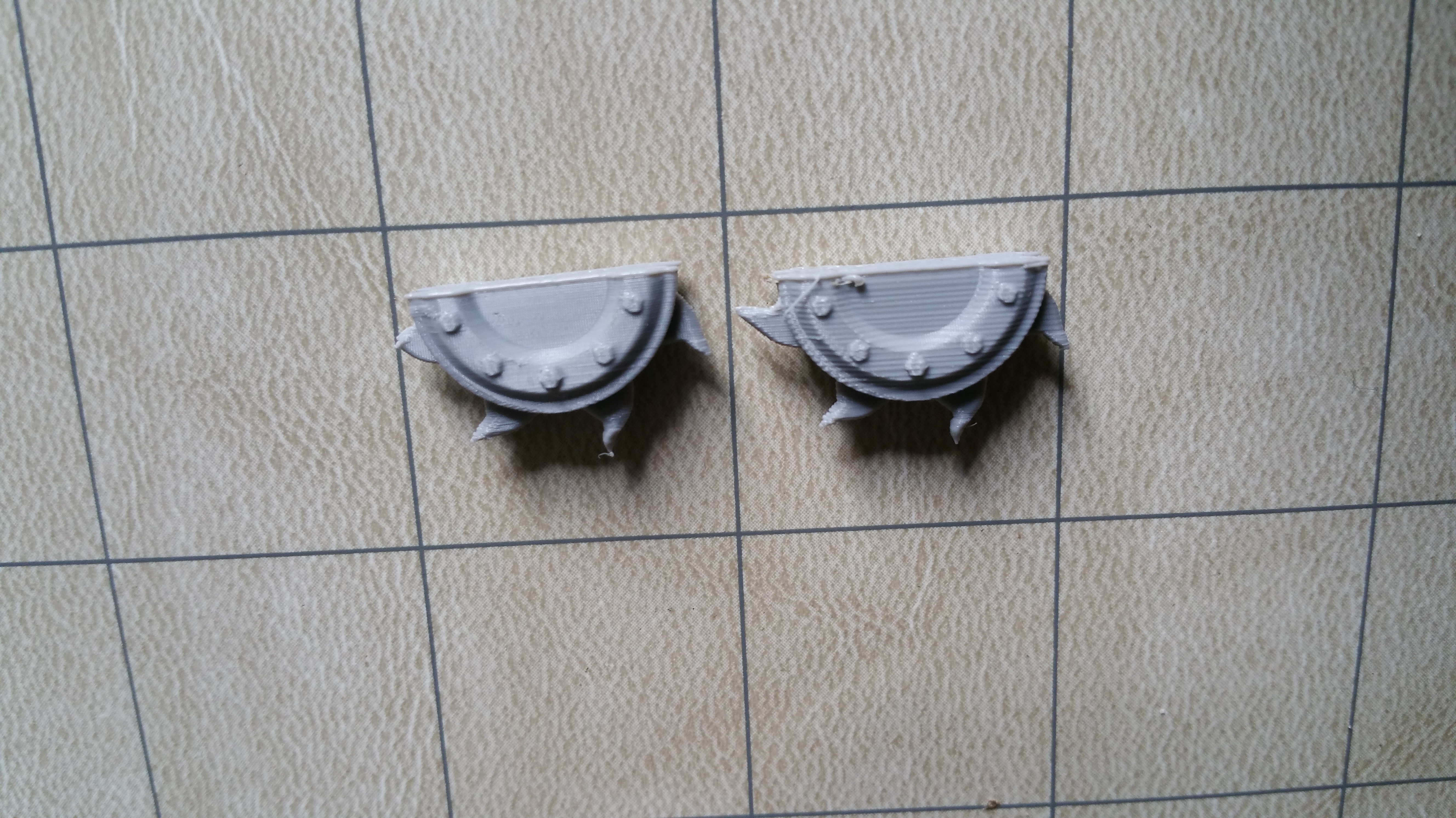

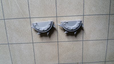

BTW I printed these over the weekend and I had complete success with the 2nd and then as you can see in the 1st one the lines/banding is back.
I printed both in the center of the bed at 100 microns and both at 190F and 60F for the bed.
I dont believe I changed any settings if I did it was the Infill maybe from 15% to 30%...but thats it for sure.

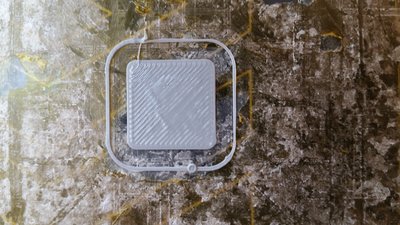

Ok here's the square on the bed with only a single layer printed:

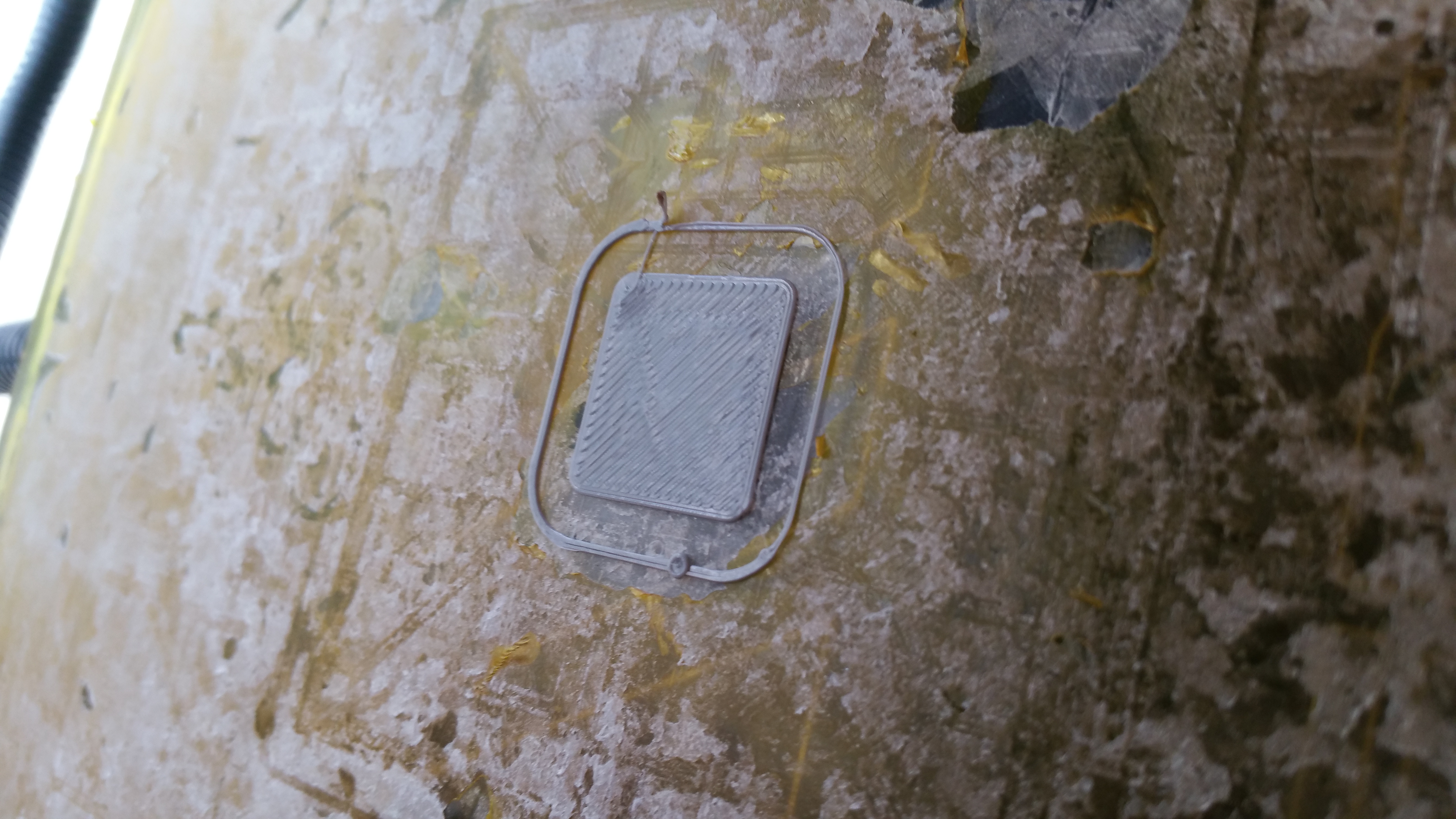

Same but different angle:

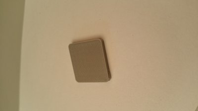

And here's a entire square printed and removed from bed:

Post by Jules » Mon Aug 29, 2016 4:32 pm
wisdomknight wrote:BTW I printed these over the weekend and I had complete success with the 2nd and then as you can see in the 1st one the lines/banding is back.
:roll: I have decided that I am four hundred kinds of an idiot......are you trying to print all of this stuff at 100 microns layer height?
Change your layer height to 0.2 mm if you have a 0.35 mm nozzle, and your extrusion width to 0.4 mm. The banding will go away. Do not go below 0.18 mm layer height with a 0.35 mm nozzle.
There is a relationship between nozzle hole size, extrusion width, and the minimum layer height with 3D printers that is discussed briefly in the Beginner's Guide.
Set your Extrusion Width to be wider than your nozzle hole size, but less than the OD of the flat face on that nozzle. (This gives the machine correct control over placement of the thread.)
For a 0.35 mm nozzle: Correct range is from 0.35 mm to 0.50 mm
Set your Layer Height according to the following formula :
Extrusion Width/Layer Height is greater than or equal to 1.8
Example: With a layer height of 0.20 mm the formula reads 0.40/0.20 = 2.0 which is greater than 1.8.
You could also use 0.50/0.25 = 2.0, or 0.36/0.20 = 1.8.
The reason for this is to give a slightly squashed layer to give better adhesion, and layer bonding. Any ratio that comes out below 1.8 is going to start causing adhesion and bonding problems.
(And if math isn't your thing - just set your layer height to be half of your extrusion width.)
