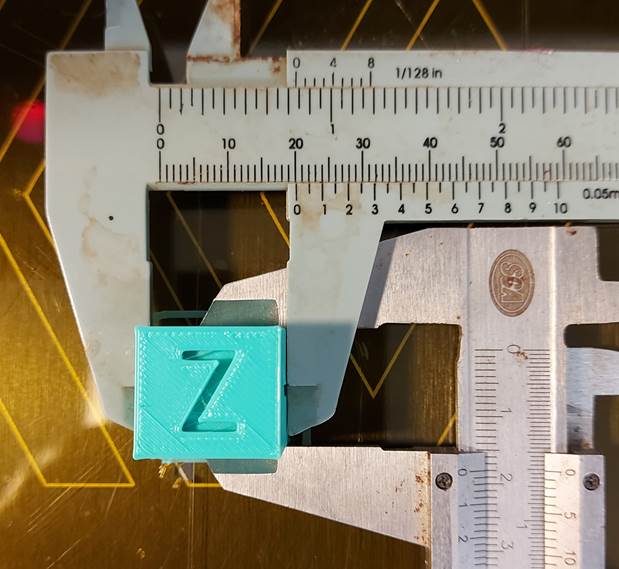

My Makergear printer M3-se has been printing the y-axis about 10% shorter on the y-axis than is in the original 3D model and
Gcode.
I also printed the same Gcodes on a M2 printer to double-check; they printed with the correct proportions. These tests included the x-y-z 20mm calibration cube https://www.thingiverse.com/thing:1278865. It printed 20x18x20 mm on the M3 (18 mm on the y-axis).
Any ideas? Do I need a new Raspberry pi. A new Rambo board?
Has anyone heard of this happening before now?

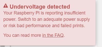

- undervoltage.JPG (21.67 KiB) Viewed 60661 times

The M3 reads: M92 X80.10 Y80.10 Z1007.70 E471.50 with the M503 command.
So it doesn’t appear to be a software problem. However. I did about 5 tests and checked several other recently printed parts. All are consistently off by about 10% on the y-axis. The triangular 45-degree tests are fine. When finished with the print and the print moves back down, I do hear a grinding noise as if the motor is slipping on possibly the y axis.
It is a 1.5-year-old machine without a huge amount of use but I just put in a brand-new motor for it. It sometimes stalled on the y-axis and it was not that easy to move along the y-axis when off. It now moves back and forth smoothly when off, so the bearings and tension are probably fine.

It's possible the motors have different step sizes, and you got one that is mis-marked. If it's was working before & the motor hasn't changed, then it sounds like the drive current from the electronics may be too low. The low-voltage warning on the Raspberry Pi might be important.

The low voltage warning, which Makergear support says to ignore, wouldn't have a bearing on the M2 printer since it doesn't use a pi. So it must be the motors.
