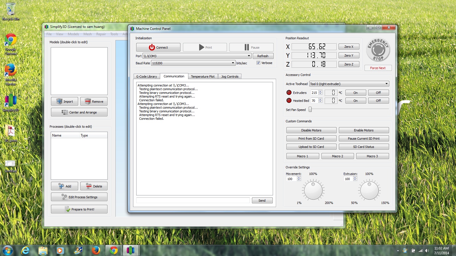

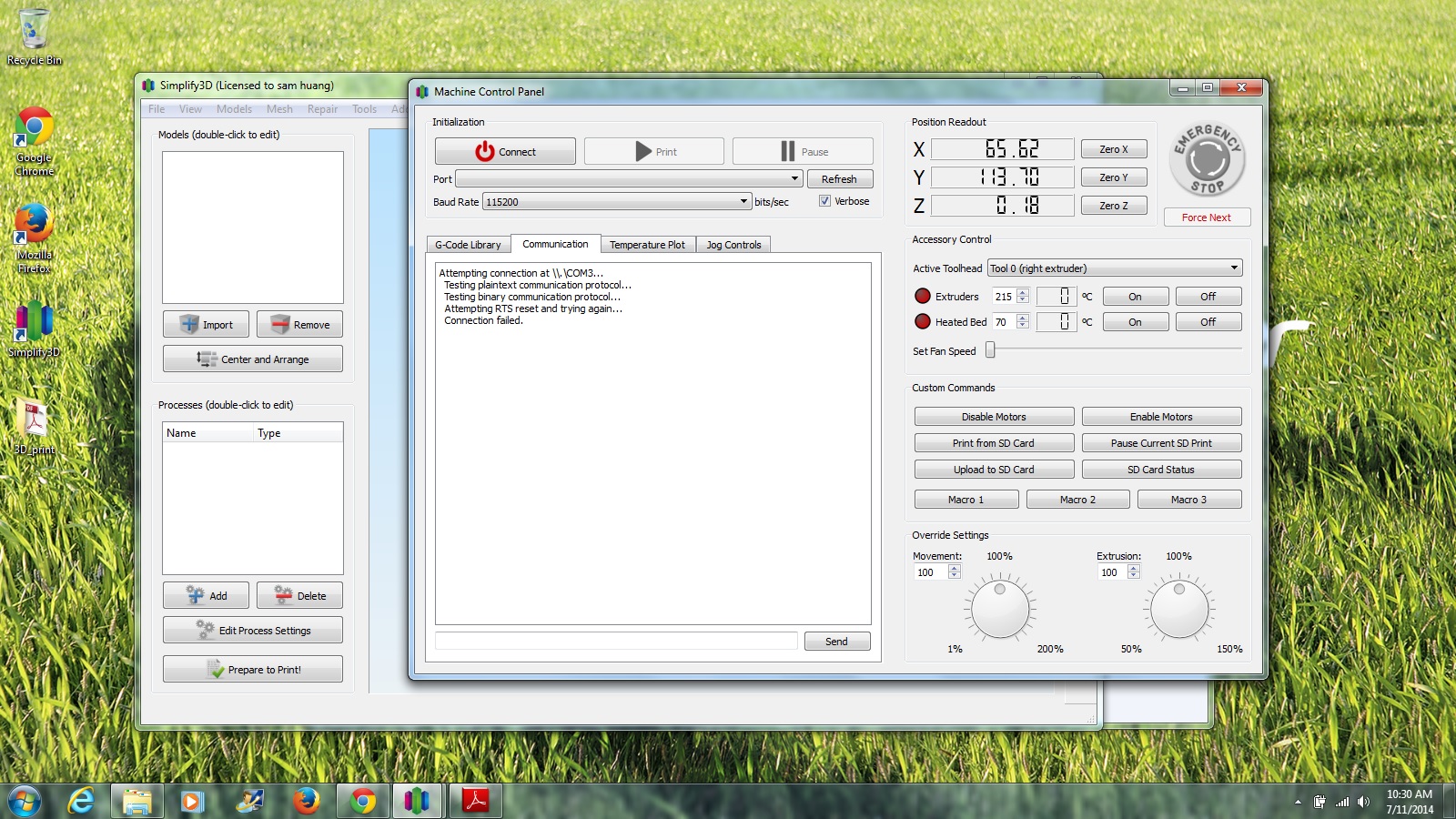

Yesterday I printed from an SD Card for the first time. Today, when I attempt to connect to the computer via USB, the program reads, (see attachment). Any help would be greatly appreciated. Thanks.

Select the proper port (it's empty).
Re: Printer can't connect to computer (simplify3D)
I've noticed it does that occasionally if I plug in the printer after I have started S3D. If selecting the port doesn't do it, I just restart S3d with the printer plugged in.

Also, make sure you have the correct port selected. I see in your pic there is no port/device selected. I am not sure if that is normal for a PC.

You're sure it's on COM3?
Once everything is connected, hit the "Refresh" button (to the right of the Port drop-down), THEN click the drop-down to see the list of ports. That syntax with the "\\,\" before the COM3 is not "optimal" AFAIK.
