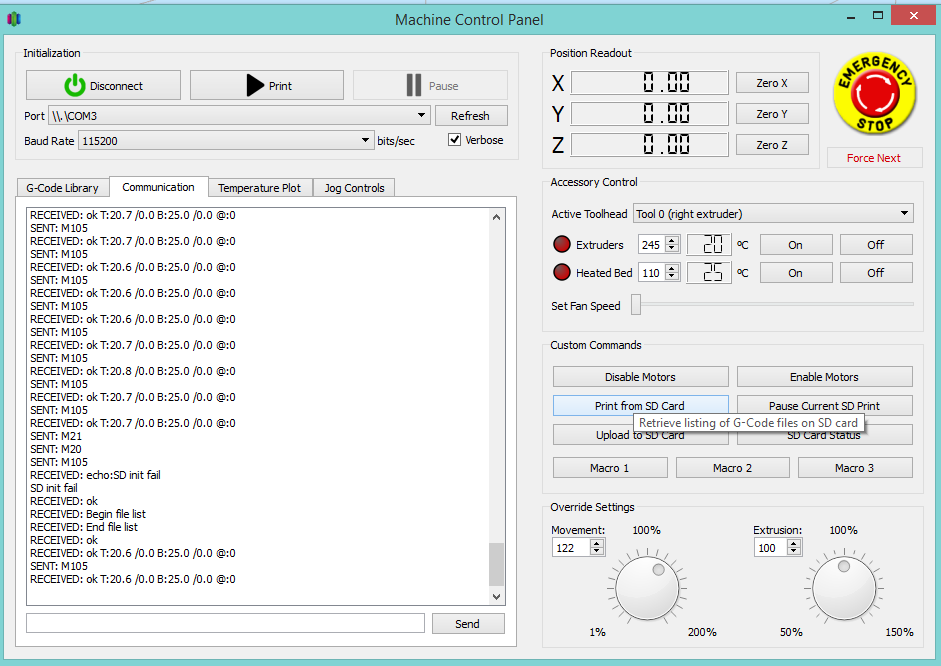

I keep getting this failure when I select "print from SD card". Does anyone know how to fix this, or what causes it?
sd card fail.png (63.25 KiB) Viewed 4760 times

The wiring harness connecting to the SD card holder was loose. It doesn't seem to hold tight when I push them together.
